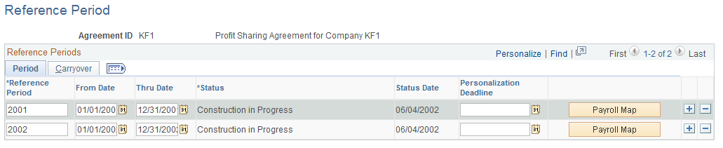

Use the Reference Period page (WP_AGRT_PERIOD) to create and approve reference periods.
Image: Reference Period page - Period tab
This example illustrates the fields and controls on the Reference Period page - Period tab. You can find definitions for the fields and controls later on this page.
Field or Control
Definition
Reference Period
Enter the reference period ID. The system populates a reference period ID that you can override.
From Date and Thru Date
Enter the period start and end dates. The system automatically populates these dates based on the agreement approval date or the dates of existing reference periods. You can override these default dates.
If you haven't created reference periods for the agreement, the system populates the date fields for the year previous to the approval date, as follows:
  • From Date is set to January 1 of the year before the agreement approval date.
  • Thru Date is set to December 31 of the year before the agreement approval date.
The agreement approval date is defined on the Agreement page.
If there are existing reference periods, the system populates the date fields starting the new reference period immediately after the end of the latest period with the same duration as the existing period.
Status
When you add the period initially, the system sets the status to Construction in progress and changes it to Computed when you run the Process Interest and Payment Application Engine process (HR_WP_PAYMT).
After reviewing the profit sharing amounts calculated by the process, change the status to Approved. Once you set the status to Approved, you can't make other changes to the reference period.
Note: Employees can view their fund information only when the reference period status is Approved.
Personalization Deadline
Enter the last date on which employees can change the investment method or interest reinvestment options using the Agreement Personalization component or the self-service transactions. After this date, employees cannot change these agreement settings and funds can be transferred to the financial organization specified or paid through your payroll system.
If employees receive a payment or a transfer is completed before the personalization deadline, the system doesn't allow employees to update their agreement settings from this payment or transfer date.
Note: If you don't define a date, the system automatically prevents employees updating their agreement settings once the first reference period is approved.
Payroll Map
Click this button to define the location of payroll information. Profit sharing calculations depend on data imported from your payroll system.

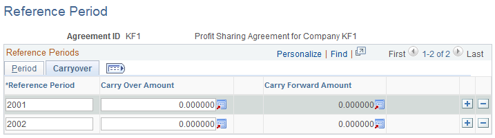

Image: Reference Period page - Carryover tab
This example illustrates the fields and controls on the Reference Period page - Carryover tab. You can find definitions for the fields and controls later on this page.
Field or Control
Definition
Carry Over Amount
This field shows the amount carried over from the previous reference period. The Compute Global Fund process adds this amount to the global fund calculated.
Carry Forward Amount
This field is for profit-sharing agreement types only. It shows the surplus amount that will be added to the global fund for the next reference period. This is calculated by the Distribute Global Funds process if you selected the Carryover option on the Investment page.

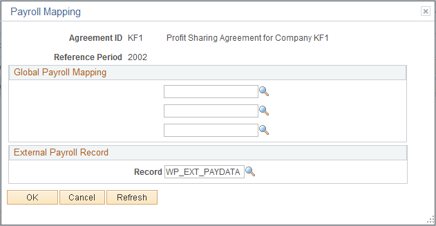

Use the Payroll Mapping page (WP_AGRT_PERIOD_SEC) to define payroll data required by the profit sharing calculations.
Image: Payroll Mapping page
This example illustrates the fields and controls on the Payroll Mapping page. You can find definitions for the fields and controls later on this page.
Use this page to define the location of payroll information that is required for profit sharing. If you make changes to this page after running the Extract Eligible Employees process, you must rerun the process to take account of the modifications. You can't make changes to this page once the reference period status is Approved.
Note: If your organization uses Global Payroll for France and other payroll systems, define both Global Payroll Mapping and External Payroll Mapping. If you define both group boxes, the system uses the Payroll System field in the employee's job data to determine which source to use for the import.
The system displays this group box if you have Global Payroll for France installed.
Field or Control
Definition
Gross Salary Accumulator
Select the accumulator defined in Global Payroll for France that stores employees' gross salary. PeopleSoft provide the following accumulators as standard:
PAR AC SAL PART SG for profit-sharing agreements.
PAR AC SAL INT SG for worker's participation agreements.
These accumulators store employees' gross salary during the reference period. This includes paid absences and some unpaid absences, such as maternity leave. The employees' gross salary is used by the Distribute Global Funds process to calculate employees' funds.
Working Days Accumulator
Select the accumulator defined in Global Payroll for France that track employees' working days in a reference period. PeopleSoft provide the following accumulators as standard:
PAR AC PRE PART SG for profit-sharing agreements.
PAR AC PRE INT SG for worker's participation agreements.
These accumulators store employees' working days, including paid absences and some unpaid absences, such as maternity leave. This is used by the Distribute Global Funds process to calculate employees' profit-sharing amount.
Payment Earning
Select the earning defined in Global Payroll for France for the payment of profit-sharing or worker's participation amounts. This earning is generated during payment processing. PeopleSoft delivers the following earnings as standard:
INTERESSEMEN for profit-sharing agreements.
PARTICIPATIO for worker's participation agreements.
If you use an external payroll system for some employees you must populate a record with payroll information required for the profit-sharing calculations.
Field or Control
Definition
Record Name
Select the record that stores your payroll information. PeopleSoft delivers the PS_WP_EXT_PAYDATA record that has the correct structure. If you use a different record make sure that the record has the same field names, types, and length as those defined in PS_WP_EXT_PAYDATA.
