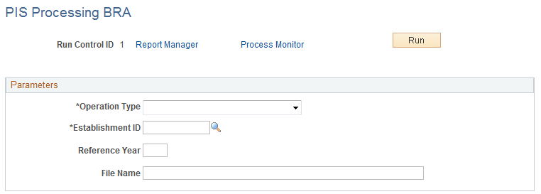

Use the PIS Processing BRA page (GPBR_RC_PIS_PRO) to run the PIS Processing Application Engine (GPBR_PISP_AE) process.
Navigation
Image: PIS Processing BRA page
This example illustrates the fields and controls on the PIS Processing BRA page.
Field or Control |
Definition |
| Operation Type |
Select the process to run:
| Establishment ID |
Select the establishment. You can only select from those establishments that have been identified as centralized on the Centralization Data page. |
| Reference Year |
Enter the year from which PIS payment can be made. |
| Payment Month |
This field appears when you select the payment or reversal process in the Operation Type field. Enter the month to which the element assignment instructions apply. |
| Reversal Report |
This field appears when you select the reversal process in the Operation Type field. |
| File Name |
Enter the complete path to the file. |
