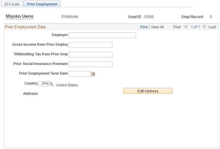

Use the Prior Employment page (GPJP_YEA_PYEPRI) to enter prior employment data, such as income, tax, social insurance premium, and the prior employer's name and address.
Navigation
Image: Prior Employment page
This example illustrates the fields and controls on the Prior Employment page. You can find definitions for the fields and controls later on this page.
Use this page to enter earning and deduction data from previous employers.
