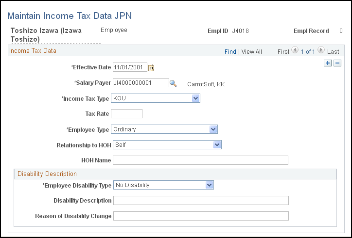

Use the Maintain Income Tax Data JPN page (GPJP_IT_PYE_TAX) to enter employee income tax data, such as salary payer number, employee type, and disability information.
Navigation
Image: Maintain Income Tax Data JPN page
This example illustrates the fields and controls on the Maintain Income Tax Data JPN page. You can find definitions for the fields and controls later on this page.
Field or Control |
Definition |
| Income Tax Type |
Select from the following values: Designated Rate, KOU, and OTSU. For employees with multiple jobs, KOU can be selected only once across all employment records. Otherwise, the system generates an error message. As the system doesn't allow multiple employment records with tax type KOU at the same time, you have to update the current KOU record to a non-KOU value and then update the non-KOU record to KOU. If the employee type is not KOU, the employee can't update this dependent data on the self-service pages. |
| Tax Rate |
Enter a value here only if you select Designated Rate for the income tax type. For example, enter 0.2 if the designated tax rate is 20 percent. |
| Relationship to HOH (relationship to head of household) |
Select the relationship of the employee to the head of the household. If the employee is the head of household, select Self. |
| HOH Name (head of household's name) |
If the employee is not the head of the household, enter the name of the person who is. |
Disability Information
Enter or edit disability information that is provided by employees on the Dependent Deduction report.

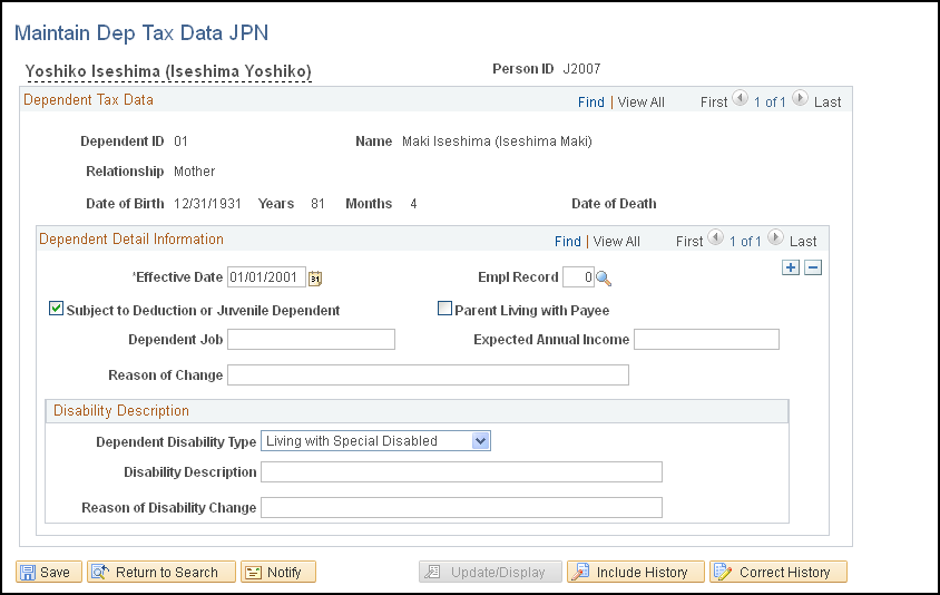

Use the Maintain Dep Tax Data JPN page (GPJP_IT_DEP_TAX) to enter dependent tax data.
Navigation
Image: Maintain Dep Tax Data JPN page
This example illustrates the fields and controls on the Maintain Dep Tax Data JPN page. You can find definitions for the fields and controls later on this page.
The selections you make on this page determine the personal exemptions for income tax during year-end processing, as well as for withholding income tax. The application determines the exemptions based on the dependent's birth date and relationship to the payee.

Dependent Detail Information
You must link the dependent tax data with an employment record number. If the employee has multiple jobs, the employment record number that is linked to the tax type KOU on the Maintain Income Tax Data JPN page defaults to the Empl Rcd Nbr field. If no employment record number is linked to tax type KOU, zero is defaulted.
Note: If the relationship of the dependent is changed to ExSpouse in HR, you should deselect the Subject to Deduction check box on this page.
Note: For a newborn child, enter the child’s birth date in the Effective Date field. This ensures that the system calculates taxes properly for the year in which the child was born.
Disability Description
Deleting Dependent Tax Data
If dependent tax data exists on this page, it will be orphaned if the dependent data is deleted from the Dependent Information page, unless service operation DEPBEN_SYNC is enabled.
