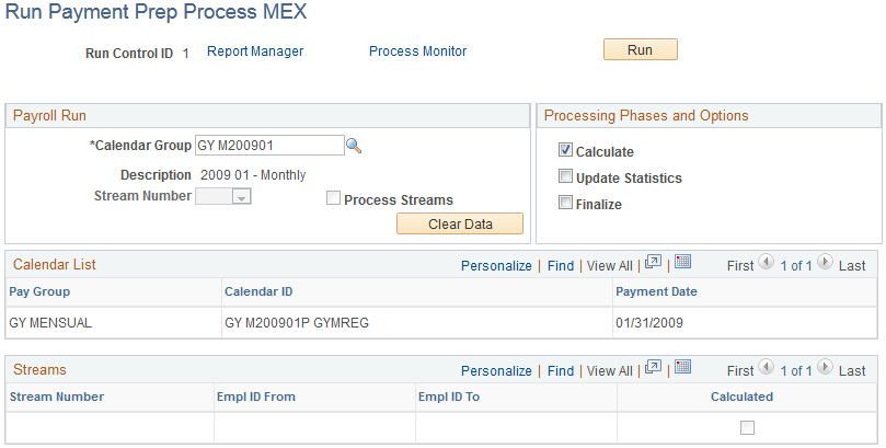

Use the Run Payment Prep Process MEX page (GPMX_BANK_POPULATE) to launch the processes that populate the GP_PAYMENT and GPMX_PAYMENT records.
Image: Run Payment Prep Process MEX page
This example illustrates the fields and controls on the Run Payment Prep Process MEX page. You can find definitions for the fields and controls later on this page.
Note: The fields on the Payment Preparation MEX page are the same as the Run Payment Prep Process page in the core application, except that there is an additional button (Clear Data) on the Payment Preparation MEX page. For more information about the Run Payment Prep Process page in the core application, refer to theRun Payment Prep Process Page topic.
Field or Control
Definition
Clear Data
Select when you want to recalculate the Mexican banking process. If you select Clear Data, you can clear the GPMX_PAYMENT output table and fill it again if there are any changes to the calculation.
