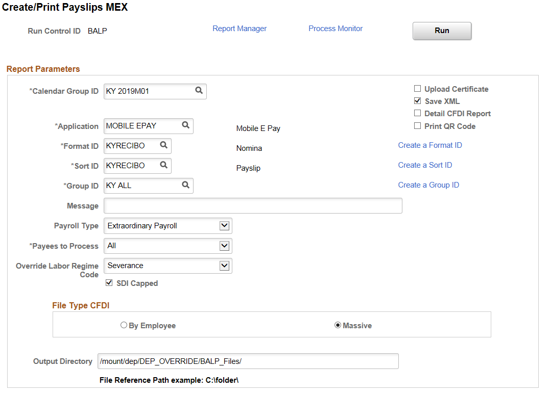

Create/Print Payslips MEX Page
GPMX_RC_PAYSLIP
Generates the payslip. Note that you must first define the Group ID to generate the payslip. All groups selected in the Group ID field will automatically be created during the payroll run.
Use the Create/Print Payslips MEX page (GPMX_RC_PAYSLIP) to run the Printed Payslip Job PSJob process. This job runs the Payslip Preparation process, followed by the Printed Payslip SQR report , and the Create Self Service Payslip process (GP_EPAY). You must set up payslips on the payslip definition pages before running the payslip processes. Also check the configuration elements in Legal Code Payslip MEX page.
When you run the report, the system creates an XML file and stores it in the server. A user can view the XML file in their browser, create a PDF file from the XML and then print it.
Image: Create/Print Payslips MEX Page
This example illustrates the fields and controls on the Create/Print Payslips MEX page.
Field or Control
Definition
Calendar Group ID
Select the calendar group for which you want to load payslip result data.
Format ID
Select the Format ID. This value is defined on the Element Lists MEX page and defines the elements listed in the Payslip.
Sort ID
Select the Sort ID. This value is defined on the Sort IDs MEX page.
Group ID
Enter the criteria that you want to use to select employees.
Message
The text you enter here will be printed in the Payslip
Payroll Type
Identifies the payroll type that will be generated. Select the payroll as ordinary payroll or extraordinary payroll.
Payees to Process
Select the payees to process. Valid Values are:
  • All: If you select this option, system generates the CFDI for all the employees (with and without error) that belong to Calendar Group ID.
  • Error: If you select this option, system generates only the CFDI for the employees that was marked on error in a previous process. If the process has not been run before and this option is selected, the process won’t generate any CFDI.
Override Labor Regime Code
Select the option as ‘Severence’ to override the Labor Regime Code for terminated employees.
Note: The Override Labor Regime Code will be validated if Extraordinary Payroll has been select in Payroll Type.
SDI Capped
Select this check box if the SDI capped information needs to be printed in the Payslip. By default, it is selected.
Upload Certificate
Select the check box while you upload the certified file. The File Reference path will be the path where the XMLs from the PAC of the corresponding calendar group were placed.
Save XML
Select the check box to create the XML to send to the PAC. The files are created in the server path defined in the run control page.
Detail CFDI Report
Select this check box to if the element’s information needs to be printed in the CFDI Report MEX.
Print QR Code
Select this check box to print QR code.
Create a Format ID
Click the link to access the Element Lists MEX page.
Create a Sort ID
Click the link to access the Sort IDs MEX page.
Create a Group ID
Click the link to create a Group ID.
File Type CFDI
Identifies the file type that will be generated. Valid values are:
  • By Employee: Refers to generate a file for each employee processed in the payroll.
  • Massive: Refers to generate one file with all employees processed in the payroll having a cut employee.
Output Directory
Specify the directory where generated XML files are stored. XML output (in the form of file) is generated and stored in the specified file output directory.
Click the Run button to run the payslip process.
Note: Provide a valid file path where the CFDIs (information provided by the PAC) belong to the selected calendar. If there is a mismatch in between the XMLs and the selected Calendar Group the information will be replaced by the last processed file by XML Application Engine which uploaded the Certificate.

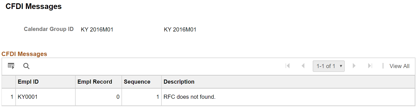

Use the Payee Message CFDI MEX Page to validate the data issues generated for the employees while processing Regular Payroll and the CFDI process. Using this data, the user can correct the errors and regenerate the XML for SAT.
Note: This page shows only the calendar which has been processed after by Create/Print Payslips MEX and with issues detected.
Image: Payee Message CFDI MEX Page
This example illustrates the Payee Message CFDI MEX Page.
Field or Control
Definition
Calendar Group ID
Select the calendar group ID for which you want to validate the issues.
Empl ID
Shows the employee ID for which data issues are reported.
Empl Record
Shows the employee record number of the employee to process in CFDI.
Sequence
Establishing the sequence based on the employee errors.
Description
Review the messages that are generated during the CFDI process.
