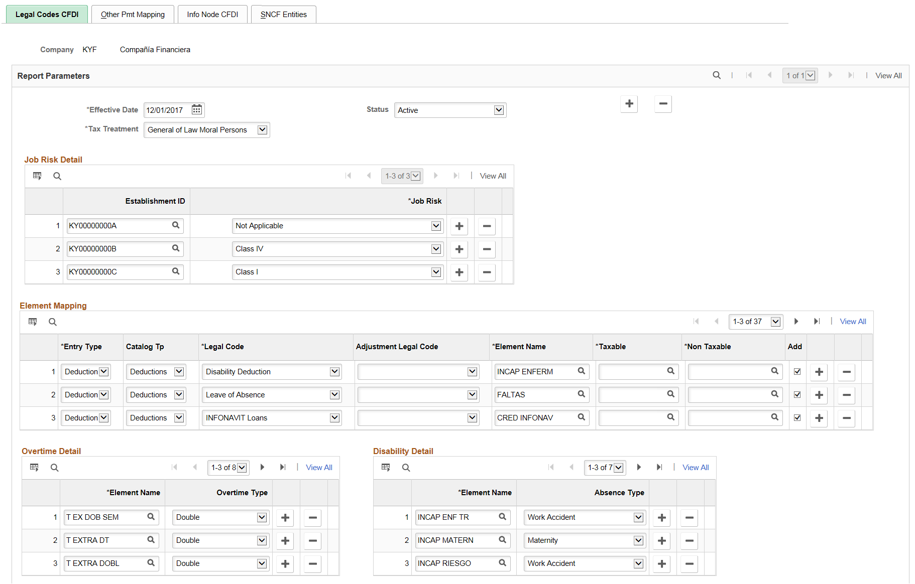

Use the Legal Codes CFDI page (GPMX_LEGAL_CODE) to define the CFDI report parameters and to map elements.
Image: Legal Codes CFDI Page
This example illustrates the fields and controls on the Legal Codes CFDI page.
Field or Control
Definition
Company
The Company for which the Legal Code Payslip setup is defined.
Effective Date
Date from which the setup is applicable.
Status
Defines whether or not the setup is valid. The default value for this field is Active. Values ​​are:
  • Active.
  • Inactive
Tax Treatment
Text provided by SAT to identify the class of Tax regime.
Field or Control
Definition
Job Risk Detail
Establishment ID
The Establishment Id where the employee's job risk is determined by the establishment that is associated with the employee's location.
Job Risk
The code to identify the Employer’s classification based on the activities performed by the employees. Valid values are:
  • Class I
  • Class II
  • Class III
  • Class IV
  • Class V
  • Not Applicable
Note: ‘Not Applicable’ option is available only if you use/add an effective date > = 08/13/2017.
Field or Control
Definition
Element Mapping
Entry Type
Select the type of element to include in the report. Values are:
  • Earnings
  • Deductions
Catalog Type
Select the catalog type to which the Legal Code belongs. Values are:
  • Earnings
  • Deductions
Note: There are discrepancies for some element types between SAT and GP Mexico. For example, ‘Employee Subsidy’ is treated as an earnings for the SAT while in GP Mexico ‘Employee Subsidy’ is reported as a deduction.
Legal Code
Legal code is the SAT catalog to report earnings and deductions. System displays the options based on the selected Catalog Type,
If the catalog type is selected as deduction then the deductions catalog is displayed otherwise it displays the earnings catalog.
Adjustment Legal Code
Contains the Adjustment codes defined by SAT to be used to report Adjustments.
Adjustments are triggered when a negative value is found in payroll results, its value changes to positive and is stored in an element including original element’s name.
Element Name
Enter the name of the earnings or deductions element to include in the CFDI report. System displays the options based on the selected Entry Type. If the entry type is selected as deduction then the deductions catalog is displayed otherwise it displays the earnings catalog.
Note: If the Taxable and Non taxable are empty, the amount of this element will be printed as 100% taxable. The description of this element will be printed in the report.
Taxable
The element that contains the Taxable Base for the corresponding element. System displays the options based on the selected Entry Type. If the entry type is selected as deduction, then the deductions catalog is displayed otherwise it displays the earnings catalog.
Note: The description printed in CFDI file takes the description's Element name. If you just enter an Element in this field (Non taxable are empty), the amount of this element will be printed as 100% taxable. This element could be equal to Element Name.
Non Taxable
The element that reports the Non-Taxable Base for the corresponding element. System displays the options based on the selected Entry Type. If the entry type is selected as deduction then the deductions catalog is displayed otherwise it displays the earnings catalog.
Note: If just enter an Element in this field (Taxable are empty), the amount of this element will be printed as 100% non-taxable. This element could be equal to Element Name.
Add
This field defines when an element sum or not sum to Total Earnings or Total Deductions depends on the Entry Type, however always must to print in the CFDI report.
  • If the check box is selected, it means the amount must to sum to the Total.
  • If the check box is not selected, it means the amount must to NOT sum to the Total.
Note: By default the check box is selected.
Field or Control
Definition
Overtime Detail
Element Name
Enter the name of Overtime element. If this section is populated then the information must to print in Overtime node on CFDI report. Valid values: All earnings.
Overtime Type
Defines the overtime type. Valid Values are:
  • Double
  • Triple
Field or Control
Definition
Disability Detail
Element Name
Enter the name of Disability element. If this section is populated then the information must to print in Disability node on CFDI report. Valid values: All deductions
Absence Type
Identifies the Absence Type. Valid values are:
  • Sickness
  • Maternity
  • Work Accident
Note: Selection of correct options in Legal Code Mex page will ensure that the correct value are send to SAT.

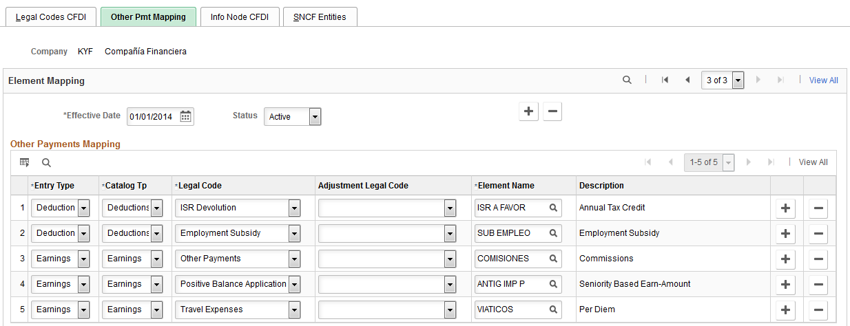

Use the Other Pmt Mapping page to map the payment elements.
Image: Other Pmt Mapping page
This example illustrates the Other Pmt Mapping page.
Other Pmt Mapping
Field or Control
Definition
Entry Type
Select the element type. Valid values are:
  • Earnings
  • Deductions
Catalog Tp
Select the catalog type to which the Legal Code belongs to.
Legal Code
Select the legal code defined by SAT.
The Adjustment codes defined by SAT to be used to report Adjustments.
Element Name
Name of the element. The value will be reported with the selected Legal Code.

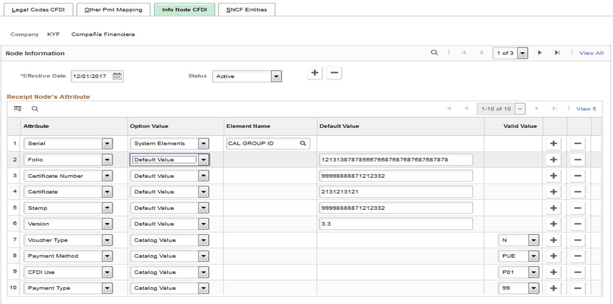

Use the Info Node CFDI page (GPMX_INFO_NODE_CFD) to define receipt node’s attributes.
Image: Info Node CFDI Page
This example illustrates the fields and controls on the Info Node CFDI page.
Info Node CFDI page
Field or Control
Definition
Company
The Company to which the Info Node CFDI setup will apply to.
Effective Date
Date in which the setup takes effect.
Status
Attribute
Select the attribute from the following:
  • Serial
  • Folio
  • Certificate Number
  • Certificate
  • Stamp
  • Voucher Type
  • Payment Method
  • CFDI Use
  • Payment Type
Option Value
Select the option value to be printed in the XML from the following:
  • Default Value: If you select this, you can enter a default value.
  • System Elements: If you select this, the attribute’s value will be printed according the value of the selected element.
  • Do not Print: If you select this the attribute will not be printed.
  • Sequence: If you select this, the attribute’s value will be printed as consecutive number, with format 9999999999.
  • Catalog Value: If you select this, the attribute’s value will be printed according the Valid Value selected.
Element Name
Select the system element. This field is displayed only if you select ‘System Elements’ in the Option Value field.
Default Value
Enter the default value to be displayed in the XML file. This field is enabled only if you select ‘Default Value’ in the Option Value field.
Valid Value
Select the Valid Value. Displays the values according the Attribute selected.
Note: This field is displayed only when Catalog Value is selected in the Option Value field.
Note: If this step is skipped then the attributes will not be printed in XML File.

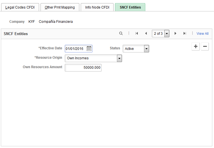

Use the SNCF Entities page to define the SNCF Entities.
Image: SNCF Entities Page
This example illustrates the fields and controls on the SNCF Entities page.
SNCF Entities page
Field or Control
Definition
Effective Date
Date used to define the effectiveness of the data being entered.
Resource Origin
Defines the source of funds used to pay the payroll, this data applies only for government entities: Federal Incomes, Mixed Incomes, Own Resources Amount.
  • Own Incomes: Used to define the amount of own incomes when Resource Origin selection value is Mixed Incomes.
  • Federal Incomes: These are the Revenue paid by federal entities, municipalities or territorial demarcations of the Federal District, autonomous agencies and local and municipal entities with federal resources, other than the participations.
  • Mixed Incomes: These are the Revenue paid by federal entities, municipalities or territorial demarcations of the Federal District, autonomous agencies and local and municipal entities charged to their participation or other local income and with federal resources other than the participations.
Revenue paid by federal entities, municipalities or territorial demarcations of the Federal District, autonomous agencies and local and municipal entities charged to their interests or other local income.
