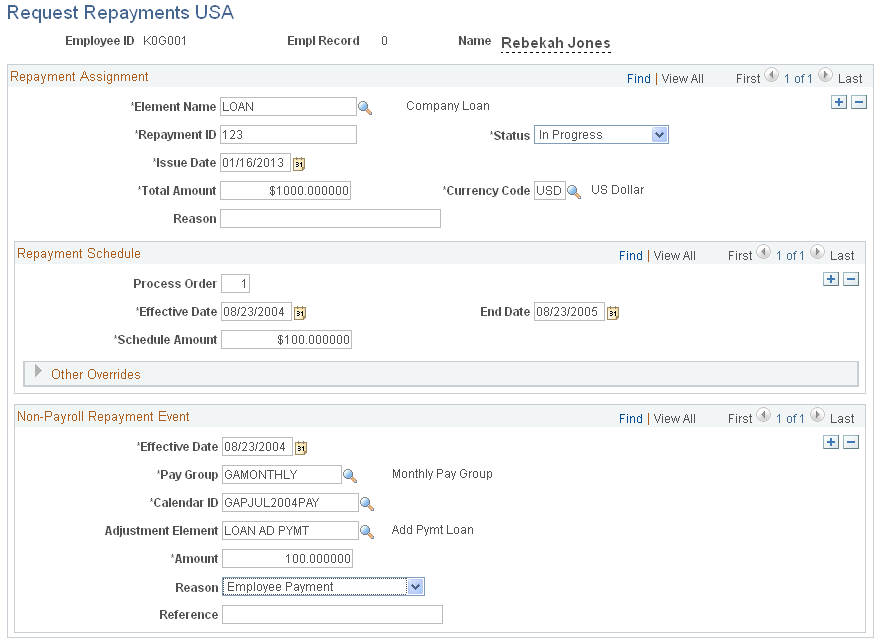

Use the Request Repayments USA page (GPUS_LOAN_PYE) to define repayment deductions.
Image: Request Repayments USA page
This example illustrates the fields and controls on the Request Repayments USA page.
Field or Control
Definition
Employee ID and Name
Displays the ID and name of the payee to whom you are assigning the repayment.
Repayment Assignment
Use the fields in the Repayment Assignment group box to define unique instances of a repayment deduction and to define the total repayment amount.
Field or Control
Definition
Element Name
Enter the name of the repayment deduction that you want to assign to the payee.
You can use the delivered repayment deduction (LOAN), or a deduction that you have created.
Note: The prompt table displays only deductions with an element category of LNS.
See Defining Industries and Categories.
Repayment ID
Enter a repayment ID.
The ID must be unique for each repayment.
Note: A single payee can have multiple repayments; the system uses the repayment ID to track repayments separately.
Issue Date
Enter the date on which the repayment was issued.
This field is for information only. It does not affect processing.
Total Amount
Enter the total amount of the repayment.
This is the amount to be repaid in increments based on the pay period frequency.
Note: The LOAN deduction is defined with a frequency of Use Calendar Period Frequency. This means that the amount you enter in the Schedule Amount field (defined below) is deducted each pay period, regardless of the pay period frequency (weekly, biweekly, monthly, and so on).
Reason
Enter the reason for the repayment.
Status
Specify the current status of the repayment.
Values are:
  • In Progress
    Used for repayments that are in the process of being repaid.
  • Cancelled
    A repayment is canceled when it has been repaid, forgiven, or canceled.
    Note: This is for information only. To stop or cancel a loan, you must enter a loan end date.
Currency Code
Specify the currency of the loan deduction.
Repayment Schedule
Use the fields in the Repayment Schedule group box to define the amount to be repaid each pay period.
Field or Control
Definition
Effective Date
Enter an effective date.
This date determines when the repayment schedule becomes effective.
Note: You can define different effective-dated schedules for the same repayment by entering additional rows of data.
Schedule Amount
Enter the amount to deduct each pay period.
Note: Use the fields in the Repayment Schedule group box to define a standard repayment schedule. If you want to define a one-time override to the scheduled repayment amount, enter the override amount using positive input.
End Date
Enter a date after which the repayment deduction should no longer be processed.
Other Overrides
Use the fields in this group box to override values associated with the selected repayment deduction element on the Deduction Name page.
See Understanding Calculation Elements, Defining Element Names.
Non-Payroll Repayment Event
Use the fields in the Non-Payroll Repayment Event group box to record additional, non-payroll repayments made by a payee. These are deductions that are not included in the regular schedule of repayments and that do not reduce the amount of net pay.
Note: Do not use the fields in the Non-Payroll Repayment Event group box to deduct additional, one-time repayments through the regular gross to net process. If you want to define an additional, one-time repayment to be included in the regular gross to net process, create a positive input entry for the repayment deduction with an action type of Additional.
