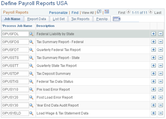

Use the Define Payroll Reports USA page (GPUS_RPT_SETUP) to define parameters used by the payroll report jobs.
Image: Define Payroll Reports USA page
This example illustrates the fields and controls on the Define Payroll Reports USA page.
Job Name
Field or Control
Definition
Process Job Name
Enter the job name for the report.
