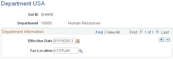

Use the Department USA page (GPUS_DEPT) to assign tax location codes to departments.
Image: Department USA page
This example illustrates the fields and controls on the Department USA page.
Department USA page
Field or Control
Definition
Tax Location
Enter a tax location code for the department. Newly hired payees from this department automatically have this tax location associated with their tax profile if the Populate Payee Tax Data check box is selected on the Installation Table USA page. In addition, if you enter a new location for a department on this page, the system creates a new tax profile row for payees associated with the department.
Note: For default tax location to be provided, Integration Broker must be set up, and Workforce_Sync and GPUS_JobSync must be active.
