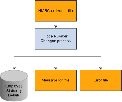

Image: Code Number Changes process
The following diagram illustrates the Code Number Changes process:
Use the message log file and the error file to review the results and resolve issues with the data. To simplify this process, you make corrections in the error file and not in the original HMRC-delivered file.
The error file format meets HMRC format requirements which enables you to use the corrected error file as input if you need to rerun the process.

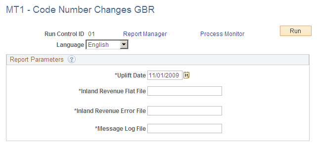

Use the MT1 - Code Number Changes GBR page (GPGB_RUNCTL_CNC) to run the Code Number Changes process.
Image: MT1 - Code Number Changes GBR page
This example illustrates the fields and controls on the MT1 - Code Number Changes GBR page.
Field or Control
Definition
Uplift Date
The effective date of the new rows that are inserted into the tax table (that you can view using the Maintain Tax Data GBR page). Global Payroll for the UK uses employees' new tax codes in tax calculations from this date.
Inland Revenue Flat File
Enter the name of the file you copied from the HMRC tape.
Note: This file must be in the %PS_SERVDIR%\files directory before you can run the Code Number Change process.
Inland Revenue Error File
Enter the name for the error log file.
Message Log File
Enter the name for the process log file.

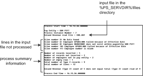

Reviewing the Message Log File
Image: Example Code Number Changes process log file
This is an example of a message log file created by the Code Number Changes process:
Note: This topic refers to the "input file". This is the file you specified in the Inland Revenue Flat File field. If this is the first time you've run the process, the input file is the HMRC-delivered file. If you're rerunning the process, the input file is the corrected error file that contains unprocessed employees only. See the Reviewing the Results and Rerunning the Process topic for more information.
The message log file lists:
  • The lines in the input file that weren't processed.
  • Process summary information.
This table lists the summary information provided and what you should expect to see if the process has run successfully:
Summary Data
Description
Expected Value
Number of records inserted
Number of records inserted into the tax table
If there are no errors in the data, this number should equal the Total Number of Type 2 Records.
Number of records not inserted
Number of records that can't be updated because of effective date conflicts.
Zero
Number of employees not in pay entity
The lines in the input file with an emplID that isn't in the pay entity.
Zero. If this value is not zero, the input file includes employee IDs that are either not valid or are included in a different pay entity.
Number of empty rows
Number of blank lines in the input file.
Not applicable. Blank lines are not processed.
Total number of Type 2 records
Total number of employee records in the input file. This excludes blank lines.
This number should match the Number of records inserted.
Total number of lines
Total lines in the input file, including employee data, blank lines, and the header and footer information.
Not applicable.
For every line in the input file that is not processed, the message log file lists the:
  • Line number
  • Error message
This table lists the error messages and the reason for the errors:
Error Message
Reason
No Data found
A blank line in the input file. This doesn't stop the process completing successfully.
Employee emplID failed because of Effective Date
The employee specified has an existing row in the tax table with an effective date that conflicts with the uplift date.
See MT1 - Code Number Changes GBR Page.
Employee emplID does not exist within pay entity entity_name
The emplID specified is not in the pay entity being processed. Check whether it is a valid emplID.
Employee number is blank
The emplID is missing from the line. Check whether this is a valid employee for the pay entity being processed. If it is a valid employee, you need to add the emplID to the data in the error file.

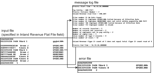

Investigating Errors
Image: Example of the files created by the Code Number Change process
The Code Number Changes process copies the lines of data that it could not process to the error file that you specified, as shown in this diagram:
To investigate an error you can look at the input file or the error file. If this is the first time you've run the process, the input file is the HMRC-delivered file which contains all your employees. It is easier to search the error file which contains unprocessed data only. However, remember that the line number in the log file refers to the input file.
Do not update the HMRC-delivered file. Only update the data in the error file because this is the file you use to rerun the process.
