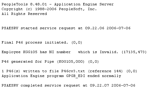

Image: Example EDI View Log/Trace
Here is an example of a log if you use the View Log/Trace link and redirect the output to the terminal:
If there are any warnings or errors, see Resolving Errors and Warnings for more information about the problem and how to fix it.

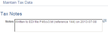

Use the Maintain Tax Data GBR page (GPGB_EE_TAX) to review any notes added to the employee's tax data by EDI transactions.
Image: Maintain Tax Data - Tax Notes page
This example illustrates the fields and controls on the Maintain Tax Data - Tax Notes page.
You can view notes from P45 Part 3 (starters) and P46 transactions on the Tax Notes page. You can also view updated or inserted rows from P6 or P9 transactions.
