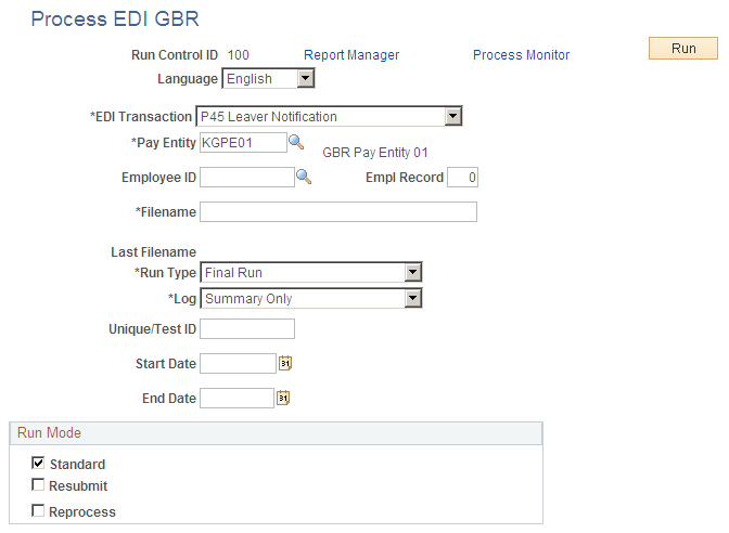

Use the Process EDI GBR page (GPGB_RNCTL_EDI) to process EDI transactions.
Navigation
Image: Process EDI GBR page
This example illustrates the fields and controls on the Process EDI GBR page.
Field or Control |
Definition |
| EDI Transaction |
Select the type of EDI transaction to process. Options are:
For more information see the transaction descriptions in this topic. Note: The fields that appear on this page depend on the type of EDI transaction you select. |
| Pay Entity |
Select the pay entity for which to run the EDI transaction. |
| Employee ID and Empl Rcd Nbr (employee record number) |
Select a specific employee ID and Empl Rcd Nbr to restrict the transaction to that employee's details. This field is only available for P45, P46, and P14 transactions. |
| Filename |
For incoming transactions, enter the filename of the file to load. For outgoing transactions, enter the name of the file to be created. If you enter an asterisk (*) as part of the file name, the system automatically generates a unique filename by replacing the asterisk with an incrementing number. For example, if you enter EDIWNU*.TXT as the file name, the process names the first WNU file generated EDIWNU1.TXT, the second EDIWNU2.TXT, and so on. |
| Last Filename |
Displays the last filename created or loaded. |
| Run Type |
Select the mode to run the process in: Trial Run: Use this mode to review flat file information and identify any problems updating the database or creating flat files to send to HMRC. For outgoing transactions, running the process in this mode creates a flat file with the test flag set. For incoming transactions, running the process in this mode identifies the updates that would occur, without updating the database. Final Run: Use this mode to update the database or create flat files to send to HMRC. For outgoing transactions, final runs create flat files without the test flag and update the EDI audit tables (if you chose to generate EDI audit tables during setup). A unique transaction number is also allocated. For incoming transactions, final runs update the database and update the EDI audit tables (if you chose to generate EDI audit tables during setup). |
| Log |
Select the level of information recorded about a transaction in the process log file. The options are: Summary Only, Detail - All, Detail – Warnings and Errors, and Detail – Errors Only. Note: If you select the Use EDI Audit check box on the EDI Setup GBR page, the audit tables contain all information regardless of the log type you select here. |
| Unique/Test ID |
This field is available for P14, and P35 transactions only. For a P14 transaction, enter the unique ID required by HMRC. This identifier is chosen by the sender and is quoted when HMRC sends the P14 acknowledgement. The unique ID replaces the permit number previously issued for each PAYE scheme. For trial submissions (Run Type set to Trial), the system automatically prefixes the unique ID withTEST. For a P35 transaction, enter a test ID that is required for trial submissions. Leave this field blank for a final run. |
| Tax Year Begins In |
Enter the year in which the tax year begins. This field is available for P14 and P35 transactions only. |
| Num of P14 submissions sent |
Enter the number of P14 transactions submitted for the PAYE scheme for the tax year. This field is required for P35 transactions only. For example, if you submitted one P14 transaction for 40,000 employees, enter 1 in this field. |
| Start Date and End Date |
Enter a start and end date for the EDI processing. The use and impact of these fields depends on the EDI transaction. See the individual transaction descriptions below for more information. |
Return Type
This group box appears if you select P14 or P35 in the EDI Transaction field.
Field or Control |
Definition |
| Original Return |
Select if you are submitting the P14 or P35 transaction for the first time. |
| Amended Return |
Select if you are resubmitting a P14 or P35 transaction. |
Run Mode
This group box appears if you select the P45 Leaver Information in the EDI Transaction field. This field further defines the employees selected.
Field or Control |
Definition |
| Standard |
Select if you are submitting employees whose P45 details have not yet been submitted via an EDI P45 leaver transaction (the EDI Submission Reference field on the Maintain Tax Data GBR page is blank). |
| Resubmit |
Select to regenerate an EDI submission based on the employees that have been previously selected in a submission. The Resubmission Details link appears when you select this check box. A previous submission number is required. Note: The employee population is the same but the detailed information reported in the submission may differ if any adjustments have been made to setup and/or result data in the interval between submissions. |
| Reprocess |
Select to reselect all employees within the date range – regardless of the value in the EDI Submission Reference field on the Maintain Tax Data GBR page. |
| Resubmission Details |
Click this link to enter the EDI submission number when you are re-submitting P45 Leaver Information transactions. |
