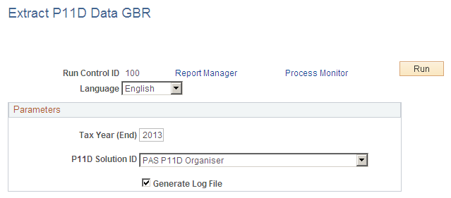

Use the Extract P11D Data GBR page (GPGB_P11D_RC) to run the Extract P11D Data process to create the CSV files.
Navigation
Image: Extract P11D Data GBR page
This example illustrates the fields and controls on the Extract P11D Data GBR page.
Field or Control |
Definition |
| Tax Year (End) |
Enter the tax year for which to run the P11D data extract process. This is the year the tax years ends. |
| P11D Solution ID |
Select the third-party P11D solution you want to use for the extraction. This defines the information that is extracted from HR tables and the output created. The Solution IDs are defined on the P11D Solution page. |
| Generate Log File |
Select this check box to generate a log file. |
