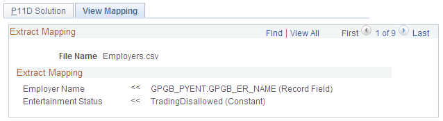

Use the View Mapping page (GPGB_P11D_SOL_VIEW) to view the mapping defined on the P11D Solution page.
Navigation
Image: View Mapping page
This example illustrates the fields and controls on the View Mapping page.
This page summarizes the mapping that you defined on the P11D Solution page. The left hand column shows the heading that appears in the CSV file created. The right hand column shows where the data comes from (a record and field name, a constant, or an App Class Method).
