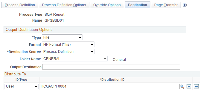

Use the Destination page (PRCSDEFNCNTDIST) to define the output destination for the P45L SQR report (GPGBP45L).
Usually this is a one-time setup that you define during implementation.
Image: Destination page
This example illustrates the fields and controls on the Destination page.
Destination page
Field or Control
Definition
Output Destination
Enter the path and filename. Enter an absolute path, such as c:\temp\p45.txt, or a relative path of the form: \\machinename\temp\p45.txt.

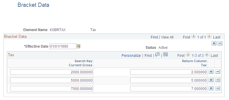

Use the Bracket Data page (GP_BRACKET_DATA) to define the values returned by the search keys (P45 parameters).
Image: Bracket Data page
This example illustrates the fields and controls on the Bracket Data page.
Bracket Data page
The variable GBR VR CONFIG has three search keys:
  • P45 JOB
    This defines the PSjob that runs when payroll administrators print P45s.
  • P45 PATH OVERRIDE
    This search key controls whether payroll administrators can select the output destination for the GPGB_P45 process.
  • P45 TAX OVERRIDE
    This search key controls whether payroll administrators can update the fields in the P45 Leaver Information group box on the Maintain Tax Data GBR page.
To set up the return values for the search keys:
  1. For the P45 JOB search key, enter one of these values in the Return Column UK Payroll Configuration field:
    GPGBP45J To run the P45 process (GPGB_P45), and both SQR reports for laser output and the PDF output.
    GPGBP45O To run the P45 process (GPGB_P45) and the SQR report for PDF output.
    GPGBP45B To run the P45 process (GPGB_P45) and the SQR report for laser output.
  2. For the P45 PATH OVERRIDE search , enter Y or N in the Return Column UK Payroll Configuration field.
    If you enter Y, the Output File Path link is displayed on the P45 page and the P45 Identification Results page, which enables the payroll administrator to specify the directory in which the output of the GPGB_P45 process is created. If you enter N, the link is not displayed and the report is printed to the default location that is specified in GPGBP45.SQC.
  3. For the P45 TAX OVERRIDE search key, enter Y or N in the Return Column UK Payroll Configuration field.
    If you enter Y, payroll administrators can update the fields in the P45 Leaver Information group box on the Maintain Tax Data GBR page, which enables them to reprint P45s by deleting the values in the fields.
    If you enter N, payroll administrators can't update these fields.
