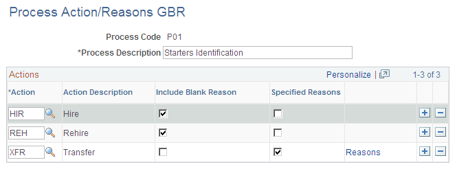

Use the Process Action/Reasons GBR page (GPGB_PRC_ACTRSN) to define the action codes that you want a process to search for in employees' job data.
Image: Process Action/Reasons GBR page
This example illustrates the fields and controls on the Process Action/Reasons GBR page.
Warning! PeopleSoft delivers system data for this page. You can add reasons and new actions, but you must not remove any of the delivered action codes. The P45 processes and the starter identification will not work correctly if the required data is removed.

Process Code
Displays the code for the process:
P45: To set up the action codes for the P45 process.
P01: To set up the action codes for identifying new starters.
See Generating P45 Reports.
See Identifying Starters, Leavers, and Transfers.
Action
Select the action code that you want the process to search for in job data. Action codes are defined in HR tables.
See Defining Personnel Actions and Reasons.
Include Blank Reason
Select this check box if you want the process to select employees with the action code specified and no reason code selected. If you deselect this check box, the process excludes employees who have no reason code (a blank field).
Specified Reasons
Select this check box if you want the process to select employees with specific reasons in their job data. Use the Reasons page to define a set of reasons. The process only selects employees whose job data have matching reason codes.
If you deselect this check box, the process returns employees whose job data includes the specified action code and any reason code.
See Understanding Process Action and Reason Codes.
Reasons
Click this link to access the Reasons page where you select the reasons that the process searches for in employees' job data. You must complete the Reasons page if you select the Specified Reasons check box.
