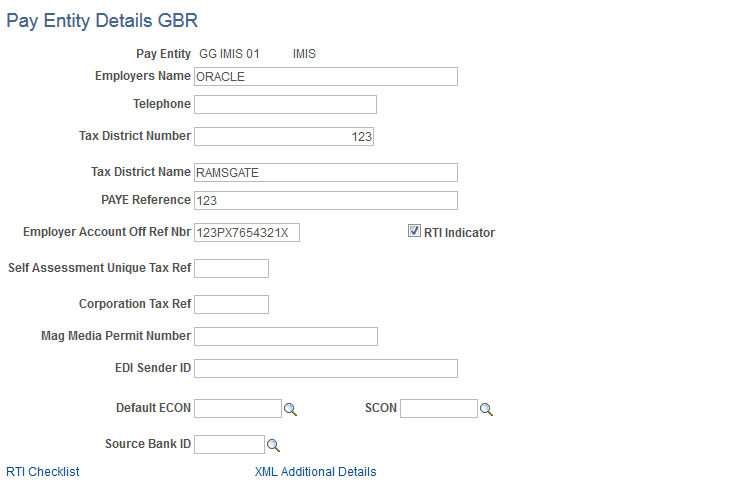

Use the Pay Entity Details GBR page (GPGB_PYENT) to set the RTI Indicator flag and enter information in the Pay Entity Details for RTI page.
Image: Pay Entity Details GBR page
This example illustrates the fields and controls on the Pay Entity Details GBR page.
Field or Control
Definition
Employer Account Off Ref Nbr (Employer Accounts Office Reference Number)
This field is mandatory for all employers using RTI. It is reported in the header of all EDI files for RTI. The Employer Accounts Office Reference Number should be provided for each PAYE reference (Pay Entity).
RTI Indicator
Select this check box to set the RTI Indicator flag.
Note: Once the employer is live on RTI, the RTI Indicator flag should always be set.
Self Assessment Unique Tax Ref
This field is optional and should only be used when the employer is a sole proprietor. Leave this field blank if a Corporation Tax Reference has been entered.
Corporation Tax Ref
This field is optional and should be used only when the employer is a limited company. Leave this field blank if a Self Assessment Unique Tax Reference has been entered.
RTI Checklist
Click this link to open the Pay Entity Details for RTI page (GPGB_PYENT_RTI).

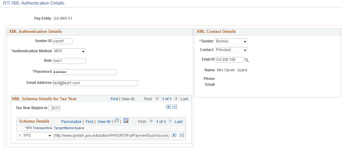

XML Additional Details
Click the XML Additional Details link to open the RTI XML Authentication Page.
Image: RTI XML Authentication Details Page
This example illustrates the fields and controls on the RTI XML Authentication page
Field or Control
Definition
Sender ID
Enter the Gateway User ID.
Authentication Method
Enter the value as MD5.
Role
Enter the Authentication Role.
Password
Enter the Gateway password.
Sender Email Address
Enter the Sender’s Email Address.
Tax Year Begins in
Enter the tax begin year for which the RTI files are run.
RTI Transaction
Enter the RTI Report Type.
TargetNameSpace
Enter the URL that is used by HMRC for validation.
Note: A unique URL is used for each RTI report type and for each tax begin year. HMRC will be using this for validating the XML file submitted to them. The URL is given by HMRC for each year and for each report type in the tax year.
Sender
Select the sender from the available options.
Contact
Select the contact. This data helps HMRC to identify whether the files are sent by the Employer or through an Agent.
Note: If you select “Principal“ in the Contact field, then the Employee ID is automatically populated and the selected Employee’s contact details gets printed in the XML Report.
If you select “Agent“ in the Contact field, then the Set ID and Vendor ID needs to be entered. The selected Vendor’s contact details gets printed in the XML Report.
For more information, see Pay Entity Details GBR Page

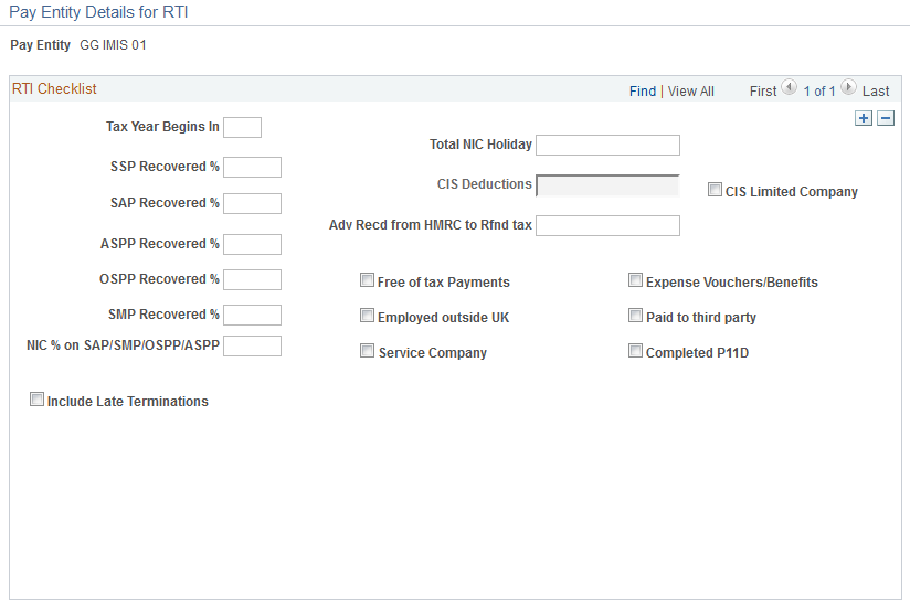

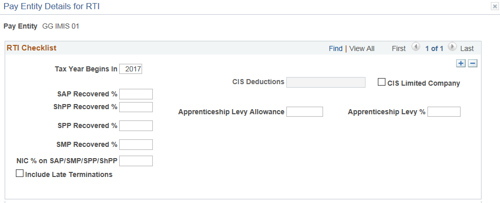

Use the Pay Entity Details for RTI page (GPGB_PYENT_RTI) to enter high level information required for RTI in addition to your existing EDI configuration.
Image: Pay Entity Details for RTI page
This example illustrates the fields and controls on the Pay Entity Details for RTI page.
Field or Control
Definition
Tax Year Begins In
Indicates the corresponding tax year in order for which the RTI files will be generated.
Note: No files will be generated if this field is blank.
SSP Recovered %, SAP Recovered %, ASPP Recovered %, OSPP Recovered %, and SMP Recovered %.
The statutory payment amounts to be recovered are calculated using the percentage values entered in these fields. These amounts are calculated when generating the EPS file.
If the ‘Tax Year Begins in’ is selected as 2017, two additional fields will be displayed as shown below.
This example illustrates the Pay Entity Details for RTI page when ‘Tax Year Begins in’ is selected as 2017.
Pay Entity Details for RTI page for 2017
Field or Control
Definition
Apprenticeship Levy Allowance
Specify the Apprenticeship Levy Allowance.
Apprenticeship Levy%
Enter the percentage of apprenticeship levy if there are any amendments in the mid of the fiscal year.

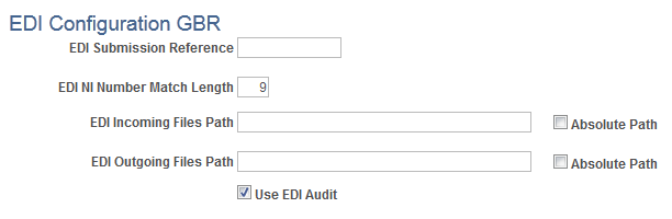

Use the EDI Configuration GBR page (GPGB_EDI_SETUP) to configure the location for the incoming NVREP files from HMRC to be saved.
Image: EDI Configuration GBR page
This example illustrates the fields and controls on the EDI Configuration GBR page.
The EDI configuration may already be in place for your existing EDI infrastructure. See the EDI Configuration GBR Page topic for more information.

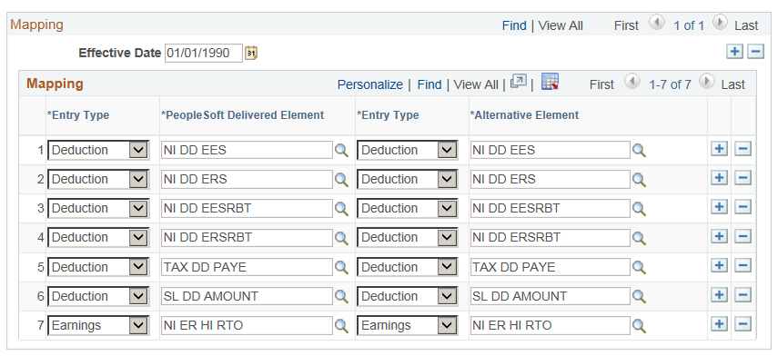

Use the RTI Elements Mapping page (GPGB_RTI_REC_MAP) to map any customized Earnings/Deductions that is used instead of the PeopleSoft delivered Earnings/Deductions that are being reported in RTI. The mapping data will be delivered pre-populated and can be changed based on payroll elements, if required.
Image: RTI Elements Mapping GBR
This example illustrates the fields and controls on the RTI Elements Mapping GBR page.
Field or Control
Definition
Effective Date
The date from which the Mapping is valid.
Entry Type
Displays the Element Type. Values can be:
  • Earning
  • Deduction
PeopleSoft Delivered Element
The Element Name that is used/delivered by PeopleSoft.
Alternative Element
The Element Name that is used by the customer for the same Earning/Deduction as delivered by PeopleSoft.

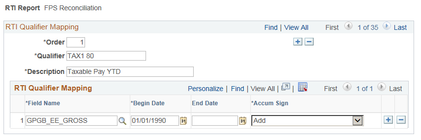

Use the RTI Qualifier Mapping page (GPGB_RTI_QL_MAP ) to map the RTI Qualifiers to the GPGB_FPS_SUBMIT fields. The mapping data will be delivered pre-populated and is recommended to not modify this data. The Reconciliation Process will pick up the mappings from this page.
Note: This mapping is only used for RTI Reconciliation and not used in the process to generate the RTI files.
Image: RTI Qualifier Mapping GBR Page
This example illustrates the fields and controls on the RTI Qualifier Mapping GBR page.
RTI Qualifier Mapping Page
Field or Control
Definition
RTI Report
Values can be:
  • FPS Reconciliation
  • EPS Reconciliation
  • Payroll Reconciliation
Order
The Sequence Order of the Field on the Report.
Qualifier
The actual Qualifier Name on the Report as specified by HMRC.
Description
The description of the Qualifier.
Field Name
The name of the field from GPGB_FPS_SUBMIT that is mapped to the particular Qualifier.
Begin Date
The date from which the mapping is valid.
End Date
The date till which the mapping is valid.
Accum Sign
Values can be:
  • Add: Specify whether the corresponding field adds to the Qualifier Total.
  • Subtract: Specify whether the corresponding field deducts from the Qualifier Total.

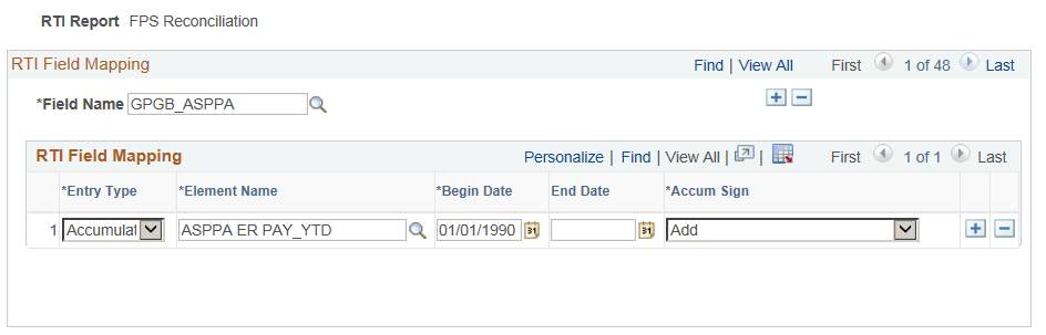

Use the RTI Field Mapping page (GPGB_RTI_FL_MAP ) to map the GPGB_FPS_SUBMIT fields to Payroll Earning/Deduction Elements and Accumulators. The mapping data will be delivered pre-populated and is recommended to not modify this data. The Reconciliation Process will pick up the mappings from this page.
Image: RTI Field Mapping GBR
This example illustrates the fields and controls on the RTI Field Mapping GBR page.
RTI Field Mapping Page
Field or Control
Definition
RTI Report
Field Name
The name of the fields that are being used for reporting and are mapped on the Qualifier Mapping page.
Entry Type
  • Earning
  • Deduction
  • Accumulator
Element Name
The Element Name that is mapped to the Field.
Begin Date
End Date
Accum Sign
Values can be:
