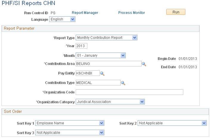

Use the PHF/SI Reports CHN page (GPCN_PHFSI_DATA_RC) to generate the Annual Base Report, Monthly Contribution Report, and Eligibility Report.
Navigation
Image: PHF/SI Reports CHN page
This example illustrates the fields and controls on the PHF/SI Reports CHN run control page.
Field or Control |
Definition |
| Report Type |
Select which report to generate. Values are:
| Year andMonth |
Enter the year and month for which you are generating the report. |
| Contribution Area |
Enter the contribution area for which you are generating the report. Values are:
If you do not make a selection in the Contribution Type field, the process produces separate reports and CSV files for all available PHF/SI contributions. |
| Pay Entity |
Enter the pay entity for which you are generating the report. If you leave this field blank, the process produces a report for all pay entities in the reporting period. |
| Contribution Type |
Select the type of contribution for which you are generating the report. Values are:
| Organization Code |
Enter your organization code. |
| Organization Category |
Select the organization category for which you are generating the report. This field appears only if you select Monthly Contribution Report in theReport Type field. Values are:
| Filing Date |
Enter the date on which you are filing the report. This field appears only if you select Eligibility Report in theReport Type field. |
| Sort Order |
Use the sort keys to sort your generated reports by Employee Name, Employee Number, and PHF/SI Account Number. |
