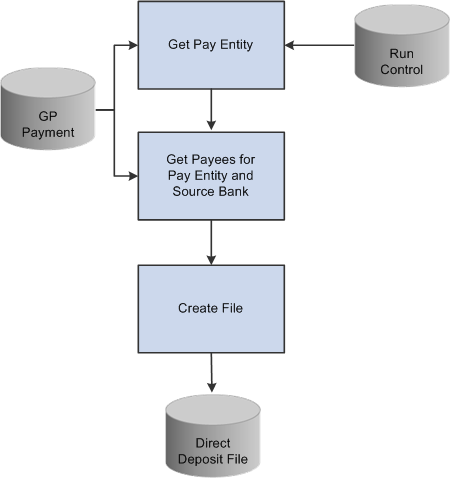

You use the Create Payment EFT page to define the parameters for the EFT file and to run the Create Payment EFT File process.
This diagram shows the Create Payment EFT File process:
Image: Create Payment EFT File process
This diagram shows the Create Payment EFT File process.

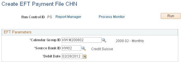

Use the Create EFT Payment File CHN (create electronic funds transfer payment file China) page (GPCN_EFT_RC) to create the EFT file for direct deposits.
Image: Create EFT Payment File CHN page
This example illustrate the fields and controls on the Create EFT Payment File CHN page.
Field or Control
Definition
Calendar Group ID
Select the calendar group ID to be used with this Payment EFT file. Only those calendars that are ready for banking are available for selection.
Source Bank ID
Select a source bank ID.
Debit Date
Net Pay Distribution data for each payee as of this date is used when the Payment EFT file is created.
