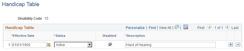

Use the Handicap Table page (GVT_HANDICAP_TBL) to assign codes to the types of disabilities a person might have.
You can set up the table with the disabilities that your agency is likely to use and add more as needed.
Navigation
Image: Handicap Table page
This example illustrates the fields and controls on the Handicap Table page. You can find definitions for the fields and controls later on this page.
Field or Control |
Definition |
| Disabled |
Select if the disability code describes what your agency considers a disability. Usually you select this check box. However, if (for example) you set up a disability code to indicate that a person has no disability, leave this check box deselected. |

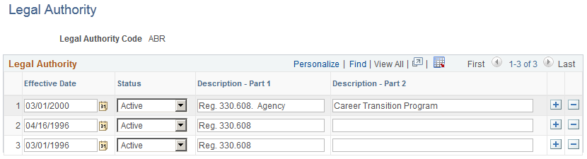

Use the Legal Authority page (GVT_LEGAL_AUTH_TBL) to the Legal Authority table provides the values that are used on the Data Control pages for Personnel Action Request (PAR) processing.
Navigation
Image: Legal Authority page
This example illustrates the fields and controls on the Legal Authority page. You can find definitions for the fields and controls later on this page.
A legal authority is the authority that empowers an agency to grant a personnel action request. PeopleSoft delivers your system with a list of legal authorities. If the Office of Personnel Management issues an update of legal authorities, you can keep your system up to date by changing the information in the Legal Authority table.
Field or Control |
Definition |
| Effective Date |
When you add a legal authority code to this table, select an effective date early enough to accommodate your organization's oldest historical record to which it applies. Add data rows to maintain history data for information that changes over time. |
| Description - Part 1 and Description - Part 2 |
Enter descriptions that appear on the Data Control page (GVT_JOB0) when you process personnel actions for a person. |

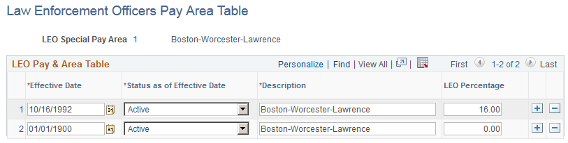

Use the Law Enforcement Officers Pay Area Table page (GVT_LEOAREA_TABLE) to set up special pay areas in the Law Enforcement Officers Pay Area Table .
Law enforcement officers in these regions receive additional pay above the base pay for their pay plan, grade, and step. PeopleSoft delivers the current LEO pay areas, and you can update them based on Office of Personnel Management updates that you might receive throughout the year.
Navigation
Image: Law Enforcement Officers Pay Area Table page
This example illustrates the fields and controls on the Law Enforcement Officers Pay Area Table page. You can find definitions for the fields and controls later on this page.
Field or Control |
Definition |
| LEO Percentage (law enforcement officer percentage) |
Enter the percentage of base pay that LEOs in this region receive in addition to the base pay set by their pay plan, grade, and step. The amount is reflected on the Compensation Data page (JOB_DATA3) in Administer Workforce. |

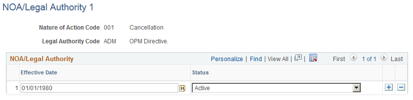

Use the NOA/Legal Authority 1 page (GVT_AUTH_VAL_1) to connect the NOA codes that are defined in the Nature of Action table with the legal authorities that are defined in the Legal Authority table.
You must have set up nature of action codes and legal authority codes.
Navigation
Image: NOA/Legal Authority 1 page
This example illustrates the fields and controls on the NOA/Legal Authority 1 page. You can find definitions for the fields and controls later on this page.
When you enter an NOA (nature of action) code on the PAR Data Control page in Administer Workforce and prompt on the Authority (1) field, you see only the valid values from this table. However, for Authority (2), you can select any of the legal authorities that are defined in the Legal Authority table.

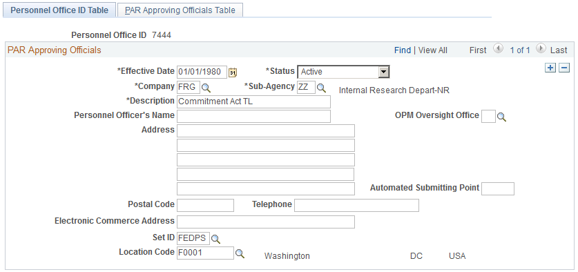

Use the Personnel Office ID Table page (GVT_POI_TABLE1) to assign an identification number to every personnel office in your agency.
Much of the information that you enter is printed on the personnel action requests.
Navigation
Image: Personnel Office ID Table page
This example illustrates the fields and controls on the Personnel Office ID Table page. You can find definitions for the fields and controls later on this page.
Field or Control |
Definition |
| Sub-Agency |
Select the sub-agency code. |
| Personnel Officer's Name |
Enter the name of the person who is responsible for personnel actions for this office. |
| OPM Oversight Office (office of personnel management oversight office) |
Select the OPM Oversight Office to which you report personnel actions from the available values. The values are stored on the Translate table. To change or add values, inform your project management office of the updates you require. |
| Automated Submitting Point |
The automated submitting point is an informational field and isn't used during PeopleSoft HCM processing. However, it is required on the OPM form that is used to communicate the establishment of or changes to a Personnel Office Identifier for currently operating personnel offices. |
| Electronic Commerce Address |
This address is for your agency's information only. For example, this might be an email address or a government network ID. |

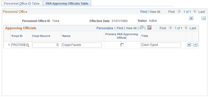

Use the PAR Approving Officials Table page (GVT_POI_TABLE2) to enter the names that appear in the routing process section of the PAR.
Navigation
Image: PAR Approving Officials Table page
This example illustrates the fields and controls on the PAR Approving Officials Table page. You can find definitions for the fields and controls later on this page.
Field or Control |
Definition |
| Empl ID (employee ID) |
Enter an employee ID for each official who approves personnel actions. When you move out of the field, the system populates the Empl Record, Name, and Title fields. You can edit these fields. |
| Primary PAR Approving Official (primary personnel action request approving official) |
Select if applicable. This check box is for your information only. |

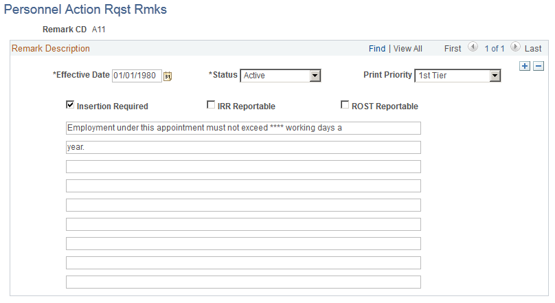

Use the Personnel Action Rqst Rmks page (GVT_SF50_RK_TBL) to define standardized remarks to attach to PARs.
You use some remarks exactly as they are entered here, but you insert person-specific information into other remarks when you attach the remark at the person level.
Navigation
Image: Personnel Action Rqst Rmks page
This example illustrates the fields and controls on the Personnel Action Rqst Rmks page. You can find definitions for the fields and controls later on this page.
The Office of Personnel Management (OPM) designates remark codes that begin with A through X. PeopleSoft delivers the current standard OPM PAR remarks, but you need to maintain them, based on OPM updates that you might receive throughout the year. To enter additional remarks for your agency's internal use, use codes that begin with Y or Z. When you upgrade PeopleSoft HCM, retain your agency-specific remarks.
Field or Control |
Definition |
| Print Priority |
Select the printing priority for the remark. Available values are 1st Tier and 2nd Tier. First tier remarks print first on the SF50/52 reports before any second-tier remarks. Therefore, any remark that is defined as 1st Tier is printed in the order it is listed by the HR personnelist. These are followed by the 2nd tier remarks. |
| Insertion Required |
Select if this remark needs employee-specific information. When you select this remark at the person level, this check box is unavailable for entry. PeopleSoft uses an asterisk (*) to denote person-specific information that is changed by your human resources personnel clerk when the remark is attached to a PAR at the person level. |
| IRR Reportable (individual retirement record reportable) |
Select if this remark is attached to a PAR that is to be printed on an IRR and you want to print the remark on the IRR. |
| ROST Reportable (Register of Separations and Transfers reportable) |
Select to have this remark printed on the ROST. |
