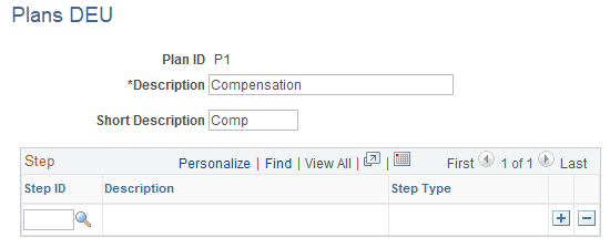

Use the Plans DEU page (IPE_PLAN_TABLE) to group the steps into a training plan.
Image: Plans DEU page
This example illustrates the fields and controls on the Plans DEU page. You can find definitions for the fields and controls later on this page.
Plans DEU page
Field or Control
Definition
Step ID
Add or delete the steps that make up this plan. When you add a step, the system displays information about the step.
To enroll an employee in training plans, create a profile or update the employee's existing profile using the Manage Profiles business process.
Note: Use the profile type PERSON to enroll employees in German internal training plans.
