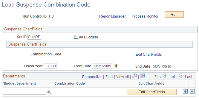

Use the Load Suspense Combination Code page (RUNCTL_BUD021) to use to assign suspense combination codes to departments that require them.
Image: Load Suspense Combination Code page
This example illustrates the fields and controls on the Load Suspense Combination Code page.
Suspense ChartFields
Field or Control
Definition
SetID
Select the SetID of the departments to which you are assigning suspense combination codes.
All Budgets
Select to have the process assign the suspense combination code displayed in the Combination Code field to every department for the selected fiscal year with the exception of those departments you select in the Departments group box.
Combination Code
Select the Edit ChartFields link to search for an existing combination code or select a unique combination of ChartFields on the ChartField Detail page. The value(s) you select will be assigned to department budgets.
If you select the All Budgets check box, the process will assign this suspense combination code to all department budgets, including those that already have an assigned suspense combination code (the process will replace the assigned suspense combination code with the one selected here).
If you do not select the All Budgets check box, the process will assign this suspense combination code to those department budgets that don't yet have one.
The system will not assign this suspense combination code to a department budget if you enter an alternative in the Departments group box.
See Editing ChartField Combinations in HCM Transactions.
Fiscal Year and From Date
Select the budget fiscal year and date from which it starts.
Departments
Field or Control
Definition
Budget Department and Combination Code
Select one or more department budgets and the suspense combination code to assign to it.
