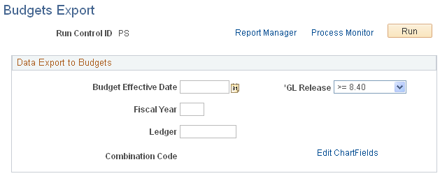

Use the Budgets Export page (RUNCTL_BUD010) to run the Data Export to Budgets process (BUD010.
SQR), which creates baseline budget data that can be uploaded to PeopleSoft Budgets at the end of the fiscal year.

Image: Budgets Export page
This example illustrates the fields and controls on the Budgets Export page.
Field or Control |
Definition |
| Budget Effective Date |
Enter the appropriate budget effective date. The system uses the Budget Effective Date and the Fiscal Year you specify to determine which budget is the final source of funding data for appointments and positions. |
| Fiscal Year |
Enter the appropriate fiscal year. The system uses the Fiscal Year and Budget Effective Date to select funding information for a particular budget. |
| Ledger |
Indicate to which budget ledger you are sending the budget data. |
| Combination Code |
Indicate which combination code should be used when no other funding source is indicated. |
