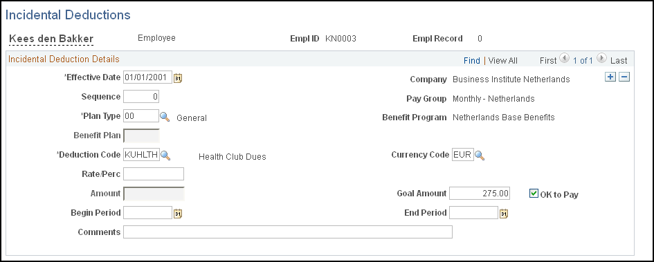

Image: Incidental Deductions page
This example illustrates the fields and controls on the Incidental Deductions page. You can find definitions for the fields and controls later on this page.
Field or Control
Definition
Sequence
Enter a sequence number. This is required if you are entering multiple earnings information using the same effective date.
Pay Group
Displays the employee's pay group.
Plan Type
Select the plan type, which automatically uses a default of 00 (general) because most incidental deductions are general deductions rather than benefit deductions. Other one time benefit deductions can be associated with other plan type codes.
Benefit Program
Displays the benefit program in which the employee is enrolled. Use the Enroll in Benefits - Benefit Program page to verify or update the employee's enrollment.
Benefit Plan
Enter a benefit plan.
Deduction Code
Select a deduction code for the incidental deduction. Deduction codes are associated with plan types on the Deduction Table page, so the list shows only the deduction codes for the plan type that you just entered.
See Deduction Table Page.
Amount
Enter the amount of the deduction, depending on the type of incidental deduction that is entered.
Currency Code
Select the currency code for the deductions.
Rate/Pct (rate/percent)
Enter the rate or percent of the deduction, depending on the type of incidental deduction that is entered.
Goal Amount
Enter the goal amount if you want to specify a total amount at which withholding of the deduction stops.
OK to Pay
Select to indicate approval if the organization has a procedure in place to first enter the incidental hours and then to obtain approval for payment of the incidental hours.
Begin Period and End Period
Enter the beginning and ending dates of the period for which the incidental deduction applies.
