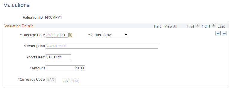

Use the Valuations page (VC_VALUATION) to define units of non-monetary and stock awards and assign a currency value for one unit.
This page is required only if you set up non-monetary or stock variable compensation (VC) plans.

Image: Valuations page
This example illustrates the fields and controls on the Valuations page.
Field or Control |
Definition |
| Effective Date |
Enter the effective date of the value that you are entering for the valuation ID. If you change the value of the valuation ID, the system uses the monetary value associated with the valuation ID on the maximum effective-dated row that is equal to or less than the payout period end date. |
| Amount |
Enter the monetary value of one unit of the non-monetary award represented by this valuation ID. For example, enter the monetary value of one holiday turkey. For stock-type plans, one unit is one option or share. |
| Currency Code |
Select the code for the currency in which to administer an award for this valuation ID. When you assign the valuation ID to a VC plan, the currency code of the valuation ID must match the currency code of the plan. You can override the default value that the system enters. |
