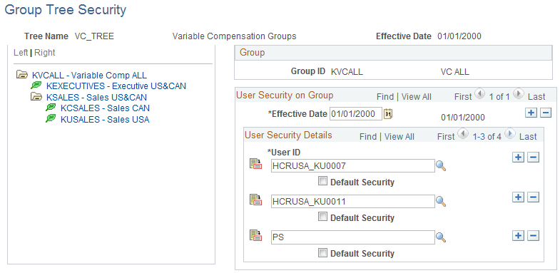

Use the Group Tree Security page (VC_TREE_SEC_TABLE) to set up a security relationship between a group on a Variable Compensation tree, a user, and the Variable Compensation components.
Access to a group provides access to variable compensation components for all its child groups as well.

Image: Group Tree Security page
This example illustrates the fields and controls on the Group Tree Security page.
Field or Control |
Definition |
| Tree Name |
The name of the tree that you entered on the search page, along with its description. |
| Effective Date |
The default is the date that you entered in the Effective Date field of the search page. Change the date to access the same tree as of a different effective date. |
Using the Tree Control View
The Tree Control view on the left side of the page displays the tree as it is defined in PeopleSoft Tree Manager. Each node represents a group. The node description is the group ID.
In the Tree Control view, select a node for which you want to define security access. The group ID and description of the group appear on the right side of the page.
User Security on Group
Field or Control |
Definition |
| Effective Date |
Enter the effective date of the user's security access. You can add rows of data with different effective dates. Enter the page in Correct History mode to delete a row. |
| User ID |
You see a data row for the ID of each user who has security access to the selected group ID for the specified effective date. Add a user by adding a data row and selecting a user ID from the available values. Set up your group tree security so that you give access to both the manager and the approver of a group. You cannot delete users whose access to this group is inherited from a parent group (the Default Security check box is selected). The system performs this check within the tree and between trees when the parent group is reused in another tree. If you try to delete a data row for inherited access, the system issues a message that specifies the user ID along with the tree name and group ID of the parent group. |
Component Security |
Click the Component Security icon to the left of a User ID to access the VC - Tree Group Security page, where you set security on components for that user. |
| Default Security |
Select this check box if you want the automatic VC tree security update process to grant the user access to VC pages for all groups that you might place as a child under the selected group in future tree modifications. Example: You grant user 1 default security access to group A. Later, you place group D (which was formerly a sibling of A) as a child of group A. The automatic VC tree security update process then grants user 1 default access to group D as long as D remains a child of A. If you later modify the tree so that group D is no longer a child of group A, the system warns you if an inconsistency exists in security. User 1 might no longer have access to VC pages for group D. You cannot remove a user's security access to a group if the access is granted by default. |

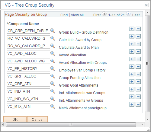

Use the VC (variable compensation) - Tree Group Security page (VC_TREE_SECU_SEC) to specify the components for which the selected user has security access.
Navigation
Click the Component Security icon to the left of the user ID on the Group Tree Security page.
Image: VC - Tree Group Security page
This example illustrates the fields and controls on the VC - Tree Group Security page.
Field or Control |
Definition |
| Component Name |
By default, a new user has access to all Variable Compensation components. On the VC - Tree Group Security page, delete the data rows for any components that you don't want the user to access. The system applies your component selections to the selected group ID, user ID, and effective date. Your selections also apply to any child groups of the selected group ID. |
