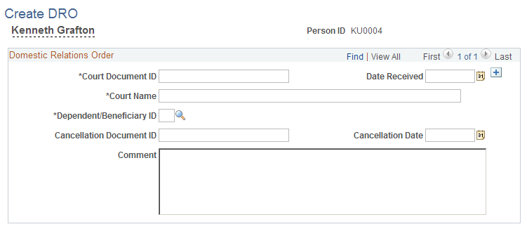

Use the Create DRO page (PA_DRO_SPEC) to:
  • Record receipt of a DRO.
  • Record DRO activities up to the point when the DRO is determined to be qualified.
Image: Create DRO page
This example illustrates the fields and controls on the Create DRO page.
Create DRO page
When you first learn of an impending QDRO, the court order is not yet qualified, so you are actually dealing with a DRO, not a QDRO. During the process of qualifying the DRO, you will probably be in regular communication with the attorneys for the parties.
You can create a DRO only for an employee.
Field or Control
Definition
Court Document ID
Enter the identification (ID) number of the DRO.
Date Received
Enter the date when you first receive the court documents.
Court Name
Enter the name of the court issuing the DRO.
Dependent/Beneficiary ID
Select the ID of the former dependent or beneficiary on whose behalf the DRO has been issued. This individual (typically a former spouse) must be recorded in the PeopleSoft system as a dependent or beneficiary.
Comment
Enter any comments. Record ongoing activity by appending additional comments (appropriately dated) in this field.
Cancellation Document ID and Cancellation Date
If it is determined that the DRO is not qualified, enter the cancellation document ID number and cancellation date.

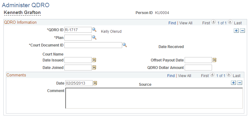

Use the Administer QDRO page (PA_QDRO_SPEC) to record the amount awarded to the alternate payee.
This amount is crucial because it is the basis for the QDRO payments.
Image: Administer QDRO page
This example illustrates the fields and controls on the Administer QDRO page.
Before you can enter information on this page, you must use the Create DRO page to input the DRO. You must also set up the QDRO alternate payee's EmplID.
Note: You cannot access the QDRO pages until you set up the QDRO alternate payee's EmplID.
Field or Control
Definition
QDRO ID
Select the alternate payee's employee ID.
Plan
Select the employee's pension plan.
Court Document ID
Enter the court document ID that you entered on the DRO page.
When you enter the court document ID for the DRO information, the system automatically transfers the following fields from the DRO page: Date Received, Court Name, Comments, and Date (comment date).
Date Issued
Enter the date the QDRO was issued.
Date Joined
Enter the date of the court order itself.
Offset Payout Date
Enter the earliest date at which the QDRO alternate payee can begin receiving the benefit.
Note: If the QDRO alternate payee begins receiving payments earlier than the participant's normal retirement date, the QDRO dollar amount entered on this page (which is the amount as of the participant's normal retirement date) may be reduced.
QDRO Dollar Amount
Enter the amount that the QDRO alternate payee will receive. This amount must be expressed in the same terms as the normal plan retirement date with a normal form of payment.
For example, John's benefit of 200 USD is his benefit as of the date Caroline reaches normal retirement age, assuming a single life annuity and monthly payments.
If the HPLAN normal benefit amount is expressed yearly, enter the yearly benefit, 6,840 USD.
Note: The implied payment form, frequency, and commencement date are important because this is the amount which is taken from the employee's final benefit. If you enter a monthly amount here, and the benefit formula subtracts this amount from Jane's yearly benefit, the offset calculation would be incorrect.
