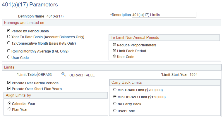

Use the 401(a)(17) Parameters page (PA_401A17_PARMS) to set up 401(a)(17) parameters.
Image: 401(a)(17) Parameters page
This example illustrates the fields and controls on the 401(a)(17) Parameters page.
The 401(a)(17) limits are published annually by the IRS. Because the limits can change over time, it is important to identify the correct limit for each earnings period.
Earnings are Limited on
Besides identifying the limit for each earnings period, you need to specify a method for applying the limit:

To Limit Non-annual Periods
Because the limits cross multiple consolidation periods, you have to indicate which earnings periods to reduce, and how much.
Field or Control

Limits
401(a)(17) limits came into effect in 1989. Calculations with an event date prior to 1989 do not use 401(a)(17) limits. If you align by plan year, event dates in the 1988–1989 plan year are also considered exempt from 401(a)(17) limits. If the event date is 1989 or later, however, you can limit all of an employee's earnings, not just earnings after 1989.
Field or Control
Definition
Limit Table
The system looks up the limit for each year using the table lookup utility. The table used associates calendar years with limits.

Prorate Over Partial Periods
Select this to prorate the limits for short periods, including the final period, when you limit on a period by period basis.

Prorate Over Short Plan Years
If you align limits by plan year, a change in plan year results in a partial period. You therefore also have the option to prorate over short plan years. This option only applies when you apply the limits on a year-to-date basis using monthly consolidations.
In order for the system to recognize short plan years, the short year must have its own effective-dated row in the Pension Plans (US) table.
Limit Start Year
Because there are no published limits for years prior to 1989, you must choose what limit, if any, to use for those earlier years. The amount you use is the "carry back" limit. It is applied to all years from the hire date until the limit start year. Beginning with the limit start year, the limits are determined based on the table lookup that you specified in the Limit Table field. Enter a limit start year, then select a carry back option.

Carry Back Limits

Align Limits by
Regardless of the period being limited (month, calendar year, plan year, or other year), the system determines the limit based on your Align Limits by choice. This setting also determines the limit for the event date, which is used as a final limit for the final average earnings result.
