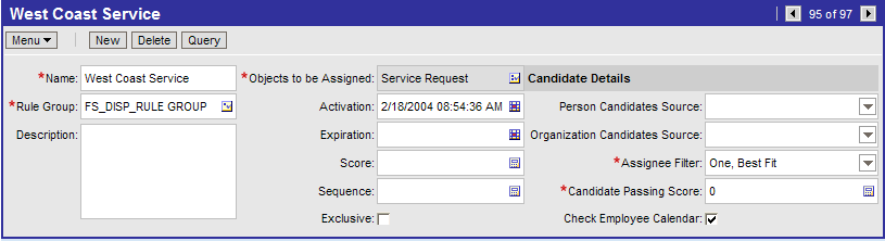

When administrators define a new rule, selecting the Check Employee Calendar box activates the assignment availability criteria.

If an assignment rule has the Check Employee Calendar flag checked, then availability for each employee is evaluated before assignment. If the Calendar Create Activity property is also set for the assignment object, then make sure that an activity exists in the employee's calendar for that duration to block the schedule. The following figure shows a high-level flowchart of this process, which includes the following steps:
If the calendar’s Check Employee check box is selected for the Assignment Rule, then Assignment Manager . . .

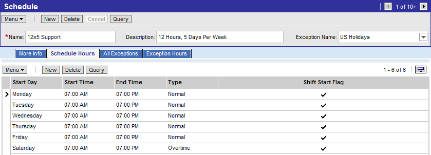

Verify that a schedule exists with valid hours by navigating to the All Schedules view (Administration - Service screen, Schedules view).
For this example, select the 12x5 Support schedule in the Schedules List, and click the Schedule Hours view tab. Make sure that the hours listed are valid. The following figure shows this view (the Schedule Hours view tab).

Create the assignment rule by navigating to the Administration - Assignment screen, and then the Assignment Rules List view.
In the Assignment Rules List, choose Edit, then New Record.
In the new record, enter the following settings:
Name = West Coast Service
Objects to Be Assigned = Service Request
Assignee Filter = One, Best Fit
Click the Check Employee Calendar checkbox to enable the rule for availability-based assignment.

The following figure shows an example of a field service assignment rule, where:
Rule Group = FS_DISP_RULE GROUP
Candidate Passing Score = 0
The Check Employee Calendar checkbox is activated, thereby enabling the rule for availability-based assignment.
