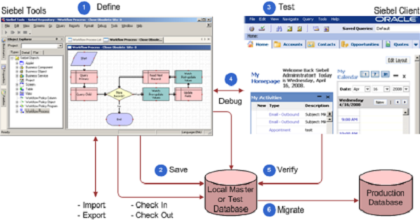

The following figure describes a typical approach to developing a workflow process.
Explanation of Callouts
You do the following to develop a workflow process:
Define. You use Siebel Tools to define the workflow process. You create an object definition for the workflow process, define the process properties, add steps and connectors, and so on. For more information, see About Siebel Tools.
Save. You frequently save the workflow process to the local database. This database includes repository tables. When you edit a workflow process in Siebel Tools, Siebel CRM stores it in the repository tables. When you deploy this workflow process, Siebel CRM adds it to the run-time tables.
Test. You use the Siebel client to test the workflow process. You use the Administration-Business Process screen in the client to administer workflow processes and workflow policies. For more information, see Process of Testing a Workflow.
Debug. You use Siebel Tools, the Siebel client, and the local master or test database to publish, activate, and debug the workflow process. You check out the workflow process from the repository into the local database where you can modify and debug it locally before you check it into the master repository. To access server components, such as the Server Request Broker, you must debug and test with a server database or test database instead of debugging locally. You can optionally do the following in Siebel Tools:
Check the workflow process into and from your master database.
Export the workflow process to an XML file to back it up.
Import the workflow process from an XML file to restore it.
Verify. To verify that the workflow process works correctly, you can use the Siebel client to run it with the local master or test database.
Migrate. You migrate the workflow process from the master database to the staging database or production database. You can use Application Deployment Manager (ADM) to migrate workflow processes from one Siebel environment to another environment. For more information, see Migrating with Application Deployment Manager.

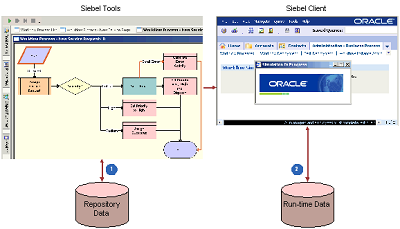

The following figure describes the architecture that you use to simulate a workflow process.
You use the following items to simulate a workflow process:
Repository data. The Process Simulator accesses object definitions from the repository that are part of the workflow process or that the workflow process references.
Run-time data. Siebel Tools accesses or modifies data during the simulation, depending on how you define the workflow process. It can access data in the run-time database, such as customer data that resides in various fields of an opportunity.
If you run a workflow process from the Process Simulator, then it runs in the Application Object Manager. You can start a workflow process in the Application Object Manager or in a server session of the Workflow Process Manager.

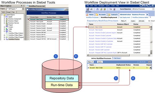

The following figure describes how you use Siebel Tools and the Siebel client to deploy a workflow process.
Siebel CRM does the following to deploy a workflow process:
Marks the workflow process Completed for deployment.
Reads the workflow process from the repository.
When activated, writes the workflow process to the run-time tables.

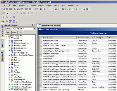

You use Siebel Tools to modify predefined Siebel objects and to define new objects that meet a business requirement for your organization. Just as you use Siebel Tools to modify the data model, modify business logic, and to define the user interface, you can also use Siebel Tools to define a workflow process that Siebel CRM uses to automate a business process for your organization.
The following image includes the Object Explorer window and the Workflow Processes list in the Object List Editor window.

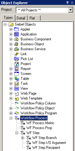

The Object Explorer allows you to navigate between each group of object definitions of a particular object type.
An object type is an entity that you can use as a template that Siebel Tools uses to create an object definition. Siebel Tools displays object types in the Object Explorer.
An object definition implements one piece of the software. It includes a predefined set of object properties, which are characteristics of that piece of the software. Siebel Tools displays object definitions in the Object List Editor.
If Siebel Tools does not display an object type in the Object Explorer, then you must display it. For more information, see Displaying Object Types You Use to Develop a Workflow Process.
Relationships Between Object Types of a Workflow Process
A parent and child relationship is a type of hierarchical relationship that exists between one object type and another object type. The following image illustrates how the Object Explorer displays this parent and child relationship as a hierarchical tree.
If you choose the Types tab in the Object Explorer, then Siebel Tools displays tree items as icons in a hierarchy. An object type that is beneath and slightly to the right of another object type is the child of the parent and child relationship. The object type that is above the child object type is the parent object type for the child. A parent object type can contain multiple child object types. For example, WF Process Metric, WF Process Prop, and WF Step are child object types of the Workflow Process object type.
Object Properties
If you click Workflow Process in the Object Explorer, then the Workflow Processes list in the Object List Editor displays a list of workflow processes that the Siebel runtime repository contains. One row in the Workflow Processes list represents one object definition. For example, values in the properties in the Contact-New Order workflow process constitute one object definition.
Siebel Tools displays each object property in one column in the list. You can edit the value of a property. You cannot change the set of properties that constitute an object definition.
You can also use the Properties window to edit the properties of the object definition that is currently chosen in the Object List Editor. Changing a value in the Properties window also changes the corresponding value in the Object List Editor.
