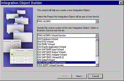

From the application-level menu, choose File, and then New Object.
The New Object Wizards dialog box appears.
Select the EAI tab and double-click Integration Object.
The Integration Object Builder wizard appears.
Fill in the two fields.
Select the project you have locked.
Select FINS ACORD Wizard Service from the Business Service list.
Click Next.

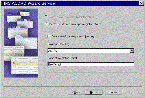

After the wizard parses the DTD file, it displays the next page so that you can create an envelope integration object.
- For this example, select the Create user defined envelope check box, fill in the name of the integration object, and click Next.
If you wanted to create a standalone envelope, you would select the Create envelope integration object only check box. A standalone envelope integration object can be used by any integration objects later on.
Click Next.

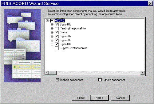

The wizard displays a visual selection hierarchy so that you can select the elements you want to include in the header.
These elements include <Signon> and <Signoff> elements for both request and response.
For the example, deselect PendingResponseInfo and SuppressNotification.
Verify that the required check boxes are selected, and click Next.

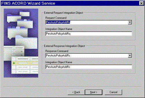

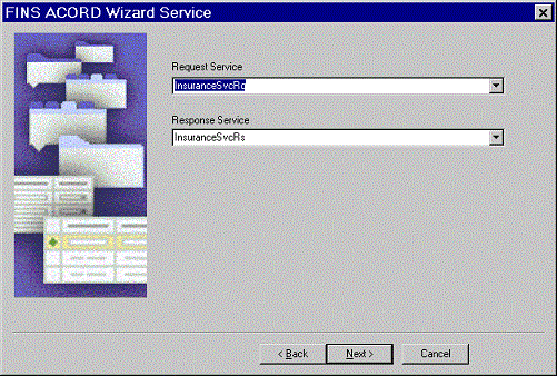

Choose a Request Service and Response Service pair.
For an external integration object, you need to specify a request service and a response service, for example <InsuranceSvcRq> and <InsuranceSvcRs>. These are the service aggregate elements.
Click Next, and then choose the Request Command and Response Command you want to use.
This screen uses Request Command to identify the ACORD request message. The request message you select is automatically paired with an appropriate response message. For this example, you choose <PersAutoPolicyAddRq>; it is automatically paired with <PersAutoPolicyAddRs>.
Note: Make a note of the integration object names. You will need to know the names when you configure the DTE map.You can change the Integration Object Name for the request and response integration objects for administrative convenience. You should consider establishing a set of naming conventions to make groups of objects easy to recognize. This example uses the default names.

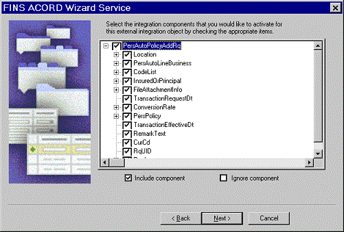

Click Next to display the integration components screen in which you select the message elements to include.
You will select message elements for the request integration object in this screen, and you will select the message elements for the response integration object in the next screen.
Click the plus symbol (+) to display the message elements.
This screen displays a visual hierarchy of the message structure. It provides all the available aggregates and elements for the message. The screen starts with all of these selected (included).
Choose the ACORD message components that you want to activate for this integration object.
Click to select each item. Notice that if you deselect the parent, all the child items are deselected. Reselecting the parent does not reselect the child items, so you can select just a subset of child items.

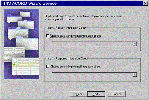

Click Next to display the Select Internal Integration Object screen.
Creating Internal Integration Objects
An internal integration object creates a structure that matches the data structure of a Siebel business object.
You can choose an already-created internal integration object, if one has been created. Siebel integration objects are interfaces for outside systems to interact with internal Siebel data.
This example uses the FINS ACORD Wizard to create a new internal integration object, as shown in the following procedure.

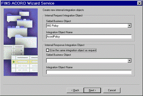

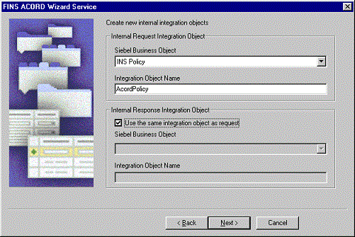

In the Select Internal Integration Object screen, do not select either check box, and click Next to display the New Integration Object screen.
In the Internal Request Integration Object area, choose the business object that contains the information that the connector will exchange, and enter the name of the integration object.
For the Internal Response Integration Object, select the Use the same integration object as request check box.
The entry boxes are grayed-out.

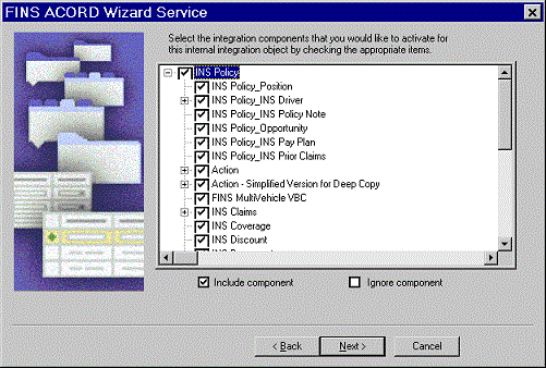

Click Next to display the integration components available from the business object you selected on the previous screen.
This screen displays a visual hierarchy of the business object structure. It provides all the available aggregates and elements for the message.
Deselect the elements you do not want to include, and then click Next.

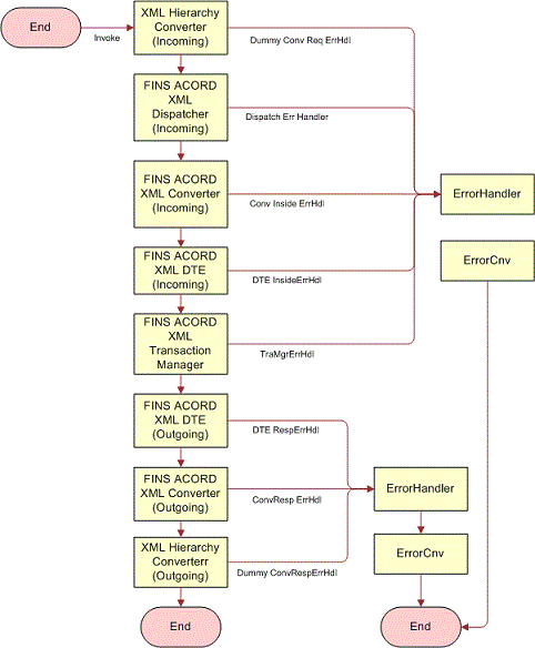

For an inbound message, one that originates in an external application, the following shows the structure of a workflow that receives a request and sends back a response. The example workflow is the ACORD Server Policy Package Workflow included in the sample workflows.

For this component, choose the XML Hierarchy Converter.
Choose the method.
This example uses the XML Document to XML Hierarchy method because, for an incoming message, the conversion is from an XML document to an XML hierarchy that can be used by the FINS ACORD XML Dispatcher.
Set the input and output arguments, XML Hierarchy name, and XML document name.
The following are the input argument settings for the example hierarchy converter incoming configuration.
Input Argument Type Value Property Name Property Data Type XML Document
Process Property
<Value>
String
The following are the output argument settings for the example hierarchy converter incoming configuration.
Property Name Type Value Output Argument PropSet XML Converter Out (Incoming)
Output Argument
XML Hierarchy
Configuring the FINS ACORD XML Dispatcher (Incoming)
The second connector component is the dispatcher.
To configure the dispatcher
Name the dispatcher appropriately (it must be unique within the workflow).
Choose the type of business service from the multi-value group (MVG) window.
For this component, choose the FINS ACORD XML Dispatcher.
Choose the method.
The example uses the Dispatch Message method.
Set the input and output arguments.
The following are the input argument settings for the example dispatcher incoming configuration.
Input Argument Type Value Property Name Property Data Type DispatcherMapName
Process Property
ACORD DispMap Integration Object Name
String
XMLEnvIntObjectName
Process Property
ACORD Envelope Integration Object Name
String
XML Property Set
Process Property
PropSet XML converter Out (Incoming)
Hierarchy
The following are the output argument settings for the example dispatcher incoming configuration.
Property Name Type Value Output Argument PropSet Dispatcher Out (Incoming)
Output Argument
XML Property Set
Configuring the FINS ACORD XML Converter (Incoming)
The third connector component is the converter.
To configure the converter
Name the converter appropriately (it must be unique within the workflow).
For this component, choose the FINS ACORD XML Converter.
Choose the method.
The example uses XMLPropSetToPropSet, because the converter is converting an XML property set from the dispatcher into a Siebel-hierarchy-based property set.
The following are the input argument settings for the example converter incoming configuration.
Input Argument Type Value Property Name Property Data Type IsClient
Process Property
IsClient
String
XMLEnvIntObjectName
Process Property
ACORD Envelope Integration Object name
String
XML Property Set
Process Property
Hierarchy
The following are the output argument settings for the example converter incoming configuration.
Property Name Type Value Output Argument PropSet Converter Out (Incoming)
Output Argument
XML Property Set
SignonRsEcho
Output Argument
SignonRsEcho
Configuring the FINS ACORD XML Data Transformation Engine (Incoming)
The fourth connector component is the data transformation engine (DTE).
To configure the DTE
Name the DTE appropriately (it must be unique within the workflow).
For this component, choose the FINS ACORD XML DTE.
Choose the method.
The example uses the Transform to Siebel Hierarchy method because the data is moving from an external system to a Siebel internal system.
The following are the input argument settings for the example DTE incoming configuration.
Input Argument Type Value Property Name Property Data Type XML Property Set
Process Property
Hierarchy
The following are the output argument settings for the example DTE incoming configuration.
Property Name Type Value Output Argument PropSet DTE Out (Incoming)
Output Argument
XML Property Set
Configuring the FINS ACORD Transaction Manager
The fifth connector component is the transaction manager.
To configure the transaction manager
Name the transaction manager appropriately (it must be unique within the workflow).
For this component, choose the FINS ACORD XML Transaction Manager.
Choose the method.
The example uses the Execute Transaction method because the data is being received from the external data source and must be delivered to the Siebel application.
Establish the input and output arguments.
The following are the input argument settings for the example transaction manager configuration. Notice that the data flow within the connector changes direction at this point from incoming to outgoing.
Input Argument Type Value Property Name Property Data Type Only product Integration Object Instance
Literal
true
Report Error in Message
Literal
true
Rollback In Error
Literal
false
SiebelFINSOperationOut
Process Property
Siebel FINS Operation
String
Status Object
Literal
true
XML Property Set
Process Property
Hierarchy
The following are the output argument settings for the example transaction manager configuration.
Property Name Type Value Output Argument PropSet TransMgr Out (Outgoing)
Output Argument
XML Property Set
Configuring the FINS ACORD XML Data Transformation Engine (Outgoing)
The sixth connector component is the data transformation engine (DTE).
Choose the method.
The example uses the Transform to External Hierarchy method because the data is moving from the Siebel internal system to an external system.
The following are the input argument settings for the example DTE outgoing configuration.
Process Property
Hierarchy
The following are the output argument settings for the example DTE outgoing configuration.
Property Name Type Value Output Argument PropSet DTE Out (Outgoing)
Output Argument
XML Property Set
Configuring the FINS ACORD XML Converter (Outgoing)
The seventh connector component is the converter.
Choose the method.
The example uses PropSetToXMLPropSet because the converter is converting a property set from the DTE into a standard XML property set.
The following are the input argument settings for the example converter outgoing configuration.
Input Argument Type Value Property Name Property Data Type Client Application Name
Process Property
ACORD Client Application Name
String
Client Application Organization
Process Property
ACORD Client Application Organization
String
Client Application Version
Process Property
ACORD Client Application Version
String
Is Client
Process Property
IsClient
String
Is Signoff
Process Property
ACORD Signoff
String
Service Provider Name
Process Property
ACORD Service Provider Name
String
SignonRsEcho
Process Property
SignonRsEcho
Hierarchy
XMLEnvIntObjectName
Process Property
String
XML Property Set
Process Property
Hierarchy
The following are the output argument settings for the example converter outgoing configuration.
Property Name Type Value Output Argument PropSet Converter Out (Outgoing)
Output Argument
XML Property Set
Configuring an XML Hierarchy Converter (Outgoing)
The eighth connector component is a hierarchy converter. For information about Siebel hierarchy converters, see XML Reference: Siebel Enterprise Application Integration.
To configure an XML hierarchy converter
Name the hierarchy converter appropriately (it must be unique within the workflow).
Choose the method.
This example uses the XML Hierarchy to XML Document method because, for an outgoing message, the final conversion is from an XML hierarchy to an XML document that can be accepted by any XML-compliant converter at the external location.
The following are the input argument settings for the example hierarchy converter outgoing configuration.
Input Argument Type Value Property Name Property Data Type XML Header Text
Process Property
ACORD DOCTYPE
String
XML Hierarchy
Process Property
Hierarchy
The following are the output argument settings for the example hierarchy converter outgoing configuration.
Property Name Type Value Output Argument <Value>
Output Argument
XML Document
This step completes the inbound workflow. The inbound ACORD XML connector can be used as the basis for any workflow that is used to receive an inbound request message.
