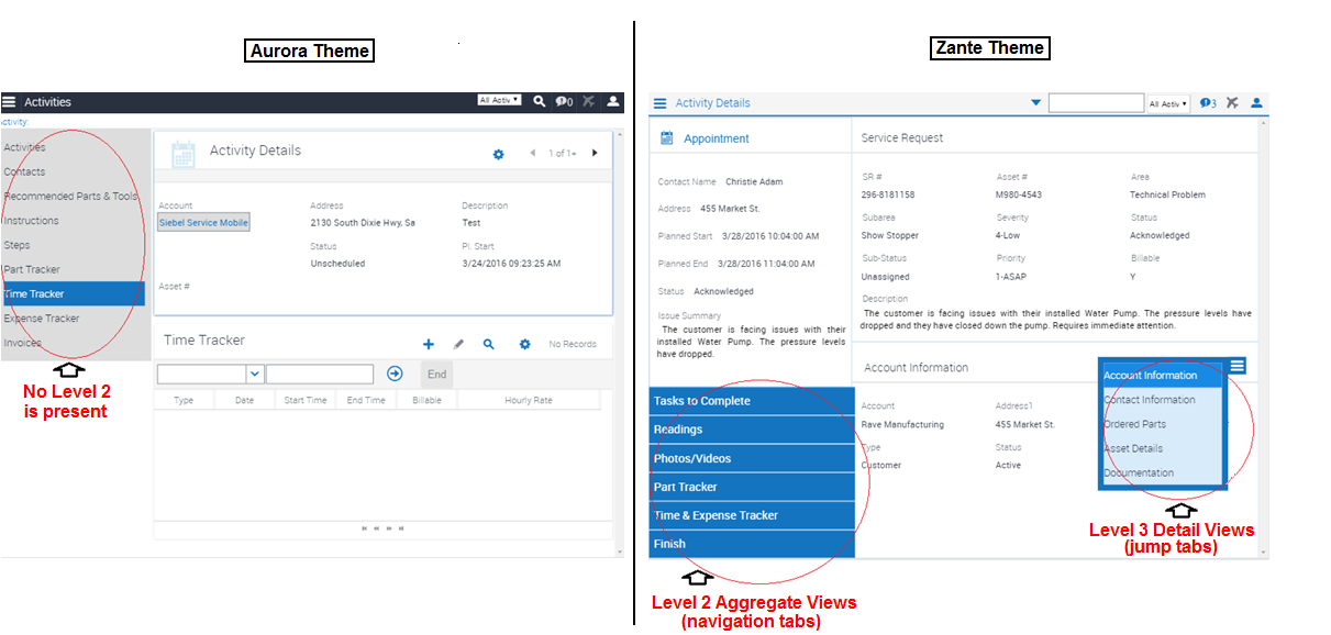

        About the Siebel Mobile Aurora and Zante UI Themes
        The Siebel Mobile applications for Siebel Field Service and Siebel Consumer Goods use the Zante UI theme by default, which is different from the Aurora UI theme which is the default theme used by the other Siebel Mobile applications (for Siebel Pharma, Siebel Sales, and Siebel Finance).
        The main difference between the Zante and Aurora themes is that the Zante theme uses second level navigation views as shown in the following image (see Level 2 Aggregate Views). For information about how to set up second level navigation views for your Siebel application, see Configuring Second Level Navigation Views.
        Siebel Mobile User Interface Aurora and Zante Theme Comparison
          You can configure second level navigation views in Siebel Tools for your Siebel application as required.
          To configure second level navigation views for your application
          1. In Siebel Tools go to the Object Explorer and select Screen.
          2. Query for the screen that you want.
          3. In the screen view, add the new view.
            For each view that you add:
            • Set Type to Aggregate View.
            • Set the sequence number for the view.
            • Do not set the Parent Category for the view.
          4. Update the repository and deliver the updates, then start the Siebel application.
            The new view appears alongside the other second level aggregate views in the UI.

                                                Theme
                                                The UI theme to use throughout the application. Tap Theme, and select a theme from the drop-down list. The following themes are available:
                                                • If Side Menu is selected as the navigation control, then the following themes are available:
                                                  Aurora. This theme is used by default in the Siebel Mobile applications for Siebel Pharma, Siebel Sales, and Siebel Finance.
                                                  Zante. This theme is used by default in the Siebel Mobile applications for Siebel Field Service and Siebel Consumer Goods.
                                                  For more information, see About the Siebel Mobile Aurora and Zante UI Themes.
                                                • If Tab is selected as the navigation control, then the following themes are available: Synergy, Vanilla.
                                                  These themes are available only in the Siebel Mobile applications for Siebel Pharma, Siebel Sales, and Siebel Finance.
                                                • If Tree is selected as the navigation control, then the following theme is available: Aurora.
