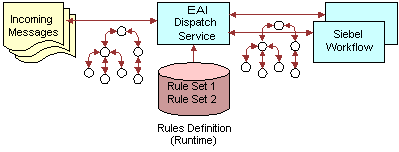

EAI Dispatch Service Process
Although the EAI Dispatch Service is a utility to invoke one business service from another business service based on specified rules, one of its primary uses is to accomplish inbound and outbound integration. The EAI Dispatch Service can be the first business service of the inbound integration to decide which business service should process an incoming document. It can also be the last step of the outbound integration to send the outgoing document to the right transport. The EAI Dispatch Service is similar to the branching in Siebel Workflow. To determine whether to use Siebel Workflow or the EAI Dispatch Service, see Differences Between EAI Dispatch Service and Workflow.
    EAI Dispatch Service Rule Hierarchy

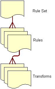

    The EAI Dispatch Service has a three-layer rules hierarchy as illustrated in the following figure.
    Rule Sets
    Rule Sets are sets of rules that you define in a particular sequence. EAI Dispatch Service parses the input document using these rules in sequence until it finds a rule that matches the input.
    Rules
    Rules are individual entities in a rule set. Each rule consists of data transformations, search expression grammar, and zero or more rule transforms. You define rules by using search expression grammar to establish how you want an input message to be routed. For details, see Search Expression Grammar.
    Data Transformation
    A transform specifies how the intermediate output is going to be generated before it is dispatched to the service and the method you specified in the rule. For details, see Output Transformation.

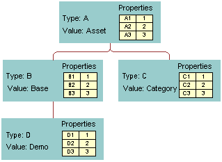

          Transforms are specified using one or more of the following targets in permissible combination.
          RootHierarchy
          This target creates a new output root hierarchy based on the source expression. The source expression specifies a node in the input hierarchy. The hierarchy rooted at this node is copied as the target root hierarchy. You can use the root hierarchy for minor modifications, such as adding a property, to the input hierarchy.
          Only one root hierarchy transform can be specified because this transform always creates a new hierarchy. The root hierarchy transform is always executed before any other transforms in the combination.

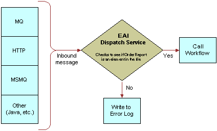

            The steps for creating an inbound or an outbound EAI Dispatch Service are very similar, as illustrated in the following figures.
            The following illustrates the high-level architecture of an inbound EAI Dispatch Service.
            Inbound EAI Dispatch Service

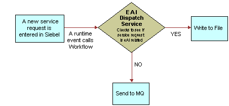

              Outbound Requests
              The steps for creating an outbound EAI Dispatch Service are the same as the steps for an inbound EAI Dispatch Service with some differences in the workflow. The following illustrates the high-level architecture of an outbound Dispatch Service. For details on how to create an outbound workflow, see Outbound Scenario.
              Outbound EAI Dispatch Service

                              Outbound Scenario
                              For this scenario, you want to dispatch a service request as soon as it is created. The scenario assumes that:
                              • You are only interested in service requests logged against EAI.
                              • You know how to design a workflow that gets triggered as a new service request is created.
                                Note: There are number of different ways to trigger a workflow process. For details, see Siebel Business Process Framework: Workflow Guide.
                              • You want the other non-EAI service requests to be sent to an MQSeries.
                              The following illustrates this scenario.
                              Dispatching Service Request
                              To create this scenario
                              1. Create a rule set with a search expression to check if the Service Request Area is set to EAI.
                              2. Create a workflow that is triggered when the criterion defined in Step 1 is matched.
                                Your workflow should contain the following steps:
                                • Start
                                • EAI Dispatch Service
                                • End
                                Inbound Scenario
                                For this scenario, you want to receive an XML document from an external system through MQ, HTTP, MSMQ, or other means and have the EAI Dispatch Service write to an error file if certain criteria are not met, as illustrated in the following figure. The scenario assumes that:
                                • You are only interested in the message if it contains an OrderReport element; otherwise, you want an error written to the error log.
                                • You know how to create a workflow.
                                EAI Dispatching Service Request
                                1. Create a rule set with a rule that searches the message for the OrderReport element.
                                2. Create a workflow that contains the following steps:
                                  • Start
                                  • EAI Data Mapping Engine
                                  • EAI Siebel Adapter
                                  • End
                                3. Create an EAI Dispatch Service that triggers your workflow, once the criteria in Step 1 are matched.

                                    This example shows different output property sets generated by EAI Dispatch Service based on the hierarchy input shown in the following image and certain Target and Source Expression as shown in the first table in this topic.
                                    A Hierarchy Input
                                    The following table presents the intermediate output based on the value of the Target.
                                    Table Output Property Generated by EAI Dispatch Service
                                    Target Source Expression Property Name Output Property Set
                                    RootHierarchy
                                    N/A
                                    RootHierarchy
                                    /*/B
                                    N/A
                                    RootHierarchy
                                    /*/*@C1
                                    N/A
                                    ChildHierarchy
                                    N/A
                                    ChildHierarchy
                                    /*/*/D
                                    N/A
                                    Type
                                    "abc"
                                    N/A
                                    Type
                                    /*/B
                                    N/A
                                    Type
                                    /*/*@B1
                                    N/A
                                    Value
                                    "abc"
                                    N/A
                                    Property
                                    "Any Expression"
                                    Briefing
                                    Property
                                    /*/*/*@D1
                                    Briefing
                                    You can also combine different Targets to search the input message as shown on the following table.
                                    Table Complex Output Property Generated by EAI Dispatch Service
                                    RootHierarchy
                                    ChildHierarchy
                                    ChildHierarchy
                                    Type
                                    Property
                                    Property
                                    /*/*/D
                                    /*/*@C1
                                    "demo"
                                    "this"
                                    "that"
                                    N/A
                                    N/A
                                    N/A
                                    N/A
                                    A1
                                    f
                                    ChildHierarchy
                                    ChildHierarchy
                                    Type
                                    Property
                                    Property
                                    /*/*/D
                                    /*/*@C1
                                    "demo"
                                    "this"
                                    "that"
                                    N/A
                                    N/A
                                    N/A
                                    A1
                                    f
