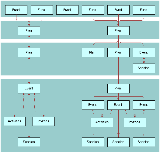

        A MedEd plan is a database record in which you specify common funding for a group of MedEd events that share a common objective. Each MedEd event can be funded by up to one MedEd plan for each event team member who is responsible for each event. Using the MedEd Activities view, you can track costs associated with each event. Because these events are automatically aggregated by plan, you can compare actual expenditures with MedEd plans across sales divisions.
        The following figure shows the possible relationships between MedEd funds, master plans, subplans, events, sessions, activities, and invitees.
        Relationships Between Funds, Plans, Events, Sessions, Activities, and Invitees
