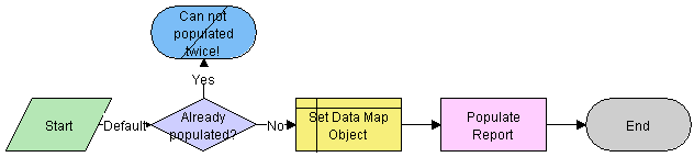

                            6. Click Populate Report.
                              This starts the LS Medical Product Issue Populate Report workflow, which copies data from the product issue according to the report type. For more information about the workflow, see LS Medical Product Issue Populate Report Workflow.

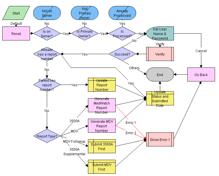

                                      Generating Regulatory Report Numbers and Submitting Reports
                                      When you generate a 3500A or MDV initial report:
                                      • The report number is generated and filled in
                                      • The Status field changes to Submitted
                                      • The fields in the regulatory report record become read-only (except for the Sub Status field)
                                      Only the primary owner of the regulatory report can generate the report number and submit the report.
                                      This task is a step in Process of Regulatory Reporting.
                                      To generate and submit a regulatory report
                                      1. Make sure the application is running on a server database.
                                        You cannot generate a report number on the Siebel Mobile Web Client.
                                      2. Navigate to Regulatory Reports screen, then the My Regulatory Reports view.
                                      3. In the Regulatory Report List, drill down on a regulatory report with status of In Progress.
                                      4. Click Generate.
                                        This starts the LS Medical Product Issue RR Submit workflow, which authenticates the user, adds a number for the regulatory report, changes the status to Submitted, and makes all fields except Sub Status read-only.
                                        For more information about the workflow, see LS Medical Product Issue RR Submit Workflow.
                                      5. To submit the regulatory report to the FDA, click eMDR Queue.
                                        This changes the Sub Status of the report to eMDR and places the report in the queue to be sent to the FDA at the end of the month. If you want to submit the report immediately, follow the instructions outlined in Transmitting Electronic Medical Device Reporting Immediately.

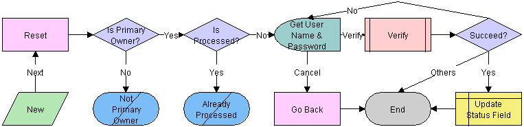

                                            Reopening a Regulatory Report
                                            If you want to make a change in a generated (submitted) regulatory report record, you need to reopen it. Only the primary owner of the regulatory report can reopen it.
                                            When you reopen a report:
                                            • The Status field changes to Reopen
                                            • The fields in the regulatory report record can be edited
                                            To reopen a regulatory report
                                            1. Navigate to Regulatory Reports screen, then the Regulatory Report List view.
                                            2. In the Regulatory Report List, drill down on a regulatory report with status of Submitted.
                                            3. Click Reopen.
                                              This starts the LS Medical Product Issue RR Reopen workflow, which authenticates the user and changes the status of the report to Reopen.
                                              For more information about the workflow, see LS Medical Product Issue RR Reopen Workflow.
                                                  This workflow is initiated from the Populate button on the Regulatory Reports view of the Product Issues screen.
                                                  The workflow appears in the following figure.
                                                  Workflow Description
                                                  This workflow performs the following actions:
                                                  1. Checks if current record has already been populated. If it has, the workflow ends.
                                                  2. Sets the data map object according to the report type.
                                                    The data map objects are:
                                                    • LS Medical PI Populate Report - 3500A
                                                    • LS Medical PI Populate Report - 3500 Supplemental
                                                    • LS Medical PI Populate Report - MDV Initial
                                                    • LS Medical PI Populate Report - MDV Follow-up
                                                  3. Populates the report from the product issue according to the data map object.
                                                    This workflow is initiated from the Generate button on the Regulatory Reports screen.
                                                    1. Checks if the application is running on a server database. If not, the workflow ends.
                                                    2. Checks if the user is the primary owner. If not, the workflow ends.
                                                    3. Checks if the record has already been processed. If it has, the workflow ends.
                                                    4. Calls the LS Medical User Verification workflow. If the authentication does not pass, the workflow ends.
                                                    5. Checks if the parent product issue already has a report number.
                                                      If the product issue. . . and the Report Type Is. . . Then. . .
                                                      Has a report record with a report number
                                                      Use the same number for the report being submitted.
                                                      Does not have a report record with a report number
                                                      3500A or MDV
                                                      Generate a new report number.
                                                      3500A Supplemental or MDV Follow-up
                                                      The workflow ends.
                                                    6. Sets the status of the report to Submitted.
                                                      This workflow is initiated from the Reopen button on the Regulatory Reports screen.
                                                      1. Checks if the user is the primary owner. If not, the workflow ends.
                                                      2. Checks if the record has already been processed. If it has, the workflow ends.
                                                      3. Calls the LS Medical User Verification workflow. If the authentication does not pass, the workflow ends.
                                                      4. Sets the status of the report to Reopen.
