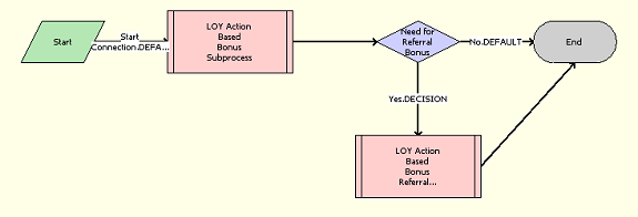

    LOY ABB New Member Process Workflow
    The LOY ABB New Member Process workflow, shown in the following image, calls the LOY Action Based Bonus Subprocess, querying for Part Number equals Registration Bonus. If needed, then it also calls LOY Action Based Bonus Referral SubProcess to:
    • Create whether a new transaction has an action-based bonus of the type Registration Bonus.
    • Check whether there is need to create a referral-bonus transaction.
    Workflow Description. This workflow performs the following actions:
    • LOY Action Based Bonus Subprocess. This step calls a subprocess called LOY Action Based Bonus Subprocess which creates a new transaction for an Action Based Bonus of the type Registration Bonus.
    • Need for Referral Bonus. This step ends the workflow if a referral bonus is not required.
    • LOY Action Based Bonus Referral SubProcess. If Referral Bonus is required, then this step calls LOY Action Based Bonus Referral SubProcess, which creates a new transaction that gives a bonus to the referring member.

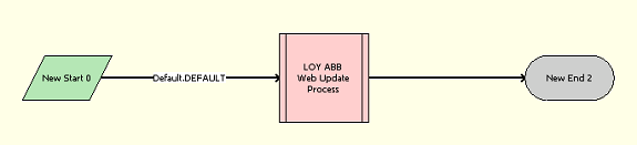

      LOY ABB Web Update Process Workflow
      The LOY ABB Web Update Process workflow, shown in the following image, calls LOY Action Based Bonus Subprocess, querying for Part Number equals Registration Bonus, to create a new transaction that gives an action-based bonus of the type Web Update Bonus.
      Workflow Description. This workflow performs the following action:
      • LOY Action Based Bonus Subprocess. This step calls called LOY Action Based Bonus Subprocess, which creates a new transaction to give an action-based bonus of the type Web Update Bonus.

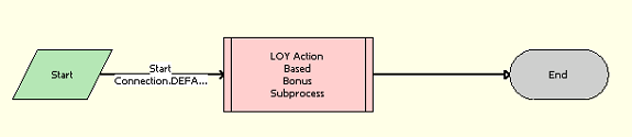

            LOY Action Based Bonus Subprocess Workflow
            The LOY Action Based Bonus Subprocess workflow, shown in the following image, creates two types of action based bonuses.
            • When called by LOY ABB New Member Process, it creates a new transaction to provide an action-based bonus of the type Registration Bonus.
            • When called by LOY ABB Web Update Process, it creates a new transaction to provide an action-based bonus of the type Web Update Bonus.
            • Retrieve Member Data. This step retrieves member data.
            • Retrieve Product Id. This step retrieves Product Id.
            • Create ABB Transaction. This step creates an action-based bonus transaction of the type Registration Bonus when called by LOY ABB New Member Process and of the type Web Update Bonus when called by LOY ABB Web Update Process.

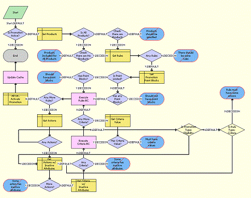

              LOY Activate Promotion Process Workflow
              The LOY Activate Promotion Process workflow, shown in the following image, is invoked when a promotion is activated. It validates whether the minimum necessary rules, criteria, and actions required by the promotion are defined.
              • Is Promotion Active? If the promotion is active, then this step ends the workflow. Otherwise, this step calls the next step, Get Products.
              • Get Products. This step queries for the Products.
              • Is All Products? This step checks whether the Product Inclusion Rule is All Products.
              • Check there are No Products. If the product inclusion rule is All Products, then this step checks whether there are any products associated with the promotion. If there are products, then it displays an error message saying that there are products associated with the promotion but the product inclusion rule is All Products. Otherwise, it calls the step Get Rules.
              • Check there are Products. If the product inclusion rule is not All Products, then this step checks whether there are any products associated with the promotion. If there are no products, then it displays an error message saying there are no products associated with the promotion but the product inclusion rule is either Include or Exclude Products. Otherwise, it calls the step Get Rules.
              • Get Rules. This step retrieves the rules.
              • Any Rules. This step checks if there are any rules. If there are no rules, then it displays an error message saying the promotion has no rule defined for it. Otherwise, it calls the next step, Get Promotion Point Blocks.
              • Get Promotion Point Blocks. This step retrieves the point blocks associated with the promotion.
              • Is Point Limited? This step checks whether the promotion is a point-limited promotion.
              • Has Point Blocks? If the promotion is point-limited, then this step checks whether it has any point blocks. If it does not have point blocks, then this step displays an error message saying there are no point blocks assigned to the point limited promotion. Otherwise, it calls the step Execute Rules BC.
              • Has any Point Blocks? If the promotion is not point-limited, then this step checks whether it has any point blocks. If it has point blocks, then this step displays an error message saying there are point blocks assigned to the unlimited points promotion. Otherwise, it calls the step Execute Rules BC.
              • Execute Rules BC. This step calls the method BCNextRecord of the SIA BC Utility Service Business Service, which retrieves the next record in the business component.
              • Any More Rules? If a rule exists, then this step calls Get Actions. Otherwise, it calls the step All OK. Activate Promotion.
              • Get Actions. This step retrieves the actions of the rule.
              • Any Actions? If any Action exists, then this step calls the step Get Actions w/ Inactive Attributes. Otherwise, it calls the step Is Promotion Type: Eligibility.
              • Is Promotion Type: Eligibility. This step checks the promotion type. If it is of type Eligibility, then this step calls the step Get Actions w/ Inactive Attributes. Otherwise, it calls Is Rule Type: Criteria.
              • Is Rule Type: Criteria. This step checks the rule type. If it is of type Criteria, then this step calls the step Get Actions w/ Inactive Attributes. Otherwise, it displays an error message saying the promotion rule does not have any action defined.
              • Get Actions w/ Inactive Attributes. This step gets actions that have an attribute id specified, but that have the active flag for the corresponding attribute as N (which means inactive) or NULL (which means deleted).
              • More Actions? If any actions with inactive attributes exist, then this step displays an error message saying that the action refers to an attribute definition that is either inactive or is no longer available. Otherwise, it calls the next step, Get Criteria w/ Inactive Attributes.
              • Get Criteria w/ Inactive Attributes. This step gets criteria that have an attribute id specified, but that have the active flag for the corresponding attribute as N (which means inactive) or NULL (which means deleted).
              • Any Criteria? If any criteria with inactive attributes exist, then this step displays an error message saying that the criteria refer to an attribute definition that is either inactive or is no longer available. Otherwise, it calls the step Execute Criteria BC.
              • Execute Criteria BC. This step calls the method BCNextRecord of the SIA BC Utility Service Business Service, which retrieves the next record in the business component.
              • Any More Criteria? If any criteria exist, then this step calls the next step, Get Criteria Value. Otherwise, it calls Execute Rules BC.
              • Get Criteria Value. This step retrieves the criterion value.
              • Has Criteria Value? If the criterion does not have any value, then this step displays an error message saying that the criterion has no criteria values specified but is of type Compare to Values. Otherwise, it calls the step Execute Criteria BC.
              • All OK. Activate Promotion. This step activates the promotion.
              • Update Cache. This step calls the method Update Cache of the LOY Cache Manager Update Business Service, which updates the cache.

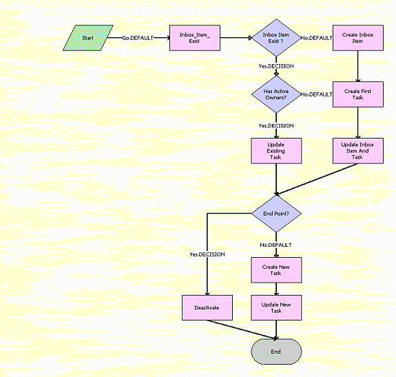

                LOY Approval Process Workflow
                The LOY Approval Process workflow, shown in the following image, approves point blocks and transactions.
                • Inbox_Item_Exist. This step calls the method InboxItemExist of the LOY Approval Process Business Service, which checks whether the inbox item exists and returns the Inbox item Id.
                • Inbox Item Exist? If inbox item exists, then this step checks whether there are active owners. Otherwise, it calls the step Create Inbox Item.
                • Has Active Owners? If there are active owners for the inbox item, then this step calls the step Update Existing Task. Otherwise, it calls the step Create First Task.
                • Create Inbox Item. This step calls the method CreateInboxItem of the LOY Approval Process Business Service, which creates the inbox item.
                • Create First Task. This step calls the method CreateNewTask of the LOY Approval Process Business Service, which creates the task for the inbox item.
                • Update Inbox Item And Task. This step calls the method UpdateInboxItemAndTask of the LOY Approval Process Business Service, which updates the owner information for the task.
                • Update Existing Task. This step calls the method UpdateExistingTask of the LOY Approval Process Business Service, which updates the owner information for the task.
                • End Point? This step checks if the status is at the last step of the approval process. If so, then it calls the next step, Deactivate. Otherwise, it calls the step Create New Task.
                • Deactivate. This step calls the method DeactivateTask of the LOY Approval Process Business Service, which deactivates all the active Inbox Tasks for the given Inbox Item.
                • Create New Task. This step calls the method CreateNewTask of the LOY Approval Process Business Service, which creates a new item task for the object and deactivates all the active tasks.
                • Update New Task. This step calls the method UpdateNewTask of the LOY Approval Process Business Service, which updates the newly created item task with the values of Inbox Name and Start Working Time.

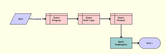

                  LOY Batch Redemption Process Workflow
                  The LOY Batch Redemption Process workflow, shown in the following image, creates a redemption batch transaction for all the members whose point balance is greater than the defined threshold value.
                  • Query Program. This step queries the Threshold Point, Partner Id and Program Id fields.
                  • Query Point Type. This step queries the Point Internal Name field.
                  • Query Product. This step queries the Product Id field.
                  • Batch Redemption. This step calls the method BatchRedemtion of the LOY Redemption Service (Business Service) which creates a redemption batch transaction.

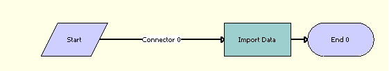

                    LOY Bulk Action Process Workflow
                    The LOY Bulk Action Process workflow, shown in the following image, is used by the Bulk Administration screen, which is launched in asynchronous mode for performing bulk actions.
                    • Import Data. This step calls the Process method of the Business Service- LOY Member Admin Service, which processes the actions of the promotions.

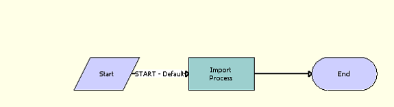

                      LOY Bulk Import Accrual Process Workflow
                      The LOY Bulk Import Accrual Process workflow, shown in the following image, is used by Bulk Accrual Import process to validate that there are records in the staging table. You can modify this workflow to include custom validations.
                      • Import Process. This step calls the ImportAccruals method of the LOY Bulk Accrual Service Business Service, which validates that there are records in the staging table.

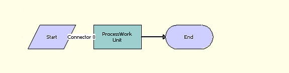

                        LOY Bulk Member Admin Process Workflow
                        The LOY Bulk Member Admin Process workflow, shown in the following image, is called in asynchronous mode for each work unit used in bulk member administration. For more information about work units, see About Bulk Loyalty Membership Administration.
                        • ProcessWorkUnit. This step calls the ProcessWorkUnit method of the LOY Member Admin Service business service, which processes the subset of member administration records that is passed to the workflow by the LOY Member Admin Integration Object.

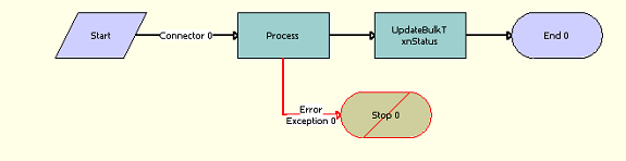

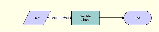

                          LOY Bulk Simulation Process Workflow
                          The LOY Bulk Simulation Process workflow, shown in the following image, simulates processing of multiple transactions received as input from an XML/CSV file.
                          1. Process. This step calls the method GetPropSetFromFile of the LOY Member Services Business Service, which reads the XML/CSV file.
                          2. UpdateBulkTxnStatus. This step calls the method UpdateBulkTxnStatus of the LOY Member Services Business Service, which updates the status to Processed.
                          3. Stop 0. This step generates an error, if the file read process fails.

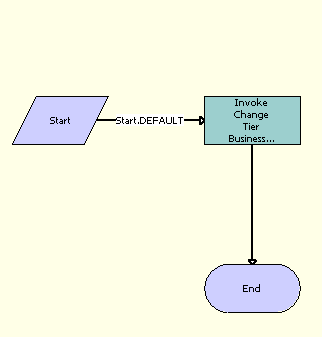

                                LOY Change Member Tier Workflow
                                The LOY Change Member Tier workflow, shown in the following image, invokes a business service method to change the tier.
                                • Invoke Change Tier Business Service. This step calls the method ChangeTier of the LOY Change Member Tier Service Business Service, which makes the tier changes.

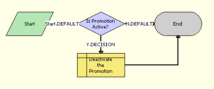

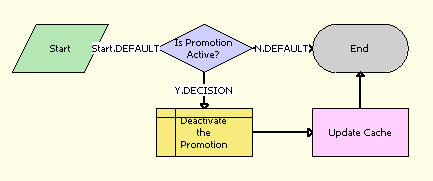

                                  LOY Deactivate Promotion Process Workflow
                                  The LOY Deactivate Promotion Process workflow, shown in the following image, makes a promotion inactive and removes it from the cache.
                                  • Is Promotion Active. If the promotion is active, then this step calls Deactivate the Promotion. Otherwise, it ends the workflow.
                                  • Deactivate The Promotion. This step makes the promotion inactive.
                                  • Update Cache. This step calls the Update Cache method of the LOY Cache Manager Update Business Service, which removes the promotion from the cache.

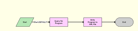

                                    LOY EAI Export Program Workflow
                                    The LOY EAI Export Program workflow, shown in the following image, enables you to export program data from a third-party application into your Siebel Business Application through the Siebel EAI Adapter. This workflow can also be used to move Loyalty data, such as Loyalty Promotion Rules, from the development to the production environment. It is a sample workflow that you can modify to suit your business requirements.
                                    • Query for Program. This step calls the Query method of EAI Siebel Adapter Business Service, which retrieves the program information.
                                    • Write Program to XML File. This step calls the WriteEAIMsg method of the EAI XML Write to File Business Service, which writes the information to the XML file.

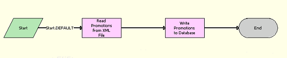

                                            LOY EAI Import Promotion Workflow
                                            The LOY EAI Import Promotion workflow, shown in the following image, allows you to import data for one or more promotions into a Siebel Loyalty program through the Siebel EAI Adapter. You can use this workflow to move Siebel Loyalty promotion data from the development to the production environment. It is a sample workflow that you can modify to suit your business requirements.
                                            • Read Promotions from XML File. This step calls the ReadEAIMsg method of the EAI XML Read from File Business Service, which interprets the specified .xml file as an EAI message, parses it, and returns the promotion data in the output property set.
                                            • Write Promotions to Database. This step calls the Upsert method of the EAI Siebel Adapter Business Service, which either inserts or updates the promotion data.

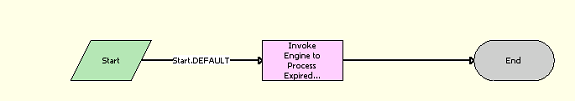

                                                  LOY Engine - Process Expired Accruals Workflow
                                                  The LOY Engine - Process Expired Accruals Workflow workflow, shown in the following image, processes an expired accrual on the real-time component.
                                                  • Invoke Engine to Process Expired Accruals. This step calls the method ProcessObject of the LOY Processing Engine Business Service, which processes the expired accrual.

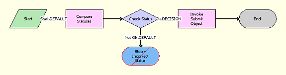

                                                    LOY Engine - Process Object Workflow
                                                    The LOY Engine - Process Object workflow, shown in the following image, submits a component request to the real-time processing engine component to process the object.
                                                    • Compare Statuses. This step calls the Echo method of the Workflow Utilities Business Service, which compares the Required Status with the Object Status
                                                    • Check Status. If the previous step returns true, then this step calls the Invoke Submit Object step. Otherwise, it stops.
                                                    • Invoke Submit Object. This step calls the SubmitObjectForProcessing method of the LOY Processing Engine Business Service, which submits the object to the real time processing engine.
                                                    • Stop.Incorrect Status. This step displays an error message saying that the selected record cannot be submitted for processing.

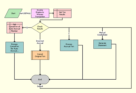

                                                          LOY Engine - Process Transaction Workflow
                                                          The LOY Engine - Process Transaction workflow, shown in the following image, processes a transaction on the real-time component.
                                                          • Invoke Engine to Process Transaction. This step calls the method ProcessObject of the LOY Processing Engine Business Service, which invokes the Loyalty Engine in real-time mode to process the transaction.
                                                          • Get Txn Results. This step retrieves transaction results, such as transfer transaction Id, transaction status, transaction type, and so on.
                                                          • Check Results. This step checks the results of the transaction and takes appropriate step.
                                                          • Get CancelTxn of Auto Accrual Member. If the transaction type is Redemption, the transaction subtype is Cancellation, and the transaction status is Processed, then this step retrieves the transaction Id of the cancelled transaction.
                                                          • Process CancelTxn for Auto Accrual Member. This step processes the transaction.
                                                          • Cancel Original Txn. If the transaction subtype is Incorrect Accrual and the status is Processed, then this step calls the subprocess LOY Cancel Transaction Process, which cancels the Transaction.
                                                          • Process Accrual Txn. If transfer transaction Id is not NULL and transaction status is Processed and transaction subtype is Auto Accrual or Transfer, then this step calls the method ProcessObject of the LOY Processing Engine business service, which processes the transaction.
                                                          • GenerateStatement. If the transaction subtype is Manual Credit or Manual debit, then this step calls the method GenerateStatement of the LOY Statement business service, which generates the statement.
                                                            LOY Engine - Simulate Object Workflow
                                                            The LOY Engine - Simulate Object workflow, shown in the following image, simulates the Promotions by evaluating its actions. It uses transactional data from an XML file and does not perform any DML operations.
                                                            • Simulate Object. This step calls the method SimulateObject of the LOY Processing Engine Business Service, which simulates the actions of the promotions.

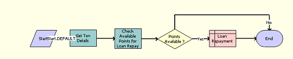

                                                                      LOY Loan Repayment Workflow
                                                                      The LOY Loan Repayment workflow, shown in the following image, creates a loan repayment transaction for members, if they have sufficient point balance to repay the loan.
                                                                      • Get Txn Details. This step calls the method Echo of the Workflow Utilities Business Service, which retrieves the transaction details.
                                                                      • Check Available Points for Loan Repay. This step calls the method AvailPtsForLoanRepay of the LOY Customer Action Business Service, which calculates the points available for Loan repayment.
                                                                      • Points Available? If no points are available, then this step ends the workflow.
                                                                      • Loan Repayment. If points are available, then this step creates a loan repayment transaction.

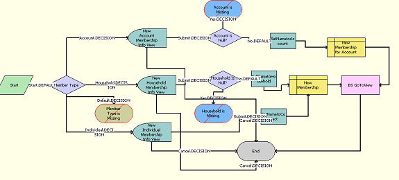

                                                                        LOY Member Enrollment Process Workflow
                                                                        The LOY Member Enrollment Process workflow, shown in the following image, processes new member enrollments.
                                                                        • Member Type. This step checks the Member Type and redirects members to the appropriate views. If the Member Type is not given, then it displays an error message saying the member type is missing.
                                                                        • New Account Membership Info View. This interactive step displays the LOY Enroll Program Account Member Detail View (eApps). If the user clicks Cancel, then the workflow ends. If the User clicks Submit, then this step calls the step Account is Null?
                                                                        • Account is Null? This step checks whether the Account Is Null. If it is Null, then it displays an error message saying the account is missing. Otherwise, it calls the step SetNametoAccount.
                                                                        • SetNametoAccount. This step calls the method Echo of the Workflow Utilities Business Service, which sets the name for the member.
                                                                        • New Membership for Account. This step adds the new member to the account.
                                                                        • New Household Membership Info View. This interactive step displays the LOY Enroll Program Household Member Detail View (eApps). If the user clicks Cancel, then the workflow ends. If the user clicks Submit, then it calls the step Household is Null?
                                                                        • Household Is Null? This step checks whether the Account Is Null. If it is Null, then it displays an error message saying that household is missing. Otherwise, it calls the step SetNametoHousehold.
                                                                        • SetNametoHousehold. This step calls the method Echo of the Workflow Utilities Business Service, which sets the name for the member.
                                                                        • New Individual Membership Info View. This interactive step displays the LOY Enroll Program Member Detail View (eApps). If the user clicks Cancel, then the workflow ends. If the user clicks Submit, then it calls the step SetNametoContact.
                                                                        • SetNametoContact. This step calls the method Echo of the Workflow Utilities Business Service, which sets the name for the member.
                                                                        • New Membership. This step adds the member to the Household or Contacts list.
                                                                        • BS GoToView. This step calls the method GotoView of the CUT eSales Order Entry Toolkit Service Business Service, which navigates to the view LOY Member List View (eApps).

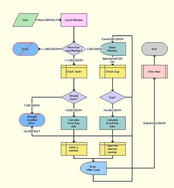

                                                                            LOY Optin Promotion Process Workflow
                                                                            The LOY Optin Promotion Process workflow, shown in the following image, is used by the eLoyalty customer application. It enables users to enroll in a promotion.
                                                                            • Count Member. This step calls the method GetBCCount of the CUT eSales Order Entry Toolkit Service Business Service, which returns the number of members in the Contact BC.
                                                                            • More than one Member? If the number of members is less than one, then this step displays an error message saying that none of the user’s memberships qualify for this promotion, so the user should select another promotion. If the number of members is equal to 1, then it calls the step Check Optin. If the number of members is greater than 1, then it calls the step Select Member.
                                                                            • Check Optin. If the number of members is equal to 1, then this step queries if the member has already opted In.
                                                                            • Already Optin? If the member has already opted in, then this step displays an error message saying the member is already enrolled into this promotion. Otherwise, it calls the step Calculate Enrol Exp date.
                                                                            • Calculate Enrol Exp date. This step calls the method CalculateEnrollmentExpiryDate of the LOY Member Services Business Service, which calculates the Expiry Date for the enrollment.
                                                                            • Optin a member. This step enrolls the member into the promotion.
                                                                            • Select Member. This interactive step displays the LOY Optin Promotion View (eApps). After the user selects a member, it calls the step Check Dup.
                                                                            • Check Dup. This step checks whether the member has already opted in.
                                                                            • Dup? If it is a duplicate, then this step displays an error message saying the member is already enrolled in this promotion. Otherwise, it calls the step Calculate Enroll Exp Date.
                                                                            • Calculate Enroll Exp Date. This step calls the method CalculateEnrollmentExpiryDate of the LOY Member Services Business Service, which calculates the Expiry Date for the enrollment.
                                                                            • Optin the selected member. This step enrolls the member in the promotion.
                                                                            • Enter Offer Code. This interactive step displays the LOY Offer Code View (eApps). If the user clicks Cancel, then it calls the interactive step Select Member. If the user clicks Submit, then it calls the step Goto View.
                                                                            • Goto View. This step calls the subprocess LOY Optin Promotion Sub Process, which displays LOY Member Promotions View (eApps).

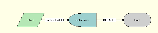

                                                                              LOY Optin Promotion Sub Process Workflow
                                                                              The LOY Optin Promotion Sub Process workflow, shown in the following image, is used by the eLoyalty customer application. It enables users to enroll in a promotion.
                                                                              • Goto View. This interactive step displays LOY Member Promotions View (eApps).

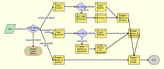

                                                                                          LOY User Registration Member Process Workflow
                                                                                          The LOY User Registration Member Process workflow, shown in the following image, creates and registers a new member.
                                                                                          • Check Member Type. This step checks the Member Type and calls the following steps accordingly. If the member type is not given, then it displays an error message saying that member type is missing.
                                                                                          • Insert Account. This step inserts the account details into the business component.
                                                                                          • Dup Addr? This step checks whether the address already exists. If it already exists, then it calls the step Assoc Addr to Account. Otherwise, it calls Insert Address.
                                                                                          • Assoc Addr to Account. This step associates the address with the account.
                                                                                          • Set Primary. This step sets the primary address for the account.
                                                                                          • Insert Address. This step inserts the address for the account.
                                                                                          • Create Member of Account. This step creates the member of the type Account.
                                                                                          • Insert Household. This step inserts the household details.
                                                                                          • Dup Addr 2? This step checks whether the address already exists. If it already exists, then it calls the step Assoc Address to Household. Otherwise, it calls Insert Address2.
                                                                                          • Assoc Address to Household. This step associates the address with the household.
                                                                                          • Set Primary for Household. This step sets the primary address for the household.
                                                                                          • Insert Address2. This step inserts the address for the household.
                                                                                          • Create Member of Household. This step creates the member of the type Household.
                                                                                          • Create Member of Contact. If the Member Type is Individual, then this step creates a member of type Individual.
                                                                                          • Insert Travel Profile. This step associates a travel profile with the member.
