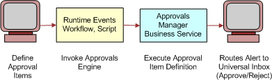

        Automating an approval process involves the following steps:
        Interaction of the Approvals engine parts is shown in the following figure.
