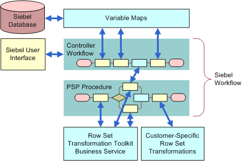

The PSP engine is comprised of the pieces shown in the following figure and described in the following topics:
Controller Workflow
A controller workflow invokes the PSP engine every time a PSP procedure is called. The controller workflow insulates the PSP procedure from the calling context. The various calling contexts, such as Siebel Configurator, a product picklist, or a Web service, each have separate controller workflows. The PSP Driver Workflow Process is an example of a prebuilt controller workflow. You can configure your own controller workflows to meet your organization’s particular needs.
While the PSP procedure transforms row sets in memory, the controller workflow passes those row sets to the PSP procedure and then determines what to do with the PSP procedure’s output. The typical flow is:
An end user clicks a button or makes some other choice in the interface.
This end-user action triggers a signal which executes the controller workflow.
The controller workflow establishes the inputs for the PSP procedure by finding data and constructing this data into row sets. The controller workflow can use the variable maps mechanism to construct the row sets.
The controller workflow calls the PSP procedure and passes the inputs to it.
The PSP procedure transforms the inputs and sends the transformed row set back to the controller workflow.
The controller workflow determines what to do with these transformed rows. For example, it might display the transformed rows on the screen or write them to the database.
The PSP procedure’s only function is to transform row sets in memory. The controller workflow executes any other actions.

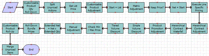

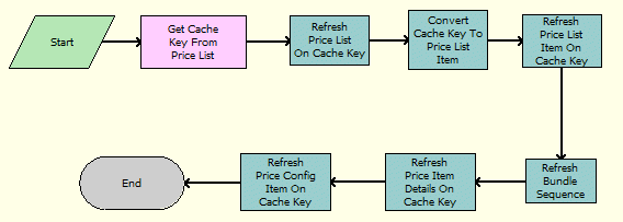

A PSP procedure is any workflow that uses methods from the Row Set Transformation Toolkit business service. These methods of the Row Set Transformation Toolkit business service are called PSP transforms. A transform, such as the Simple Look-Up method, processes an input row set. There are a number of transforms that process input row sets in different ways. For example, the Simple Look-Up transform uses a simple search expression to look up each input row in a business component, while the Split transform takes an input row set, evaluates a condition for each of its rows, then splits the input row set into two output row sets.
Each step in a PSP procedure is a parameterized call to a transform method. A PSP procedure can call another PSP procedure as a subprocess, to provide for modularization of logic.
The Siebel Business Process Designer interface is used to create both the PSP procedure and the controller workflow that invokes it. Like any workflow process, a PSP procedure can make use of any standard Siebel Workflow feature.
The following figure shows an example of a PSP procedure used in pricing. Each step is a parameterized call to a method in the Row Set Transformation Toolkit.
Notice that one of the steps splits the input row set into multiple temporary subsets. Later steps perform logic on these subsets. The last step merges these subsets, so they form a single row set again.

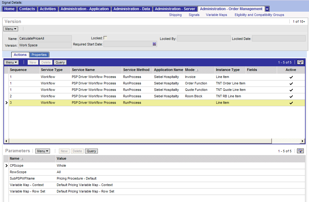

A controller workflow is the invocation mechanism for each PSP procedure. The workflow called PSP Driver Workflow Process is the default controller workflow. When a signal calls the controlling workflow for a process, it passes the names of the PSP procedures to the PSP Driver Workflow.
Arguments for the default PSP Driver Workflow are shown in the following figure. PSP Driver Workflow is set as the controller workflow for the signal CalculatePriceAll in the Service Name field of the Actions tab.
The PSP Driver Workflow acts as the controller workflow for the pricing and eligibility PSP procedures. It calls the Context Service to construct a property set called Row Set containing the selected rows from the source object (Quote, Order, Agreement, or Customizable Product). It also calls the Context Service to construct a property set called Context that contains header-level information shared by all rows (for example: Account Type, Credit Score). It then invokes the PSP procedure specified in its input arguments. The PSP procedure updates and returns a new version of Row Set. Finally, the controller workflow instructs the Context Service to save any changes in Row Set back to the source object.
The PSP Driver Workflow, shown in the following figure, does the following:
Asks the Context Service to generate two property sets (row sets): the shared Context and the Row Set containing individual line items. These are representations of the Line Item and Header business components using variable maps. For more information about variable maps, see Variable Maps.
Dispatches to the workflow indicated by the process property PSPWorkflowName. For example, in the event the user selected RepriceAll, this step dispatches to the Pricing Procedure - Default workflow to perform all pricing operations.
Synchronizes the updated PSP information back to the input data source (Quote, Order, Agreement, or Customizable Product). The synchronization can be skipped by setting the Sync process property.

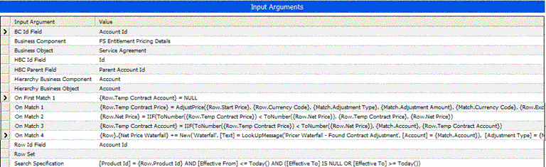

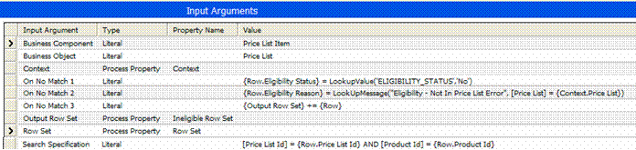

Conditions and Actions for PSP Procedures

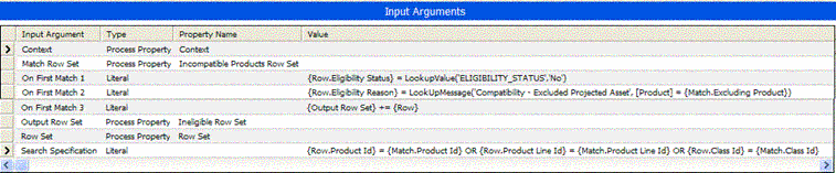

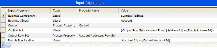

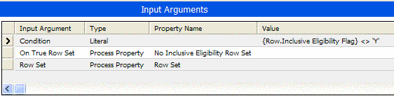

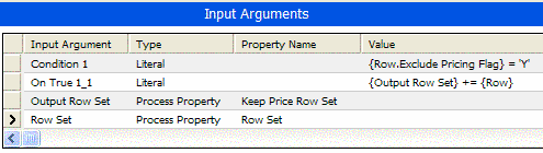

Steps of PSP procedures can call Row Set Transformation Toolkit business service methods. Each Row Set Transformation Toolkit method (transform) performs a parameterized set of actions based on conditions that occur as the method executes.
Conditions and actions for each step are entered as input arguments in Siebel Workflow’s Process Designer in Siebel Tools, as shown in an example in the following figure:
In the Input Argument field, select the condition name.
In the Value field, enter the processing to perform if the condition is true.
You can specify multiple actions for one condition by using a different index number for the condition name. In the following table example, there are multiple actions for the On True 1 condition, with the condition name On True 1_1, On True 1_2, and On True 1_3.
Some Row Set Transformation Toolkit business service methods can include one or more Boolean conditions to which the other conditions refer. In the following figure example, Condition 1 is a Boolean condition which checks the values in the Effective From and Effective To fields. The conditions On True 1_1, On True 1_2, and On True 1_3 are true if this Boolean condition is true.
Actions are executed in the sequence specified by the index on the name. For example, the action for On True 1_1 executes before the action for On True 1_2.

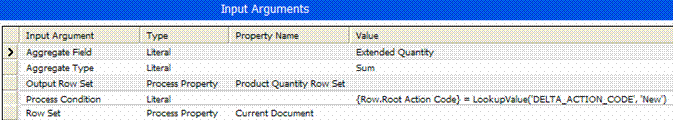

Aggregate Method
The Aggregate method calculates the sum, average, minimum, maximum, or count of subgroups of the input row set.
Arguments
| Input Argument | Description |
Context |
Optional. Property set of variables shared across all rows. |
Row Set |
The set of rows to process. |
Output Row Set |
Output Row Set is always created and contains the aggregation results. Each row contains the Group By fields plus the Aggregate Fields (example: Price List ID, Product ID, Qty). For the Count aggregate type, the output row contains the Group By fields plus a field called Count. |
Process Condition |
A Boolean condition that is evaluated to determine whether to process each row. |
Aggregate Type |
Sum, Avg, Min, Max, or Count. |
Aggregate Field |
The field to aggregate (example: Qty). Required for all types except Count. Multiple fields can be aggregated by specifying a comma-separated list of field names. |
Group By |
Optional. A comma-separated list of row field names. Defines the groups of aggregates. (Example: Price List ID, Product ID). |
Example
The following figure shows an example of arguments for a PSP procedure step named Sum Product Quantity, which calls the Aggregate method.

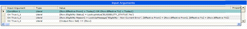

Conditional Action Method
The Conditional Action method evaluates one or more Boolean expression for each row in the row set and performs actions on the row based on whether the conditions are true.
Arguments
Context |
Row Set |
Output Row Set |
Optional. The property set used for output. |
Process Condition |
Condition [1..10] |
Optional. Boolean expressions that must be satisfied to initiate corresponding actions. Executed like an If…Else If…Else If…Else statement. |
On True [1..10]_[1..10] |
Actions to perform if the corresponding condition is true. |
On Default [1..10] |
Actions to perform if none of the conditions is true. |
Example
The following figure shows an example of arguments for a PSP procedure step named Keep Price, which calls the Conditional Action method.

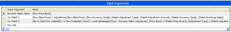

Dynamic Look-Up Method
The Dynamic Look-Up method looks up each input row in a dynamic matrix using a dynamic search expression. For example, it could be used for attribute adjustments.
Arguments
Context |
Row Set |
Output Row Set |
Process Condition |
Dynamic Matrix Name |
The name of the dynamic matrix to query. |
Cache Enabled |
Optional. Whether to cache query results. Y or N. The default is N. |
On First Match [1..20] |
Actions to perform on the first query result for each input row. |
On Match [1..20] |
Actions to perform on every query result for each input row. |
On Last Match [1..20] |
Actions to perform on the last query result for each input row. |
On No Match [1..20] |
Actions to perform if there are no query results for an input row. |
Example
The following figure shows an example of arguments for a PSP procedure step named Matrix Adjustment, which uses the Dynamic Look-Up method.

Hierarchical Look-Up Method
The Hierarchical Look-Up method looks up the closest, best, or accumulated value in an adjustment table for each row by considering each parent in a hierarchy. For example, it could be used to give discounts to companies based on their parent-company discounts.
Arguments
Context |
Row Set |
Output Row Set |
Process Condition |
Hierarchy Business Object |
The business object to query to retrieve the hierarchy (example: Account). |
Hierarchy Business Component |
The business component to query to retrieve the hierarchy (example: Account). |
Row ID Field |
The hierarchical ID field in the input row (example: “Account Id”. |
HBC ID Field |
The ID field of the hierarchy business component (example: “Id”). |
HBC Parent Field |
The parent ID field in the hierarchy business component (example: “Parent Account Id”). |
HBC Visibility Mode |
Optional. The visibility mode of the hierarchy business component query. |
HBC Search Specification |
Optional. An additional search specification that is applied to the hierarchy query. |
Business Object |
The business object to query for matching records (example: Agreement). |
The business component to query for matching records (example: Agreement Item). |
A search expression comprised of business component fields, literals, and variable values from {Context} and {Row}. For example: [Product Id] = {Row.Product Id} AND [Effective From] <=
Today() AND ([Effective To] IS NULL OR [Effective To]
>= Today())
In Memory Search Specification |
Optional. Additional terms that are ANDed with the Search Specification. The In Memory Search Specification is executed in memory. This can be used only if Cache Enabled is Y. |
Cache Search Specification |
Optional. Additional terms that define the key values for the Level 1 cache; for example: [Price List Id] = {Row.Price List Id})
For more information, see About PSP Cache Performance Statistics. |
Sort Specification |
Optional. A comma-separated list of business component fields used to sort the query result. |
Cache Enabled |
Optional. Specifies whether to cache query results. Y or N. The default is N. |
BC ID Field |
The hierarchy object ID field on the query business component (example: Account Id). |
On Match [1..20] |
Implementing Aggregate Functions
The arguments for the Hierarchical Look-Up method are used with the aggregate functions shown in the following table. See the following table for further description.
Table Hierarchical Look-Up Method Aggregate Functions
| Aggregate Function | Approach |
Closest |
On First Match condition, set the output row value to a match record value. |
Minimum |
On Match condition, set the output row value to the value of an expression: {Row.Value} = IIF({Match.Value} < {Row.Value},
{Match.Value}, {Row.Value})
Maximum |
On Match condition, set the output row value to the value of an expression: {Row.Value} = IIF({Match.Value} > {Row.Value},
Accumulated |
On Match condition, set the output row value to the value of an expression: {Row.Value} = {Row.Value} + {Match.Value}
Note: This can be adjusted to support compounding adjustments.
Example
The following figure shows an example of arguments for a PSP procedure step named Hierarchical Contract Adjustment, which uses the Hierarchical Look-Up method.

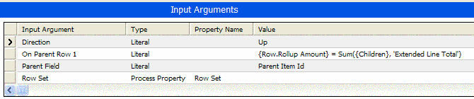

Hierarchical Method
The Hierarchical method processes a hierarchy of input rows from start to end or end to start. For example, it could be used for a customizable product price roll-up.
Arguments
Context |
Row Set |
Output Row Set |
Process Condition |
Row Id Field |
The ID field in {Row} (example: “Id”). |
Parent Field |
The name of the parent ID field that defines the hierarchy in the input row set. |
Direction |
Up or Down. Indicates the direction of traversal of the tree. |
On Top Row [1..20] |
Actions to perform on the first row in each tree. |
On Row [1..20] |
Actions to perform on every row. |
On Parent Row [1..20] |
Actions to perform on every row that has children beneath it in a tree. |
On Leaf Row [1..20] |
Actions to perform on rows that have no children. |
Example
The following figure shows an example of arguments for a PSP procedure step named Customizable Product Roll-Up, which uses the Hierarchical method.

Query Method
The Query method queries a business component and generates a row set.
Arguments
Context |
Output Row Set |
Business Object |
The business object to query. |
The business component to query. |
A search expression comprised of business component fields, literals, and variable values from {Context}. For example: [Account Id] = {Context.Account Id}
For more information, see Logging of Performance. |

Example
The following figure shows an example of arguments for a PSP procedure step named Get Account Address, which uses the Query method.
Row Set Look-Up Method
The Row Set Look-Up method looks up each input row in another row set using a specified search expression. For example, it could be used to check for compatibility.
Arguments
Context |
Row Set |
Output Row Set |
Process Condition |
Match Row Set |
The row set that will be matched with the input row set. |
A search expression comprised of literals and variable values from {Context}, {Row}, and {Match}. For example: {Row.Product Id} = {Match.Product Id}
Actions to perform on the first match for each input row. |
On Match [1..20] |
Actions to perform on every match for each input row. |
Actions to perform on the last match for each input row. |
Actions to perform if there are no matches for an input row. |
Example
The following figure shows an example of arguments for a PSP procedure step named Flag Incompatible Rows, which uses the Row Set Look-Up method.

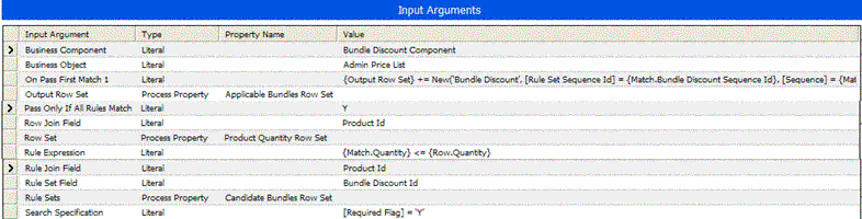

Rule Set Look-Up Method
The Rule Set Look-Up method looks up the rules for each input rule set and tests the rules against the row set. Then it performs actions if the rule set passes or fails. For example, it could be used for identifying applicable bundles or promotions.
Arguments
Context |
Row Set |
Output Row Set |
Process Condition |
Business Object |
The business object to query to retrieve the rules. |
The business component to query to retrieve the rules. |
A search expression comprised of business component fields, literals, and variable values from {Context} and {Row}. For example: [Required Flag] = 'Y' |
Cache Enabled |
Rule Set Field |
The field in the business component that groups the rules into a rule set (example: Promotion Id, Bundle Id). |
Row Join Field |
The field in the {Row} that is joined to a matching rule (example: Product Id). This transform tests all rows that join to see if the rule expression is satisfied. |
Rule Join Field |
The field in the rule business component that is joined to a matching {Row} (example: Product Id). |
Rule Expression |
Optional. A Boolean expression that defines whether a rule is satisfied by a row; for example: "{Match.Min Qty} = 0)
OR {Match.Min Qty} <= {Row.Qty}")
Pass Only If All Rules Match |
Y or N. This indicates whether to execute the On Pass … conditions only if all rules in a rule set pass, or whether to execute those conditions for any rule that is satisfied. |
Row Set Sort Specification |
Optional. A comma-separated list of {Row} field names that determine the sequence in which rows in {Row Set} are processed as they are compared with the rules. This transform is used to make sure that the highest value item is given away in a buy-one-get-one-free scenario. This transform is required for backward compatibility. |
Rule Sets |
A property set containing a list of rule sets to test. Each child property set can contain the following fields:
For example, the list of promotions that requires integrity checking or the list of bundles associated with the current price list. If the [Next Sequence on Pass] field is populated, then the Rule Sets transform skips to that value of [Sequence] if the current rule set passes. If the [Next Sequence on Fail] field is populated, then the transform skips to that value of [Sequence] if the current rule set fails.
Note: There may be multiple sequences of rule sets in the Rule Sets property set. Individual rule-set sequences are identified by the optional [Rule Set Sequence Id] field.
Attributes of the rule set being evaluated are exposed to action syntax as {Rule Set.Value}. |
On Pass First Match |
Occurs for the first row in the row set that matches a rule in a rule set for which the evaluation criteria are satisfied. For 'On Pass … [Rule]' conditions, {Row} and {Match} variables are available to actions. |
On Pass Match |
Occurs for every row in the row set that matches a rule in a rule set for which the evaluation criteria are satisfied. For 'On Pass … [Rule]' conditions, {Row} and {Match} variables are available to actions. |
On Pass Last Match |
Occurs for the last row in the row set that matches a rule in a rule set for which the evaluation criteria are satisfied. For 'On Pass … [Rule]' conditions, {Row} and {Match} variables are available to actions. |
On Fail First Rule |
Occurs for the first rule not satisfied in a failed rule set.
Note: For On Fail … [Rule] conditions, only the {Match} variable is available to actions.
On Fail Rule |
Occurs for each rule that was not satisfied in a failed rule set. |
On Fail Last Rule |
Occurs for the last rule that was not satisfied in a failed rule set. |
Example

Split Method
The Split method splits an input row set into two output row sets by evaluating a condition for each row.
Arguments
Context |
Row Set |
Condition |
A Boolean expression that references {Context} and {Row} field values. |
On True Row Set |
The row set to which rows are moved if Condition evaluates to True. |
Example
The following figure shows an example of arguments for a PSP procedure step named Inclusive Eligibility, which uses the Split method.

Row Set Transformation Toolkit Methods for PSP Cache Refresh
The Row Set Transformation Toolkit methods listed in the following table, with their corresponding input arguments and output arguments support refreshing of the PSP cache:
Table Row Set Transformation Toolkit Methods for PSP Cache Refresh
| Method | Description | |
Get Cache Key |
Checks the cache key definitions for the specified business component and constructs a property set containing the cache key values for each selected row in the active business component. This enables multiselect when clearing cache entries (such as price lists). |
In: Business Component Name |
Out: Row Set |
Refresh Cache |
Clears the entire PSP cache. |
Refresh BC |
Clears all PSP cache entries for the specified business component.
Note: Refresh BC does not clear the cache if the business component has a cache key defined.

Create a workflow that does the following:
Calls the Get Cache Key method to determine the selected cache key values.
Invokes the Refresh BC On Cache Key method for each business component that shares the same cache key. The following figure shows an example of a Clear Cache workflow.
