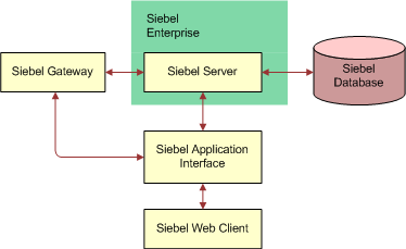

Overview of Siebel CRM Server Architecture
The following illustrates a simplified architecture for the server elements in your Siebel deployment, after you have initially installed and configured the software. For a more detailed illustration, see Siebel Deployment Planning Guide.
The Siebel CRM installation and configuration process requires multiple tasks that you perform in a general sequence that depends on your installation case. For more information, see:

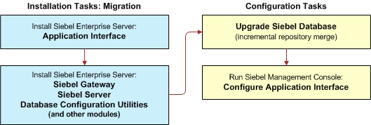

Roadmap for Installing Siebel CRM in a Migration Installation Case (Existing Installation)

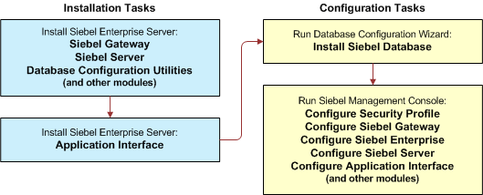

Roadmap for Installing Siebel CRM for a New Deployment
Use this roadmap to guide you in performing the installation and configuration tasks for deploying Siebel CRM, where there is no existing Siebel CRM installation and no existing Siebel database.
The following figure presents a simplified view of the installation and configuration tasks for Siebel CRM server modules for a new deployment.
Unless you use another authentication method, a Siebel database must exist before you can configure the Siebel CRM modules, in order to provide an authentication framework for the configuration tasks. You install Database Configuration Utilities with the first Siebel Server.
The installation process for Siebel CRM for a new deployment requires multiple tasks that you perform in the following general sequence:

The following figure presents a simplified view of the installation and configuration tasks for Siebel CRM server modules for a migration deployment.
This roadmap only summarizes the migration installation process and does not include details about required tasks. For example, you must do the following tasks after performing the migration installation tasks. See also Additional Tasks for Migration Installations.
Upgrade the database client. You might need to upgrade the database client software to a supported version for Siebel CRM, as noted in the Certifications tab on My Oracle Support. Also update the database client installation path in the defined environment variables. See About Configuring Siebel CRM.
Run Incremental Repository Merge. Customers must run Incremental Repository Merge. Before doing this, you must have installed at least one Siebel Server with Database Configuration Utilities and installed Siebel Tools. For more information about Incremental Repository Merge, see Siebel Database Upgrade Guide.
Reset passwords in Siebel Gateway and on the Siebel Server. Customers must reset any passwords on the Siebel Gateway that were previously encrypted using encryption other than AES. Such passwords are now encrypted using AES. For more information about reencrypting these passwords, see Siebel Security Guide. See also Additional Tasks for Migration Installations.
The installation process for Siebel CRM in a migration installation case requires multiple tasks that you perform in the following general sequence:
Before performing installation tasks, review all documented requirements and perform any necessary premigration tasks.
See Before You Install Siebel CRM and Additional Tasks for Migration Installations.
Create the network images for all applicable releases of Siebel CRM:
Create a network image for Siebel CRM 17.0.
Create a network image for Siebel CRM 19.12 Update.
Remove the existing configuration on the Web server computer where you previously installed Siebel Web Server Extension (SWSE).
Caution: You must perform this task before you perform the migration installation of Siebel Application Interface for the existing installation of SWSE.See Additional Tasks for Migration Installations and About Configuring Siebel CRM.
For the Siebel Application Interface, install Siebel CRM 17.0 as a migration installation for each existing installation of Siebel Web Server Extension (SWSE). Then install Siebel CRM 19.12 Update.
As part of installation, also specify authentication information and port numbers that will be used by your Siebel CRM deployment. The port numbers must be unique on each installation computer or operating system instance.
For the remaining Siebel Enterprise Server modules, install Siebel CRM 17.0 as a migration installation for each existing installation. Then install Siebel CRM 19.12 Update. Also perform any necessary postmigration tasks.
Note: When you migrate the Siebel Gateway, you also must provide information to allow your existing configurations to migrate. This includes the port number of the existing Siebel Gateway Name Server as well as some Siebel Application Interface settings that you specified in Step 4. (If you installed multiple instances of Siebel Application Interface, then specify the settings that apply to the instance of Siebel Application Interface from which you will run Siebel Management Console.)See Installing Siebel CRM Server Modules. See also Additional Tasks for Migration Installations.
(Optional) Install Siebel Gateway on additional nodes, if you will use clustering.
Verify the installation of Siebel CRM modules.
For Siebel Tools, install Siebel CRM 17.0 as a migration installation for each existing installation. Then install Siebel CRM 19.12 Update. Also perform any necessary postmigration tasks.
Note: When you install Siebel CRM 17.0, Oracle Database XE is installed for use with the local database. You can optionally install the local database with Siebel Tools.See Installing Siebel Web Clients and Siebel Tools. See also Additional Tasks for Migration Installations.
For Siebel Mobile Web Clients (or Developer Web Clients), install Siebel CRM 17.0 as a migration installation for each existing installation. Then install Siebel CRM 19.12 Update. Also perform any necessary postmigration tasks.
Note: When you install Siebel CRM 17.0, Oracle Database XE is installed for use with the local database or sample database, for Siebel Mobile Web Client. You can optionally install the sample database with this client.See Installing Siebel Web Clients and Siebel Tools. See also Additional Tasks for Migration Installations.
Verify the installation of Siebel Tools and Siebel Mobile Web Clients.
Run Incremental Repository Merge on the Siebel database.
See Siebel Database Upgrade Guide.

The following figure presents a simplified view of the installation and configuration tasks for Siebel CRM server modules for an upgrade installation case. You install Database Configuration Utilities with the first installed Siebel Server.
This roadmap only briefly mentions the Siebel database upgrade tasks. Before you upgrade the database, you must have installed at least one Siebel Server with Database Configuration Utilities and installed Siebel Tools. For more information about upgrading, see About Installing in Upgrade Environments and see Siebel Database Upgrade Guide.
