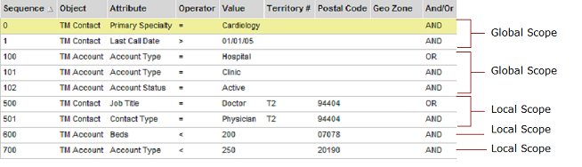

What Is a Scope?
For global conditions, a scope is a set of conditions for the same object type. For local conditions, a scope is a set of conditions for a given object type, territory, postal code, and geo code combination. The following shows five scopes, some global and some local.
Condition Evaluation Within a Given Scope
One important difference between conditions in Siebel Territory Management and ordinary Boolean conditions is that, for a given scope, you must:
Place all the OR conditions first or
Place all the AND conditions first.
You cannot put OR conditions between AND conditions. You cannot put AND conditions between OR conditions. See the following image.
These grouped conditions are evaluated as follows:
A condition that includes only ANDs is evaluated in the usual way. The entire condition is true only if all the subconditions are true.
A condition that includes only ORs is evaluated in the usual way. The entire condition is true if any one of the subconditions is true.
A condition where the ANDs precede the ORs is evaluated as if it were grouped in the following way: 1 AND 2 AND 3 AND 4 OR 5 OR 6 is evaluated as 1 AND 2 AND 3 AND (4 OR 5 OR 6).
A condition where the ORs precede the ANDs is evaluated as if it were grouped in the following way: 1 OR 2 OR 3 OR 4 AND 5 AND 6 is evaluated as (1 OR 2 OR 3 OR 4) AND 5 AND 6.
Condition Evaluation Between Scopes
The AND operator is always automatically applied between global and local conditions. All subconditions must evaluate as true for the entire condition to be true. You cannot use the AND and OR operators between scopes, only within the same scope.
Local conditions for different scopes are handled separately. For example, consider the condition:
A AND B AND c AND d OR e
where A and B are global conditions, c is a local condition, and d and e are also local conditions but in a different scope from c.
It is evaluated as:
[(A AND B) AND c] OR [(A AND B) AND (d OR e)]

As needed, create new Condition records and complete the necessary fields. Some fields are described in the following table.
Field Comments Sequence
The sequence number is supplied automatically.
You can edit the sequence field to reorder conditions, but some hard-coded restrictions apply according to the type of condition. For example, sequence numbers 0–299 are reserved for global conditions. (Global conditions apply to all objects and are not restricted to particular territories, postal codes, or geo zones.) If you edit a sequence field, subsequent sequence numbers are automatically renumbered.
Object
Choose to apply the condition to accounts, contacts, or assets.
Attribute
Choose an attribute. You can configure new attributes using Siebel Web Tools. See Configuring Additional Attributes for Territory Conditions.
Operator
Choose one of the standard operators.
Value
Enter the value used in the condition.
Division
You can use any of these alone or combine Territory with Postal Code or Territory with Geo Zone.
These are used to specify local conditions.
Territory
Postal Code
Geo Zone
And/Or
For information about the And/Or operator, see About Conditions in Siebel Territory Management.
