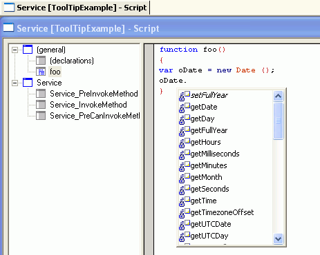

About Script Assist
Script Assist is part of the ST eScript Engine. To help you develop a script, it inspects object definitions, and then makes information about these object definitions available to you. It includes the following functionality:
Syntax highlight. Uses color to highlight reserved words, data types, operators, and other syntax in Siebel VB and Siebel eScript script. You cannot modify these colors. The following table lists the colors that it uses:
Item In the Code Color Name Reserved word or keyword.
Blue
Data Type.
OrangeRed
Operator.
Navy
String literal.
SteelBlue
Delimiter. For Siebel eScript only
Brown
Function. For Siebel VB only.
Magenta
Method list. Displays a list of methods and properties that are available for an object. For more information, see the table that follows on Icons That the Script Assist Window Contains.
Repository inspection. Inspects objects and object types in the repository without requiring you to type a string literal. This functionality results in fewer mistakes in your script. It also understands predefined constants for a business component method.
Favorites. Uses italics to indicate the most frequently used object, method, or property name in the Script Assist window. Favorites exist for only a single Web Tools session. When you log out of Web Tools, it clears these favorites. If you create a new function, then you must add it to the declarations, and then save the script modifications. If you do not do this, then Web Tools does not display the function as a favorite.
Script libraries. Allows you to call a business service function after you declare the business service. You do not declare property sets or make an InvokeMethod call. A script library helps you develop code that is reusable and modular. For more information, see Using Script Libraries with the ST eScript Engine.
Auto complete. Automatically completes an entry after you enter a minimum number of unique characters in the Script Assist window. For example, if you enter
Bus
, then Web Tools automatically enters the wordBusComp
.Auto indent. Maintains a running indent. If you press the Return key or the Enter key, then it inserts spaces and tabs that left-justifies the code.
Tool tips. Allows you to view descriptions of the method arguments that you use.
Includes child scripts. Script Assist can parse a script that you write on a business component, applet, or business service. You can use the Application drop-down list to choose the Siebel application that includes the child script. Script Assist displays the scripts that are written on this application object in the Script Assist window.
Includes scripts you write in the general section. A script that you write in the general section of the script explorer window is available in the Script Assist window. For example, if you write a helper function named Helper in the general section of the current script, and if you start Script Assist, then it includes Helper in a pop-up window.
Using Script Assist with a Custom Siebel eScript Method
If a script references a custom Siebel eScript method on a business component, and if this script does not reside on the same business component that includes this custom method, then Script Assist does not recognize the custom method and cannot display data from it. For example, you create a business component method named MyMethod on the Account business component. You then create a script on the Contact business component that references the MyMethod method. In this example, Script Assist does not include any information about your custom My Method method.

Running Tool Tip is a help feature in the Siebel Script Editor that you can use to write a script. If you enter a method name in the Running Tool Tip window, then it displays the method arguments that you can use with this method. If you enable Script Assist, then Siebel Tools enables Running Tool Tip, by default. For more information, see About Script Assist.
To use Running Tool Tip
Open the Siebel Script Editor.
For more information, see Opening the Siebel Script Editor.
In the Script Editor window, enter a method name followed by an open parenthesis.
Siebel Tools displays the Running Tool Tip window. This window displays the method name and the method arguments. It uses italicized text to suggest an argument. Siebel Tools hides this window after you enter all the required method arguments.
The following image includes the Running Tool Tip window.
How Running Tool Tip Differs from Tool Tips in Script Assist
If you enter a function name followed by a left parenthesis in the Script Editor, then Script Assist or Running Tool Tip shows depending on the type of function you enter.
Running Tool Tip Window
If you enter a simple call expression, then Siebel Tools displays the Running Tool Tip window. A call expression allows you to send anything to the function according to the type of argument. For example, if you use the following code to enter a data object function, then Siebel CRM can send a value that you choose to this function:
Date.SetFullYear
For example, you enter the following code:
var oDate = new Date(); oDate.SetFullYear(
In this example, Siebel Tools displays the following code in the Running Tool Tip window:
oDate.SetFullYear(year, month, date)

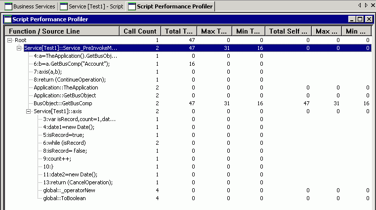

Using the Script Profiler
This topic describes how to use the Script Profiler. It includes the following information:
Overview of the Script Profiler
The Siebel Script Performance Profiler is a part of the ST eScript Engine that allows you to observe and monitor the performance of a script. For brevity, this guide refers to the Siebel Script Performance Profiler as the Script Profiler.
If you start Siebel CRM in debug mode from Siebel Tools, then the Script Profiler gathers and displays data for all executable scripts. It displays data in the Script Performance Profiler window in Siebel Tools and updates this data if a script runs. You can use this data to monitor script performance, identify performance bottlenecks, and compare performance with previous script runs. The Script Profiler allows you to do the following:
Use the Call Tree view. Displays profile data as a tree of function calls. For more information, see Example of the Script Performance Profiler Window.
View function profile and line profile. Line profile data includes the call count and total time spent for each line that runs in a function. Line profile information is available only for a compiled script and is not available for a line that does not run.
Save profile data to file. You can save profile data that the Script Performance Profiler window shows to a text file.
Use the Siebel Script Debugger and the Siebel Script Profiler. You can use the Script Profiler and the Script Debugger at the same time. Profile data is consistent even if the function uses Debugger functionality, such as a breakpoint.
View the script source. Siebel Tools opens the objects that a script references in the Script Editor window. You can double-click a function name or line number to view the script from the Script Performance Profiler window. The View Source option is available only for a compiled script. It is not available for a runtime script.
The following image displays an example of the Script Performance Profiler window. It allows you to examine script performance. It displays a line number for each code line, total time spent to run that line, the number of times Siebel CRM runs the line, and so on.
Description of the Columns in the Script Performance Profiler Window
The following table describes the columns that the Performance Profiler window includes. For the Source Line, Call Count, and Total Time columns, if line profiling is enabled for a function, then the line profile displays as child nodes of a function in the Call Tree view and in the Flat Profile view.
Table Description of Columns in the Script Performance Profiler Window

In Siebel Tools, click the Debug menu, and then click Start.
This step opens the Siebel application in debug mode. If Siebel CRM prompts you for a login, then enter the user name and password, and then click Run. For example, to run a script for the Business Service Simulator, you query for the Service Name and Method Name, and then click Run.
In Siebel Tools, click the View menu, Profiler, and then click Call Tree.
Siebel Tools displays the functions that Siebel CRM calls when it runs a script as a hierarchy in the Script Performance Profiler window. It displays the functions that it calls from other functions as child objects. For an example, see Example of the Script Performance Profiler Window.
In the Script Performance Profiler window, you can do the following:
Navigate between nodes to view the different parameters for a function.
Right-click a node, and then choose a menu item. For more information, see Navigating in the Script Performance Profiler Window.
(Optional) To set or reset line profile rules for a function, do one of the following:
Right-click a function node, and then click Enable Line Profiling or Disable Line Profiling. If you modify a line profile rule, then this modification applies to future calls to the function that this rule references. For more information, see Enabling the Script Profiler and Line Profiler.
Use the Debug tab in the Development Tools Options dialog box. For more information, see Setting Debug Options.
Continue monitoring your script.
For example, you want to test custom script on a business service. In the Siebel client, you can navigate to the Business Service Simulator to run a business service, and then navigate back to the Profiler window to examine the profile data that Siebel CRM logs while the script runs.
