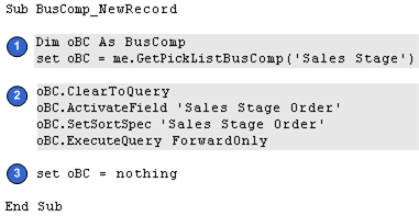

Example of Declaring an Object As a Siebel CRM Object Type
The following image includes an example that configures Siebel VB to access a Siebel object. You can declare an object as a Siebel CRM object type.
Explanation of Callouts
To declare an object as a Siebel CRM object type, you do the following work:
You create an object variable to access the code. This example uses as BusComp to declare the object. It does not use as Object. This example instantiates the business component (BusComp) Siebel object type. You could declare it as an object, but if you use the methods associated with the object type, then you must declare it as the appropriate object type.
You can use methods and properties to manipulate the objects.
Set oBC to nothing. It is recommended that you always set an object to nothing when your code instantiates it.

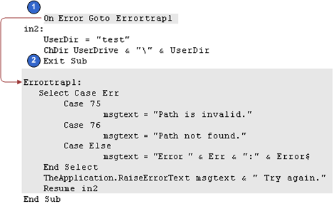

Using an Error Handler to Handle Siebel VB Errors
The following image includes an example that uses an error handler to handle errors.
The example that uses an error handler to handle errors includes the following items:
The On Error statement identifies the line of code that Siebel CRM runs if an error occurs. The code segment is part of the main code and it uses the Err statement to determine the error code that Siebel VB returns.
You precede the code with an Exit statement to make sure that it does not accidentally proceed to the error handler.

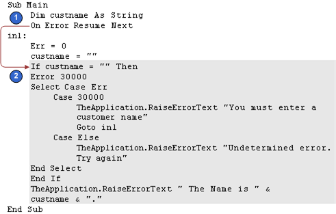

Handling Custom Errors
You can create a custom set of error codes to handle errors that are specific to your code. For example, you can create your own set of error codes if your Siebel VB code creates rules for file input but the user does not follow these rules. You can configure Siebel VB to create an error and reply appropriately using the same statements and functions that you use for error codes that Siebel VB returns.
Using the Body of the Code to Handle Custom Errors
The following image includes an example that uses the body of the code to handle a custom error.
The example that uses the body of the code to handle a custom error includes the following items:
Place the code that handles the error immediately before the line of code that could cause an error.
You use the Error statement to set the custom error to a value of 30000.
Using a Label to Handle Custom Errors
The following image includes an example that uses a label to handle a custom error.
The example that uses a label to handle a custom error includes the following items:
Use a labeled section of code to handle the custom error.
