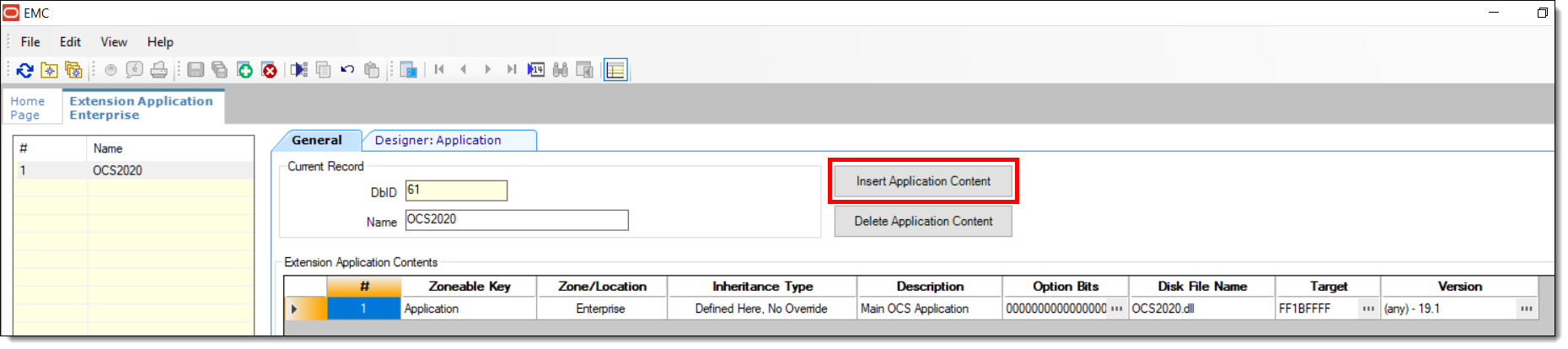

  4. From the General tab, click the Insert Application Content button.
    Figure 55-1 Extension Application Module
    This figure shows the EMC’s Extension Application module with the Insert Application Content button highlighted.

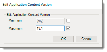

  11. Enter the appropriate Simphony Minimum / Maximum version information in the Version field. Click the ellipsis (…), and in this case, enter 19.1 in the Maximum field, select the checkbox adjacent to the maximum version number, and then click OK.
    Figure 55-2 Edit Application Content Version Window
    This figure shows the Extension Application minimum / maximum Simphony versioning configuration window.
