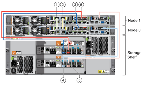

The following figure illustrates the cable connections between ports on Oracle Database Appliance X6-2-HA in a single storage shelf. The cables are color-coded. Match the colors of the labels at the ends of each cable with the colored line shown in the following illustration. Also match the cable colors to the background colors of the socket identification labels.
Table 3-1 Description of Callouts for Cabling Oracle Database Appliance X6-2-HA with a Single Storage Shelf
Callout Number Description
1
Green InfiniBand Cable
  • From: Node 0, PCIe slot 1, PORT2
  • To: Node 1, PCIe slot 1, PORT2
2
Yellow InfiniBand Cable
  • From: Node 0, PCIe slot 1, PORT1
  • To: Node 1, PCIe slot 1, PORT1
3
Dark blue SAS cable:
  • From: Node 0, PCIe slot 2, SAS0
  • To: Storage shelf, top I/O port 0
4
Light blue SAS cable:
  • From: Node 0, PCIe slot 3, SAS1
  • To: Storage shelf, bottom I/O port 0
5
Dark red SAS cable:
  • From: Node 1, PCIe slot 2, SAS1
  • To: Storage shelf, top I/O port 1
6
Light red SAS cable:
  • From: Node 1, PCIe slot 3, SAS0
  • To: Storage shelf, bottom I/O port 1

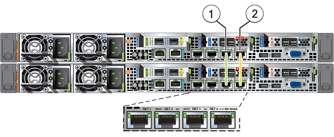

Cabling Oracle Database Appliance to Connect to Fiber Public Networks (Optional)
You can configure Oracle Database Appliance X6-2-HA to use 10GbE SFP+ (fiber) connections for the public network if you ordered the configuration that contains 10GbE SFP+ (fiber) cards instead of InfiniBand cards.
To use fiber connections between Oracle Database Appliance and your public network, you must cable the interconnect by using the green and yellow copper ports (onboard ports net0 and net1). The green and yellow Category 6 (Cat 6) interconnect cables for these ports ship with the base system.
The following describes how to connect the ports:
  • Plug the green Cat 6 cable into the onboard NET 1 port on each node, as shown in callout 1 in the figure.
  • Plug the yellow Cat 6 cable into the onboard NET 0 port on each node, as shown in callout 2 in the figure.

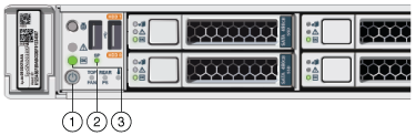

    The figure is an image of the front of the power panel, see the following callout table to identify the power button and the system initialization status indicator lights.
    Table 3-4 Description of Callouts for Powering On Oracle Database Appliance
    Callout Function
    1 Recessed On/Off power button, which is located on the front panel of the appliance. Push this button only once. Do not repeatedly push the power button.
    2 SP OK LED light, located on the front panel of the appliance.
    3 Green Power OK LED, located on the front panel. These lights must be in the steady ON position (Green light does not blink) before you log on to the system.
  3. Wait for Oracle Database Appliance to complete startup.
    Do not repeatedly push the power buttons. Startup can take several minutes to complete.
    Oracle Database Appliance is ready for use when the green Power OK LEDs (callout 3) on the front of the system remains steadily on.
