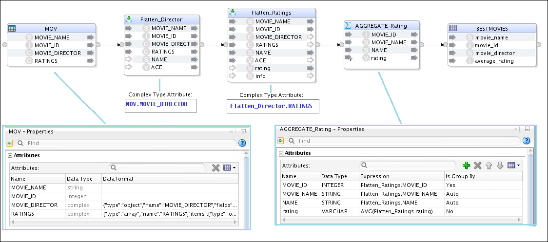

Consider the JSON snippet below which is a source with two Complex Types:
A MOVIE_DIRECTOR field which is a structure consisting of Name and Age.
A RATINGS field which is an array of ratings, with each rating comprising a rating and an info field.
{"MOVIE_ID":11,"MOVIE_NAME":"The Lobster","MOVIE_DIRECTOR":{"NAME":"Yorgos Lanthimos","AGE":43},"RATINGS":[{"rating":7,"info":"x"},{"rating":5,"info":"x"}]}
{"MOVIE_ID":12,"MOVIE_NAME":"Green Room","MOVIE_DIRECTOR":{"NAME":"Jeremy Saulnier","AGE":40},"RATINGS":[{"rating":4,"info":"x"},{"rating":3,"info":"x"}]}
{"MOVIE_ID":13,"MOVIE_NAME":"Louder Than Bombs","MOVIE_DIRECTOR":{"NAME":"Joachin Trier","AGE":42},"RATINGS":[{"rating":1,"info":"x"},{"rating":2,"info":"x"}]}
...The Hive table that is to be populated requires the NAME to be extracted from the MOVIE_DIRECTOR complex structure along with the average of the rating values from the RATINGS array.
To accomplish this, a mapping is required which flattens the
MOVIE_DIRECTOR field so that the NAME can be extracted.
RATINGS array so that the average of the individual ratings for each row can be calculated.
The mapping is as shown in the figure below.
Figure 9-1 Mapping to flatten Complex Types
Description of "Figure 9-1 Mapping to flatten Complex Types"

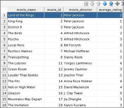

The populated Hive table appears as shown in the figure below.

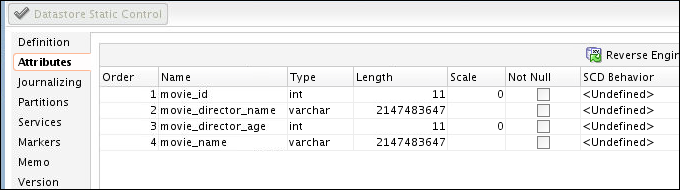

VALUES (8,'Trainspotting',('Danny Boyle',12),[1,4]);On reverse-engineering the movierating2 table in ODI, it appears as shown in the figure below.
Figure 9-3 Reverse-engineered movierating2 table
Description of "Figure 9-3 Reverse-engineered movierating2 table"

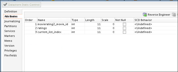

This table does not contain the ratings attribute. However, the JDBC driver exposes a virtual table called movierating2_ratings.
On reverse-engineering this virtual table in ODI, it appears as shown in the figure below.
Figure 9-4 Reverse-engineered movierating2_ratings table
Description of "Figure 9-4 Reverse-engineered movierating2_ratings table"
