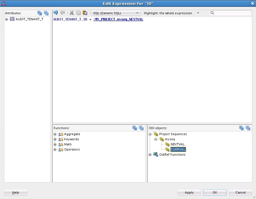

Sequence Enhancements
Sequence in Oracle Data Integrator is enhanced to support the CURRVAL operator. The expression editor now displays the NEXTVAL and CURRVAL operators for each sequence that is listed in the ODI objects panel as shown in Figure 11-1.
Before using current value for native sequences:
Confirm the technology supports native sequence. For example, MySQL does not support native sequence.
Configure the local sequence current value mask
Configure the remote sequence current value mask
Configure the sequence current value in non-binded mode
Figure 11-1 Expression editor enhancement: SEQUENCE
Description of "Figure 11-1 Expression editor enhancement: SEQUENCE"
