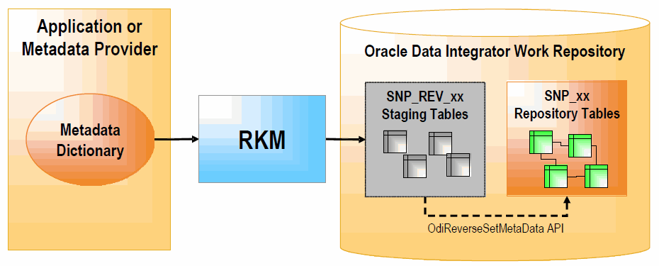

Reverse-Engineering Knowledge Modules (RKM)
The RKM role is to perform customized reverse engineering for a model. The RKM is in charge of connecting to the application or metadata provider then transforming and writing the resulting metadata into Oracle Data Integrator's repository. The metadata is written temporarily into the SNP_REV_xx tables. The RKM then calls the Oracle Data Integrator API to read from these tables and write to Oracle Data Integrator's metadata tables of the work repository in incremental update mode. This is illustrated below:
Figure 1-1 Reverse-engineering Knowledge Modules
Description of "Figure 1-1 Reverse-engineering Knowledge Modules"
A typical RKM follows these steps:
Cleans up the SNP_REV_xx tables from previous executions using the OdiReverseResetTable tool.
Retrieves sub models, datastores, attributes, unique keys, foreign keys, conditions from the metadata provider to SNP_REV_SUB_MODEL, SNP_REV_TABLE, SNP_REV_COL, SNP_REV_KEY, SNP_REV_KEY_COL, SNP_REV_JOIN, SNP_REV_JOIN_COL, SNP_REV_COND tables.
Updates the model in the work repository by calling the OdiReverseSetMetaData tool.

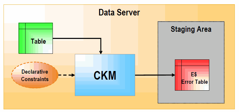

Check Knowledge Modules (CKM)
The CKM is in charge of checking that records of a data set are consistent with defined constraints. The CKM is used to maintain data integrity and participates in the overall data quality initiative. The CKM can be used in 2 ways:
To check the consistency of existing data. This can be done on any datastore or within mappings, by setting the STATIC_CONTROL option to "Yes". In the first case, the data checked is the data currently in the datastore. In the second case, data in the target datastore is checked after it is loaded.
To check consistency of the incoming data before loading the records to a target datastore. This is done by using the FLOW_CONTROL option. In this case, the CKM simulates the constraints of the target datastore on the resulting flow prior to writing to the target.
In summary: the CKM can check either an existing table or the temporary "I$" table created by an IKM.
The CKM accepts a set of constraints and the name of the table to check. It creates an "E$" error table which it writes all the rejected records to. The CKM can also remove the erroneous records from the checked result set.
The following figures show how a CKM operates in both STATIC_CONTROL and FLOW_CONTROL modes.

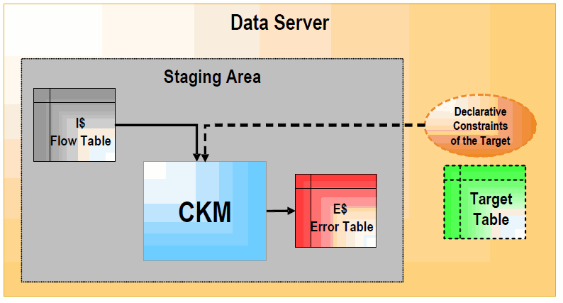

Figure 1-2 Check Knowledge Module (STATIC_CONTROL)
Description of "Figure 1-2 Check Knowledge Module (STATIC_CONTROL)"
In STATIC_CONTROL mode, the CKM reads the constraints of the table and checks them against the data of the table. Records that don't match the constraints are written to the "E$" error table in the staging area.
Figure 1-3 Check Knowledge Module (FLOW_CONTROL)
Description of "Figure 1-3 Check Knowledge Module (FLOW_CONTROL)"
In FLOW_CONTROL mode, the CKM reads the constraints of the target table of the Mapping. It checks these constraints against the data contained in the "I$" flow table of the staging area. Records that violate these constraints are written to the "E$" table of the staging area.
In both cases, a CKM usually performs the following tasks:
Create the "E$" error table on the staging area. The error table should contain the same columns as the attributes in the datastore as well as additional columns to trace error messages, check origin, check date etc.
Isolate the erroneous records in the "E$" table for each primary key, alternate key, foreign key, condition, mandatory column that needs to be checked.
If required, remove erroneous records from the table that has been checked.

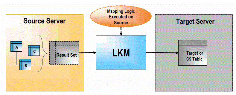

Loading Knowledge Modules (LKM)
An LKM is in charge of loading source data from a source server to a target server, which can be a staging area or the final target. It is used by mappings when some of the source datastores are not on the same data server as the staging or target server for those sources. The LKM implements the mapping component logic that need to be executed on the source server. It will either retrieve a single result set and load it into a “C$” staging table (LKM type = PERSISTENT), or it can set up some transparent access mechanism that allows the target server to access the source server data (LKM Type = TRANSPARENT_SOURCE), or set up a transparent access mechanism to allow the source server to directly access the target server and directly load the target datastores (LKM type = TRANSPARENT_TARGET).
The LKM creates the "C$" temporary table in the staging area. This table will hold records loaded from the source server.
The LKM obtains a set of pre-transformed records from the source server by executing the appropriate transformations on the source. For SQL-type LKMs, this is done by a single SQL SELECT query when the source server is an RDBMS. When the source doesn't have SQL capacities (such as flat files or applications), the LKM simply reads the source data with the appropriate method (read file or execute API).
The LKM loads the records into the "C$" table of the staging area.
When staging area is same as source, “C$” table is created in the target area.For an LKM of type TRANSPARENT_SOURCE:
The LKM creates a transparent access mechanism to allow the target server to access the source data
The LKM creates a code generation metadata object that stores the information about the sources and the source mapping logic, and passes this object to the target IKM.
For an LKM of type TRANSPARENT_TARGET:
The LKM creates a transparent access mechanism to allow the source server to access the target datastores.
The LKM loads the data directly into the target datastore, using the transparent access mechanism created in step 1.
A mapping may require several LKMs when it uses datastores from different sources. When all source datastores are on the same data server as the staging area, no LKM is required.

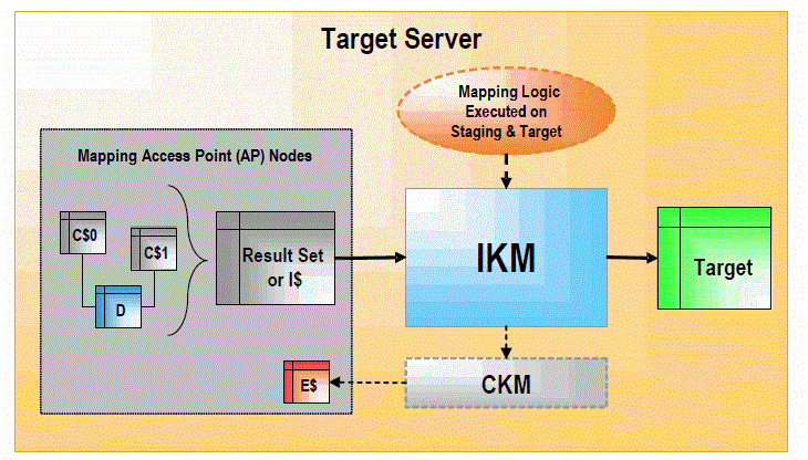

Figure 1-5 Integration Knowledge Module (Staging Area on Target)
Description of "Figure 1-5 Integration Knowledge Module (Staging Area on Target)"
When the staging area is on the target server, the IKM usually follows these steps:
The IKM executes a single set-oriented SELECT statement to carry out staging area and target declarative rules on all "C$" tables and local tables (such as D in the figure). This generates a result set.
Simple "append" IKMs directly write this result set into the target table. More complex IKMs create an "I$" table to store this result set.
If the data flow needs to be checked against target constraints, the IKM calls a CKM to isolate erroneous records and cleanse the "I$" table.
The IKM writes records from the "I$" table or the result set to the target following the defined strategy (incremental update, slowly changing dimension, etc.).
The IKM drops the "I$" temporary table.
Optionally, the IKM can call the CKM again to check the consistency of the target datastore.
These types of KMs do not manipulate data outside of the target server. Data processing is set-oriented for maximum efficiency when performing jobs on large volumes.

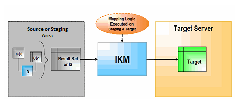

Figure 1-6 Integration Knowledge Module (Staging Area Different from Target)
Description of "Figure 1-6 Integration Knowledge Module (Staging Area Different from Target)"
When the staging area is different from the target server, as shown in Figure 1-6, the IKM usually follows these steps:
The IKM executes a single set-oriented SELECT statement to carry out declarative rules on all "C$" tables and tables located on the source or staging area (such as D in the figure). This generates a result set.
The IKM loads this result set into the target datastore, following the defined strategy (append or incremental update).
This architecture has certain limitations, such as:
A CKM cannot be used to perform a data integrity audit on the data being processed.
Data needs to be extracted from the staging area before being loaded to the target, which may lead to performance issues.

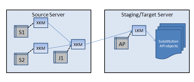

Extract Knowledge Modules (XKM)
The XKM is responsible for gathering and assembling the mapping logic for source and intermediate mapping components, and storing it in a set of code generation object known as an “Abstract Syntax Tree” or AST objects. The AST objects are tailored to generating executable code in some form.
Prior to the 12c release of ODI, each interface or mapping was assigned one LKM and one IKM, and possibly one CKM. Starting from ODI 12c, each component in a mapping physical design will have an assigned Component KM. A component KM can be an XKM, LKM, IKM, or CKM. An XKM is assigned to each source or intermediate node, an LKM is assigned to each AP node, and an IKM is assigned to each target datastore node. During code generation, the mapping code generator iterates through all the mapping component nodes, and each Component KM contributes some information to the final generated result code. Each Component KM has an associated delegate script, that is implemented as an ODI internal java class or by a groovy script. The delegate script for each KM is used to generate a java AST object. The generated AST object is then passed as an input parameter to the next node’s KM delegate class. When an LKM for an AP node or an IKM for a target node is reached, a combined AST tree is produced, which includes all the AST objects produced by all the upstream nodes. The AST tree can then be used as a substitution API object to substitute values into the LKM or IKM task line commands.
The following diagram shows the code generation process including the contribution by XKMs:
Figure 1-7 Extract Knowledge Modules (XKM)
Description of "Figure 1-7 Extract Knowledge Modules (XKM)"
The XKM typically does not generate any session steps of its own. Its main function is to provide java AST object instances to the downstream Component KMs.

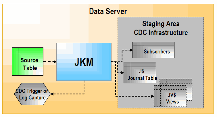

Journalizing Knowledge Modules (JKM)
JKMs create the infrastructure for Change Data Capture on a model, a sub model or a datastore. JKMs are not used in mappings, but rather within a model to define how the CDC infrastructure is initialized. This infrastructure is composed of a subscribers table, a table of changes, views on this table and one or more triggers or log capture programs as illustrated below.
