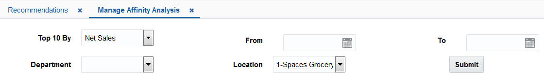

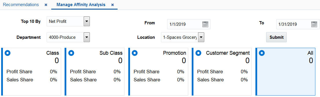

Regardless of which screen you are viewing, a set of global prompts determines the data displayed throughout the application.
On first accessing the application, you make selections from the prompts and click on the Submit button, which will load the remaining application screens based on your selections. Modifying and submitting the prompt values after that time will refresh the screens with new data.
Table 8-1 AA Global Prompts
Prompt Name Description
Top 10 By
Select the primary metric used to rank the market basket results in all places where affinity rules are displayed.
Fiscal Week From
Select the starting week from which results must be displayed. The values displayed are the week of the Fiscal Calendar.
To
Select the ending week that results must be displayed for.
Department
Select the department from the merchandise hierarchy that results must be displayed for. All of the classes or subclasses on the THEN side of an affinity rule will be from the selected Department.
Location
Select the location from the location hierarchy that results should be displayed for.
The Top 10 By prompt allows you to select from the following metrics, which are used to determine which affinity rules are displayed and how to sort the results that are shown.
Table 8-2 Top 10 By Options
Metric Name Description
Net Sales
Chooses the top N rules in each screen, based on the net sales retail amount (e.g., Avg Sales from If Items)
Net Quantity
Chooses the top N rules in each screen, based on the net sales quantity (e.g., Avg Sales Quantity from If Items)
Net Profit
Chooses the top N rules in each screen, based on the net sales profit (e.g., Avg Profit from If Items)
Although this prompt indicates "Top 10", you have the ability to select more than 10 results by changing the Top selection in the Market Basket Filters area of the screen, as discussed later in this chapter.
The Fiscal Week From and To prompts allow you to select a range of dates for which the results are returned. Market basket affinity rules may change over time as new sales transactions are processed, so selecting the weeks to review ensures that only the rules that are applicable for that period of time are displayed.
The Department prompt displays a list of departments from the merchandise hierarchy. Selecting a department will limit the data in all screens such that the consequent (or THEN components) of an affinity rule will be from that department.
After all selections are made and the Submit button is clicked, the interface will refresh and display results. Each section of the application is organized under an informational tile that describes the purpose of the screen, along with summarization metrics.

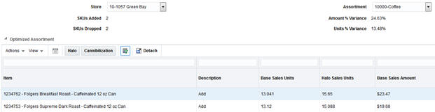

The first step in using the assortment recommender screen is to select a store and assortment to review. The stores listed in the drop-down menu are limited to those stores that have completed an assortment recommendation calculation for the selected department in the selected period. The assortment drop-down menu is limited to those assortments with a completed assortment recommendation calculation for the date range, department, and location previously selected, and align with the level of the product hierarchy that assortment-planning operations occur at. For example, if we process Coffee on Week 1, Yogurt on Week 2, and Milk on Week 3, and we pick a date range of Weeks 1-3 in the global prompts, we will show results for those three categories.
After selecting a store and an assortment, the screen displays data showing the system-optimized product list and the original product list, along with several summary metrics.
Table 8-5 Assortment Optimization Summary Metrics
Field Name Description
SKUs Added
The number of SKUs added to the assortment by the optimization process.
SKUs Dropped
The number of SKUs removed from the assortment by the optimization process.
Amount % Variance
The change in sales retail amount for the assortment after SKUs are added and dropped by the optimization, based on average weekly sales.
Units % Variance
The change in sales units for the assortment after SKUs are added and dropped by the optimization, based on average weekly sales.
Table 8-6 lists the summary metrics that the optimized assortment table displays insights into expected product performance if the recommendations are applied to your assortment.
Table 8-6 Optimized Assortment Table
Item
The item number and description of the SKU in the assortment.
Description
The recommended change for a SKU in the assortment. This may either be to keep an existing SKU or add a SKU that was not previously in the assortment.
Base Sales Units
The average weekly sales units of the SKU at the selected location.
Halo Sales Units
The average weekly sales units of the SKU at the selected location, after adjusting for demand as a result of Halo sales due to market basket affinity rules involving the SKU.
Base Sales Amount
The average weekly sales amount of the SKU at the selected location.
Halo Sales Amount
The average weekly sales amount of the SKU at the selected location, after adjusting for demand as a result of Halo sales due to market basket affinity rules involving the SKU.
Base Sales Profit Amount
The average weekly sales profit of the SKU at the selected location.
Halo Sales Profit Amount
The average weekly sales profit of the SKU at the selected location, after adjusting for demand as a result of Halo sales due to market basket affinity rules involving the SKU.
Incremental Demand
The number of sales units of the SKU that do not transfer to any other SKU in the assortment if it were to be deleted from the assortment.
Substitutable Demand
The number of sales units of the SKU that can transfer to other SKUs in the assortment if it were to be deleted from the assortment.

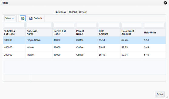

If you want to analyze the recommendations further, the system provides pop-up windows displaying Halo and Cannibalization effects relating to the selected item from the Optimized Assortment table. Select a row in the table, and then click the Halo or Cannibalization buttons on the task bar to review the data.
Figure 8-3 Halo Effects Pop-Up
Description of Figure 8-3 follows
Description of ''Figure 8-3 Halo Effects Pop-Up''
Table 8-7 Halo Effects
Subclass Ext Code
The numeric identifier for a subclass with a halo effect from the SKU.
Subclass Name
The descriptive name for a subclass with a halo effect from the SKU.
Parent Ext Code
The numeric identifier of the parent class for a subclass.
Parent Name
The descriptive name for the parent class for a subclass.
Halo Amount
The calculated halo effect on the subclass's sales amount.
Halo Profit Amount
The calculated halo effect on the subclass's sales profit.
Halo Units
The calculated halo effect on the subclass's sales units.
The Halo pop-up window provides insights into the secondary effect of a SKU on other products. Products with strong market basket affinities may generate large halo effects and thus be good candidates for your assortment.

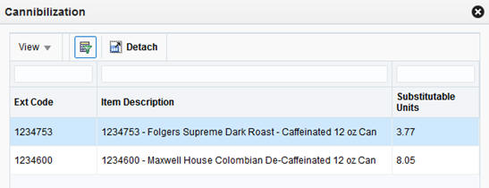

Figure 8-4 Cannibalization Effect Pop-Up
Description of Figure 8-4 follows
Description of ''Figure 8-4 Cannibalization Effect Pop-Up''
Table 8-8 Cannibalization Effects
Ext Code
The numeric identifier for a SKU that is cannibalized by the selected assortment SKU.
Item Description
The descriptive value for the SKU.
Substitutable Units
The calculated number of sales units that can be cannibalized from other SKUs when the assortment SKU is added, or the number of units transferred to these SKUs when the assortment SKU is dropped.

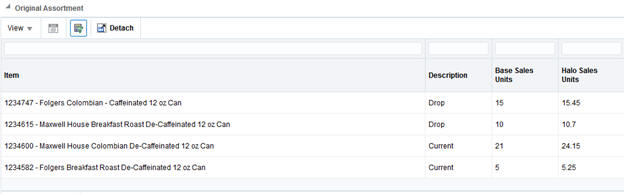

At the bottom of the screen, you can also see the original assortment, along with any SKUs from the assortment that have been dropped in the recommendation.
Figure 8-5 Original Assortment
Description of Figure 8-5 follows
Description of ''Figure 8-5 Original Assortment''
Table 8-9 Original Assortment
Item
Description
The recommended change for a SKU in the assortment. This may either be to keep an existing SKU or drop a SKU that was in the assortment.
Base Sales Units
Halo Sales Units
Base Sales Amount
Halo Sales Amount

There are five screens available for viewing the AA results, each containing a different subset of affinity rules with certain characteristics as described below.
Table 8-10 Market Basket
Class
Displays market basket affinities between different classes, without any consideration for whether the items were on promotion or not.
Subclass
Displays market basket affinities between different subclasses, without any consideration for whether the items were on promotion or not.
Promotion
Displays market basket affinities between different subclasses when the antecedent (if) components are promoted and the consequent (then) components are not promoted.
Customer Segment
Displays market basket affinities between different subclasses when the antecedent (if) components are promoted and the consequent (then) components are not promoted, further separated by customer segments.
All
Displays a searchable list of all available affinity rules for all types.
After you select one of the five info tiles at the top of the screen, you will be presented with additional filter prompts and a data table for displaying results.

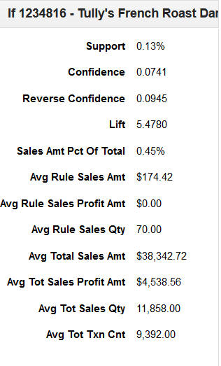

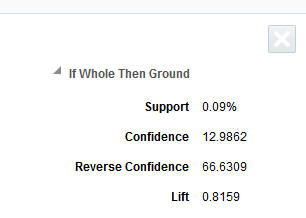

Table 8-13 Market Basket Affinity Details
Support
The percent of market baskets that contain items from the IF and THEN components of the rule.
Written as a formula: Rule Transaction Count/Total Transaction Count
Confidence
The ratio of the number of transactions where the entire rule is present, compared to all transactions containing IF items.
Written as a formula: Rule Transaction Count/Total IF Transaction Count
Reverse Confidence
The ratio of the number of transactions where the entire rule is present, compared to all transactions containing THEN items. If a rule has a higher Reverse Confidence than its own Confidence value, then it indicates that the rule is better represented by the reversal of the IF and THEN components.
Written as a formula: Rule Transaction Count / Total THEN Transaction Count
Lift
A statistical measure of how strong the product affinity is, as compared to random chance for the rule (higher is better).
Written as a formula: Rule Transaction Count * Total Transaction Count / Total IF Transaction Count/Total THEN Transaction Count
Sales Amt Pct Of Total
The percent of total sales retail amount that the rule represents.
Written as a formula: Rule Sales Amount/Average Weekly Total Sales
Avg Rule Sales Amt
The average weekly sales retail amount across all transactions containing the rule.
Avg Rule Sales Profit Amt
The average weekly sales profit across all transactions containing the rule.
Avg Rule Sales Qty
The average weekly sales units across all transactions containing the rule.
Avg Total Sales Amt
The average weekly sales retail amount across all transactions.
Avg Tot Sales Profit Amt
The average weekly sales profit across all transactions.
Avg Tot Sales Qty
The average weekly sales units across all transactions.
Avg Tot Txn Cnt
The average weekly transaction count across all transactions.
The detailed metrics for a rule provide more ways to evaluate if the rule is going to be useful for your business purpose. For example, a rule that has both high support and high confidence represents a strong product affinity that is purchased by many of your customers. Any action taken on the categories in such a rule, such as promoting a subclass on the IF side of the rule, can have significant benefits for the THEN components of the rule. Another way to use these metrics is to consider the average sales or profit that a rule brings in relative to total sales over the same period. Rules that represent a significant profit amount may be a more valuable target for your efforts than rules with lower profitability.

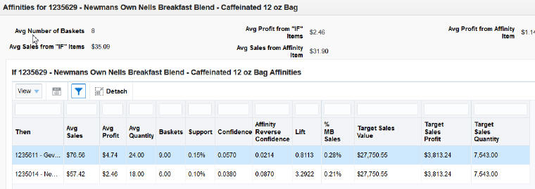

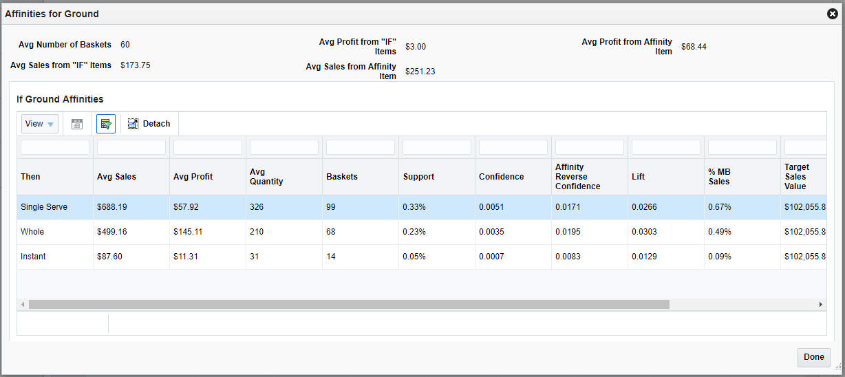

Another way to view the market basket affinities is to click the button found to the left of each row in the data table. This button displays a pop-up window with all of the product affinities that have been found for the IF components of the rule. This can be especially useful when your goal is to find any relationships with a specific product category, rather than seeing all of the relationships between different products.
Figure 8-9 Targeted Product Affinities Pop-Up
Description of Figure 8-9 follows
Description of ''Figure 8-9 Targeted Product Affinities Pop-Up''
This screen is split into two main sections: the top section displays summary metrics for all rules associated with the IF components, and the bottom section displays all of the product affinities found for the IF components and a selection of detailed metrics for them.
Table 8-14 Targeted Product Affinities Summary Metrics
Avg Number of Baskets
The average number of baskets found on a rule containing the IF items.
Avg Sales from IF Items
The average sales retail amount for the IF items in the rules.
Avg Profit from IF Items
The average sales profit for the IF items in the rules.
Avg Sales from Affinity Item
The average sales retail amount for the THEN items in the rules.
Avg Profit from Affinity Item
The average sales profit for the THEN items in the rules.
Table 8-15 Targeted Product Affinities Detail Metrics
Then
Displays the class or subclass that was found to have an affinity with the IF components of the market basket rule.
Avg Sales
The average weekly sales retail amount for the IF and THEN items in the rules.
Avg Profit
The average weekly sales profit for the IF and THEN items in the rules.
Avg Quantity
The average weekly sales units for the IF and THEN items in the rules.
Baskets
The number of market baskets that contain items from the IF and THEN components of the rule.
Support
Confidence
Affinity Reverse Confidence
Lift
% MB Sales
Target Sales Value
The average weekly total sales retail amount across all transactions in the selected periods.
Target Profit
The average weekly total sales profit across all transactions in the selected periods.
Target Sales Quantity
The average weekly total sales units across all transactions in the selected periods.
This view of market basket affinities provides powerful insight into the relationships between different product categories, as it may expose affinities even between seemingly unrelated categories that your customers tend to purchase together. This screen allows you to see how actions taken on the target (IF) products will impact other areas within your business. For example, any action taken to increase the sales of an IF category can lift the sales of all other products with a strong affinity to those items. Conversely, if you have a category that is performing poorly on the THEN side of a rule, you may be able to take action on the IF products to boost that category's sales indirectly.

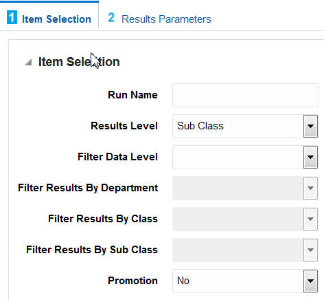

This section addresses MBI analysis. The functionality described here includes creating custom runs and comparing the results of multiple runs.
System runs are executed automatically once a week as part of the weekly batch cycle using settings that have been configured for a specific level of the location hierarchy. Since system runs occur weekly they can be used to examine results over a long period of time.
User runs can be run at any time by an individual user who specifies the settings for the run.

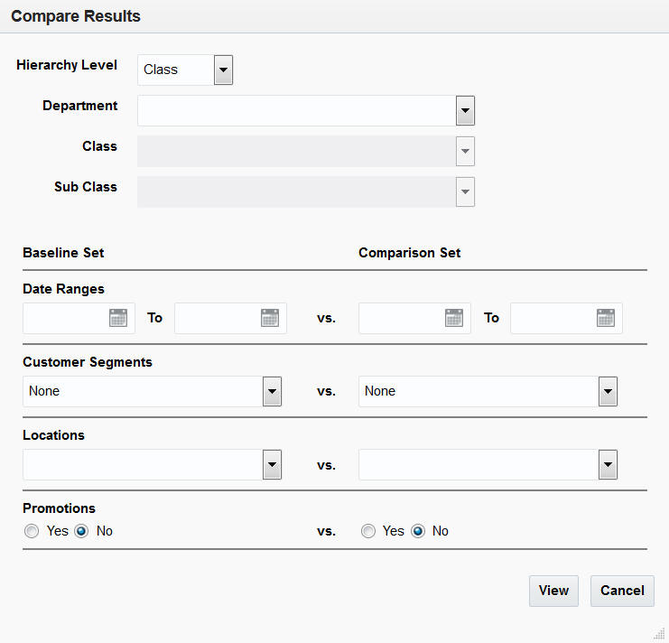

Two types of comparison are available: Compare Runs and Compare Results.
Use Compare Runs to select specific runs to compare. This comparison is useful for straightforward runs such as comparing the results of two different months.
Use Compare Results to compare system runs only, with specified dates and other filters. In this case, take care in selecting runs that overlap, as some runs may be represented in the results more than once.

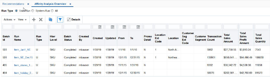

Affinity Analysis Overview

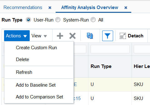

The Affinity Analysis Overview screen provides the tools shown in Figure 8-10. In addition to the standard application functionality, you can also
  • Select from the following functionality using the Action drop-down menu:
    • Create Custom run
    • Delete
    • Refresh
    • Add to Baseline Set
    • Add to Comparison Set
  • Select the type of run to view in this screen: User-Run, System-Run, or all runs.
Figure 8-10 Affinity Analysis Overview Functionality
Description of Figure 8-10 follows
Description of ''Figure 8-10 Affinity Analysis Overview Functionality''
The Affinity Analysis Overview table, shown in Figure 8-11, displays the list of completed runs and contains the following fields.
Figure 8-11 Affinity Analysis Overview Table
Description of Figure 8-11 follows
Description of ''Figure 8-11 Affinity Analysis Overview Table''

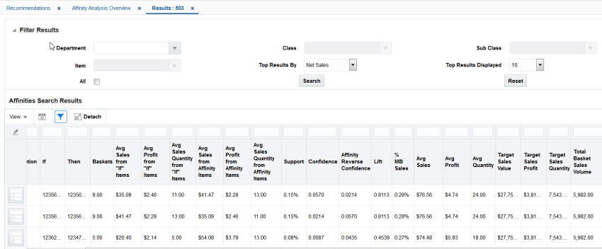

When you click on a specific Run Name, you see a pop-up that displays Filter Results and Affinities Search Results.
Filter Results
Figure 8-12 shows the Filter Results and Affinities Search Results, which are displayed when you click on a specific Run Name. The fields are described in Table 8-17 and Table 8-18. Use the Search button to initiate the filtering process and use the Reset button to clear the filter fields.
Figure 8-12 Filter Results and Affinities Search Results Table
Description of Figure 8-12 follows
Description of ''Figure 8-12 Filter Results and Affinities Search Results Table''
Table 8-17describes the options you can use to filter the results that will be displayed.
Table 8-17 Filter Results
Field Description
Department
Select one or more departments for which the results should be filtered.
Item
Select the item within the department from the drop-down list.
All
Select to prevent any other filters from being used.
Class
Select one or more classes for which the results should be filtered.
Top Results By
Select a metric to see the top results by: Net Sales, Net Quantity, of Net Profit.
Sub Class
Select one or more subclasses for which the results should be filtered.
Top Results Displayed
Select a value (10, 20, 30...970, 980) to limit the number of results displayed.
The Affinities Search Results section of the pop-up provides details about the observed associations (affinities) between sales transactions. It is expressed as "If a customer buys X, then that customer may also buy Y." The table describes the relevant values associated with the If/Then transactions and contains the following fields:
Table 8-18 Affinities Search Results
Field Description
Customer Segment
(Customer Segment screen only) Displays the customer segment for which the product affinity was found.
Promotion
(All affinities screen only) Displays whether the rule represents IF components that were on promotion.
If
Displays the classes or subclasses containing items that were purchased in the market baskets for a given product affinity. All market baskets that contributed to a rule will contain items from these product categories.
Then
Baskets
The number of market baskets that contain items from both the IF and THEN components of the rule.
Avg Sales from "If" Items
The average sales retail amount from items belonging to the IF classes or subclasses.
Avg Profit from "If" Items
The average sales profit from items belonging to the IF classes or subclasses.
Avg Sales Quantity from "If" Items
The average sales units from items belonging to the IF classes or subclasses.
Avg Sales from Affinity Items
The average sales retail amount from items belonging to the THEN class or subclass.
Avg Profit from Affinity Items
The average sales profit from items belonging to the THEN class or subclass.
Avg Sales Quantity from Affinity Items
The average sales units from items belonging to the THEN class or subclass.
Support
Confidence
Lift
% MB Sales
Avg Sales
Avg Profit
Avg Quantity
Target Sales Value
Target Sales Profit
Total Basket Sales Volume
Results Pop-up
Click the right-hand icon for a specific row in the Results table to see If/Then Affinities for...pop-up. The pop-up shows all the other rules that have been discovered for the same If item. You can use this to compare the rules. In this way, you may discover another product with a stronger affinity for the item.
The pop-up has the following fields.
Table 8-19 Affinities For
Field Description
The average number of baskets across the runs for the combination of the If and Then items.
The average sales retail amount from item belonging to the THEN class or subclass.
Then
Avg Sales
Avg Profit
Avg Quantity
Baskets
Support
Confidence
Lift
% MB Sales
Target Sales Value
Target Sales Profit

Compare Results
To compare results, select the two runs you want to compare. Highlight one run and click Add to Baseline Set. Highlight the second run and click Add to Comparison Set. You see these selections in the Compare Results right panel.
Figure 8-17 Panel Showing Run Selection
Description of Figure 8-17 follows
Description of ''Figure 8-17 Panel Showing Run Selection''
Click View to see the comparison. the View Results pop-up displays, which can be filtered by a combination of Department Item, Class, Top Results By, Subclass, and Top Results Displayed.
The results are displayed as a pair of rows for each item, a baseline row followed by a comparison row.

Create Custom Run
To create a custom run, select Create Custom Run from the Action drop-down. You see the Create Custom Run pop-up with two pages - Item Selection and Results Parameters. Need more info about recommendations to create a run.
Use the Item Selection page to select the items to include in the results, including the level of the results and the hierarchy nodes to include.
Provide a meaningful name for the Run Name that can help identify the run.
The Results Level defines the level of the hierarchy that the data is created for. Lower levels can required lower thresholds on the Results Parameters page (in order to find results), while higher levels can include too many results if the settings are not increased on the Results Parameters page.
The Filter Data Level is used to define rules regarding how to filter data. For example, if the results are only required for specific departments, then select Departments as the level and then select the departments.
A Promotion value of Yes only includes results in which the If component was on a promotion. A value of No is used when there is no concern about whether a promotion was present or not.
After entering item criteria, click Add Item Selection. The bottom section of the screen is populated with the results of the selection. You can also see this information in the right panel.
Figure 8-18 Item Selection Tab
Description of Figure 8-18 follows
Description of ''Figure 8-18 Item Selection Tab''

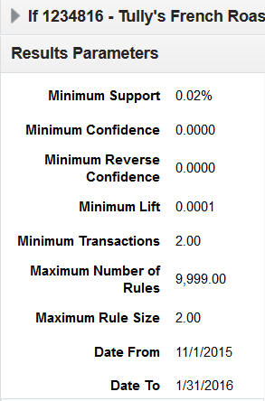

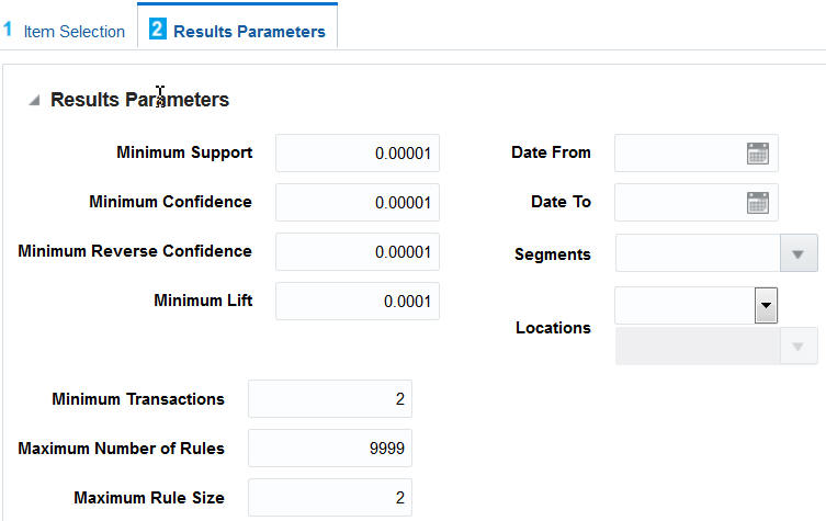

The Results Parameters page, which is shown in Figure 8-19, is displayed in the right panel. The minimum value for transactions are used to prevent a situation in which there are too many results because so many transactions have been used in the calculations.
Figure 8-19 Results Parameters Tab
Description of Figure 8-19 follows
Description of ''Figure 8-19 Results Parameters Tab''
Table 8-21 explains how to interpret these values.
Table 8-21 Results Parameters
Field Description
Minimum Support
The minimum percent of total transactions required to have this rule expressed as a decimal value. (0 - 1 range)
Minimum Confidence
The minimum confidence ratio required for a rule expressed as a decimal value. (0 - 1 range)
Minimum Reverse Confidence
The minimum confidence ratio required for the reverse rule definition, expressed as a decimal value. (0 - 1 range)
Minimum Lift
The minimum lift value required for a rule.
Minimum Transactions
The minimum value for transactions are used to prevent a situation in which there are too many results because too many transactions have been used in the calculations. This value also helps ensure some consistency if the transaction volume varies enough for Minimum Support to be used.
Maximum Number of Rules
The limit on the top number of rules to be saved from the results. Used to reduce data volume and remove the less significant rules.
Maximum Rule Size
The number of components to be included in a rule. The value of 2 is only supported for rules that include promotion or item results; otherwise, the value of 3 is supported. The additional components are always on the If side of the rule.
Dates From and To
The date range for processing sales data. This value must not span an excessive length of time, as the amount of data processed can become too large to manage reasonably.
Segments
Select any customer segments that should be included when determining the sales transactions to process.
Location
Limit the locations that should be included when determining the sales transactions to process. This can be done by selecting any hierarchy level and then multi-selecting any locations at that level.
Manage Affinity Analysis
Use the Manage Affinity Analysis screen to view the results from all system created runs. Set the filters, select a range of calendar dates, and click Submit. The Info Tiles are displayed.
Figure 8-20 Manage Affinity Analysis Filters
Description of Figure 8-20 follows
Description of ''Figure 8-20 Manage Affinity Analysis Filters''
Info Tiles
The Info Tiles display the results from all system runs. Once you specify the filters to indicate what runs you want to use, the Info tiles display an aggregate view of the results for different hierarchy levels and the types of processing that were executed during the run. Select an Info Tile and use the filters below the tiles to view the affinities for your selection.
Each tile has specific filters. Here is an example of the filters for the All tile.
Figure 8-22 All Info Tile Filters
Description of Figure 8-22 follows
Description of ''Figure 8-22 All Info Tile Filters''
Compare Results
You can use Compare Results to compare system runs only, using the dates and filters you specify, as shown in Figure 8-23.
Click View. Table 8-20 describes the results of the Compare Results functionality.
