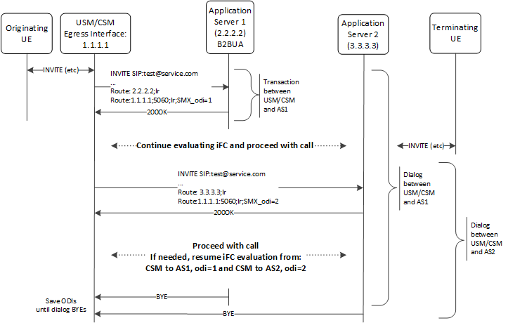

The diagram below illustrates the OCCSM iFC evaluation behavior when you enable this parameter. By default, the OCCSM removes the ODI after the transaction between the OCCSM and AS1 is complete. With the preserve-odi parameter enabled, however, the OCCSM retains the ODI until it receives the BYE from AS1, which terminates the dialog between the OCCSM and AS1. If there are ODIs tracking service with other AS servers, shown below as AS2, the OCCSM retains those until the dialogs between itself and those servers terminates.
Given the diagram above, assume that the originating UE issues an invite towards the IMS core, which includes AS1 performing originating services and AS2 performing terminating services. The OCCSM initiates the iFC process with AS1, resulting in multiple transactions including the exchange of INVITEs using odi=1. When configured with preserve-odi, the OCCSM retains the service profile beyond the initial transaction. The OCCSM proceeds with terminating services via AS2, resulting in a similar set of transactions. In the meantime, the sequence has contacted the terminating UE. The sequence proceeds with completing the INVITE to 200OK interactions with AS1, AS2 and the terminating UE. The session proceeds until a UE issues a BYE to end the session. Subsequently, the process issues BYEs to terminate the dialogs with AS1 and AS2, at which time the OCCSM deletes those service profiles.
There are a large number of messages omitted from the diagram above for brevity and to highlight the dialogs between the OCCSM and the ASs.
